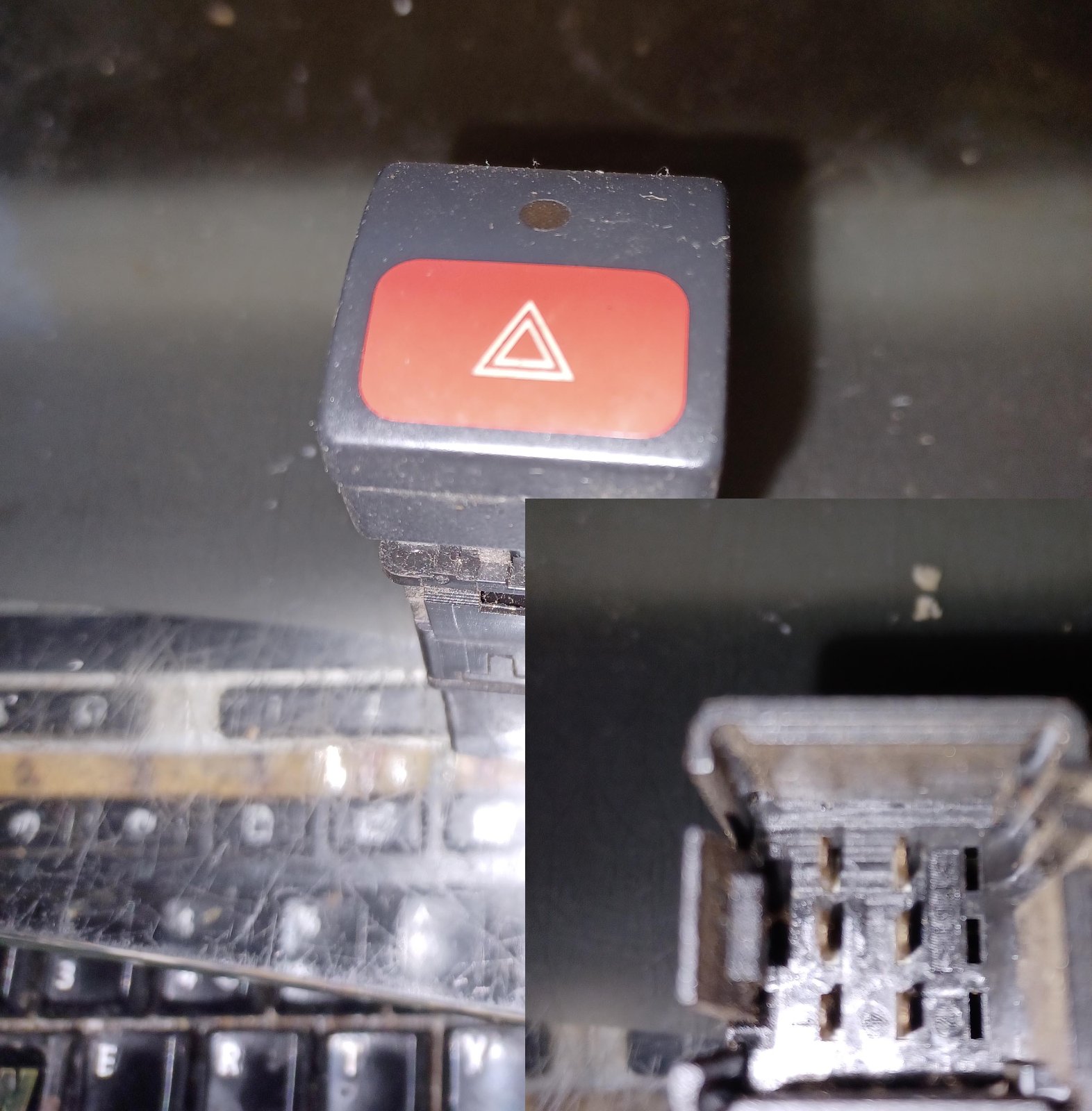

Thanks guys, nothing worked so I opened the switch. Bit of analysis showed that the hold on and release mechanism is a small metall tongue with a tiny stud on the end to engage with a groove in a plastic moulding. This tiny, and I mean tiny, tip broke off. So the switch is truly kaput. I have a spare from my Mk1 but naturally this has only 8 pins to the Mk2's 9 pins. Wonder what the 9th pin is for? Anyway I'll search for another or try to find a way of connecting my 8 pin switch so it works. Any insights very welcome.

I think that I have a spare switch, but it is more likely to be S1. Maybe someone else has a spare S2 switch.

There is a good chance I have a spare one in my box of "Switches & Electrical Bits".....
Edit..... I do, however it is a 6 pin ??.....(defo a s.2 car source)
