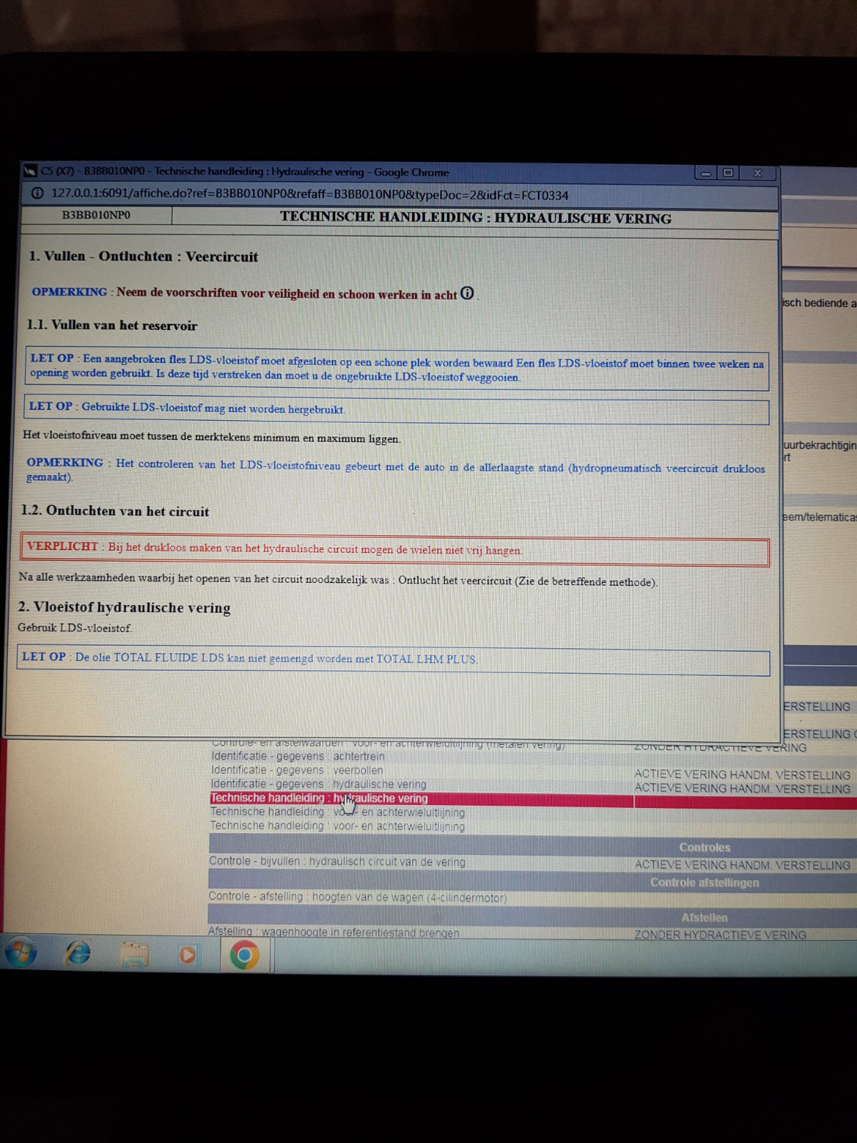

Here is a screenshot, the red part says, don't leave the wheels hanging loose from the ground.

Thank you for reply and the effort I really appreciate it and I will pursue the good advice. The question is how do I correct the problem of having removed the pressure while the wheels were hanging freely, can I do it with the Diagbox? It won't rise when I put it on high even if I leave it for some time, maybe because the pump runs a round for 1 minute time and then stops (I mean that's how they are programmed for to spare the pump.)
