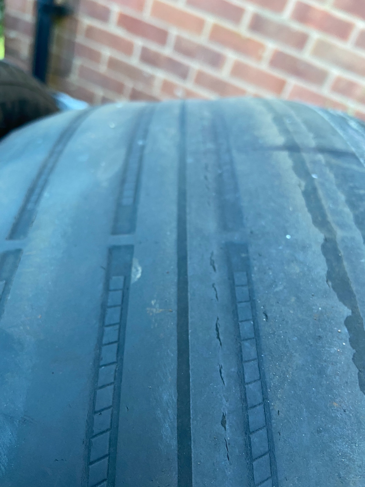

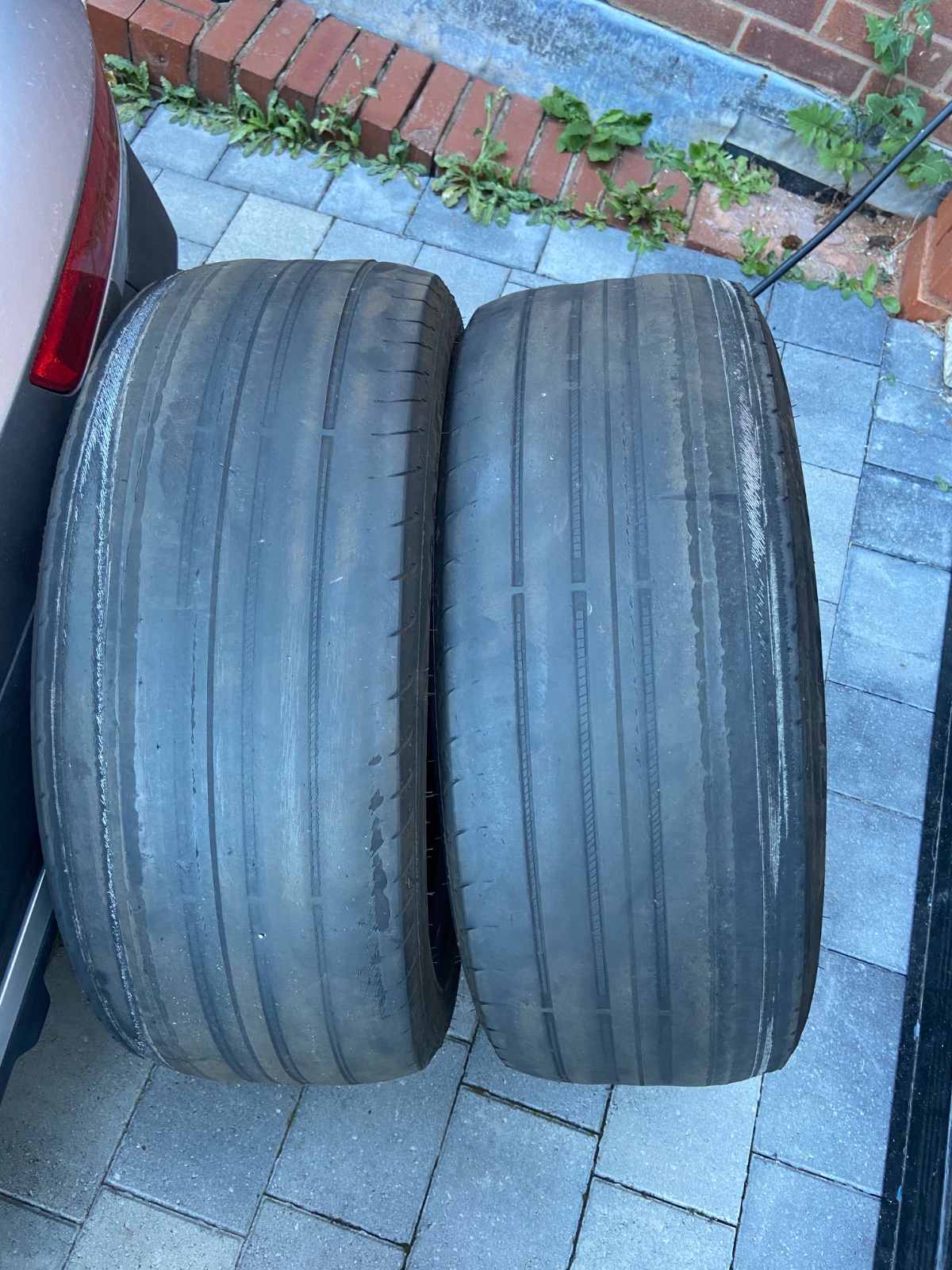

We have two DS7 eTense Ultra Prestige ( so 20” rims ), is anyone else with a similar vehicle experiencing severe rear tyre wear?
We found this article which seems to suggest vehicles with 19” rims are affected but nothing concrete.
https://yrtnews.com/premature-tire-wear ... k-e-tense/
Pictures of my tyres after after 9350 miles attached.
Posting this more really as a heads up to other eTense drivers as we are being supported by our DS Salon and the issue is being investigated.
Our other vehicle has done 4000 miles but is heading the same way, so the issue isn’t isolated to one vehicle.

Crickey! Those are bad and on 2 separate vehicles smacks of a fault in the suspension geometry or a bad batch of tyres if the same make and type. Incidentally what is the tyre brand and model and are they the same tyres on both vehicles?
I don't have a DS7, but the Bridgestone Turanza tyres on my Aircross are disintegrating on the outer edge - the rubber is forming cracks and starting on the rears too at 10K. I'm having them taken off and Michelins put on tomorrow. But nothing like the damage on yours - they look as if a boy racer has had the car at Silverstone for a week!

They are Goodyear F1 Eagle, yes the same on both cars.
