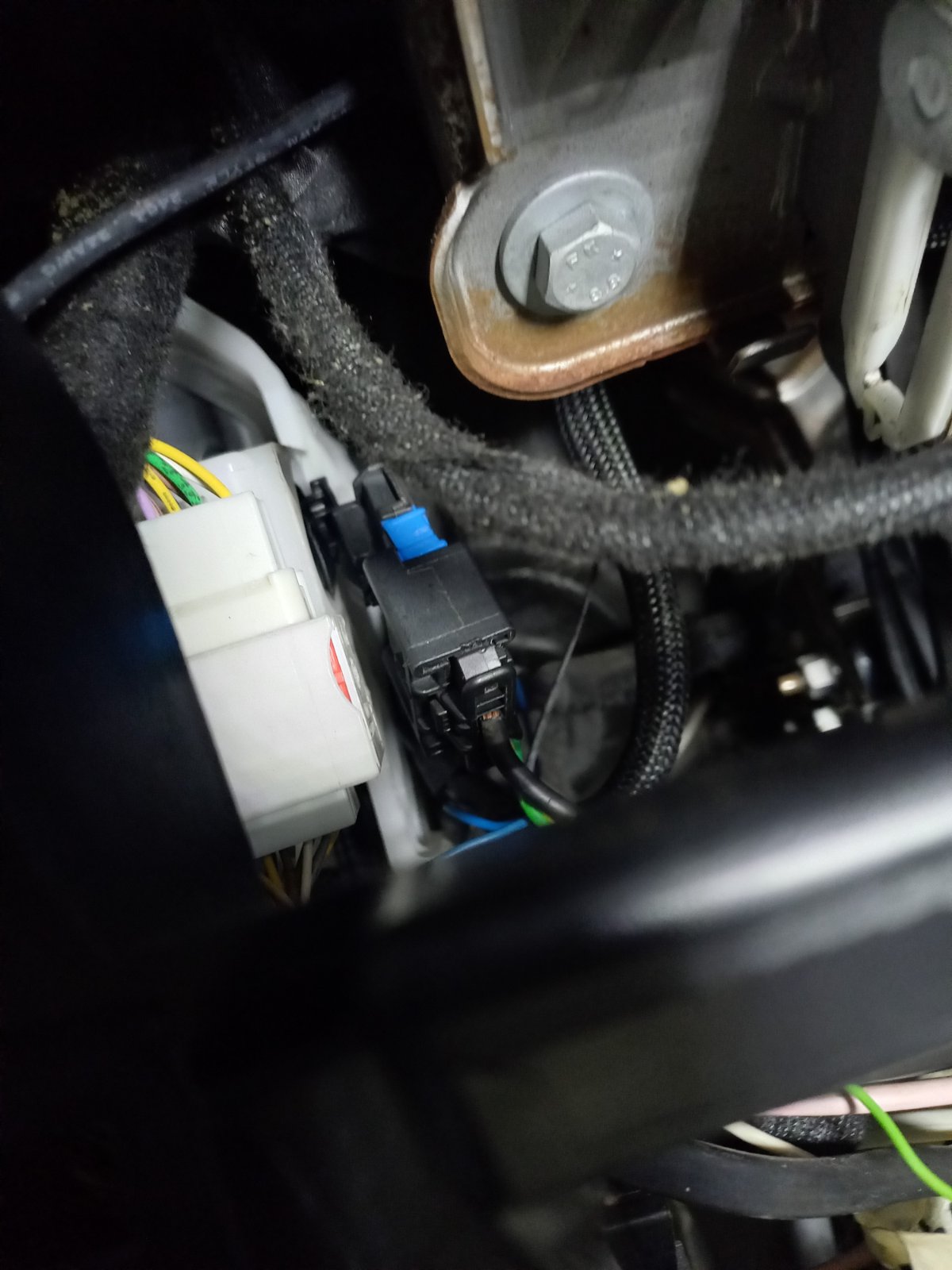

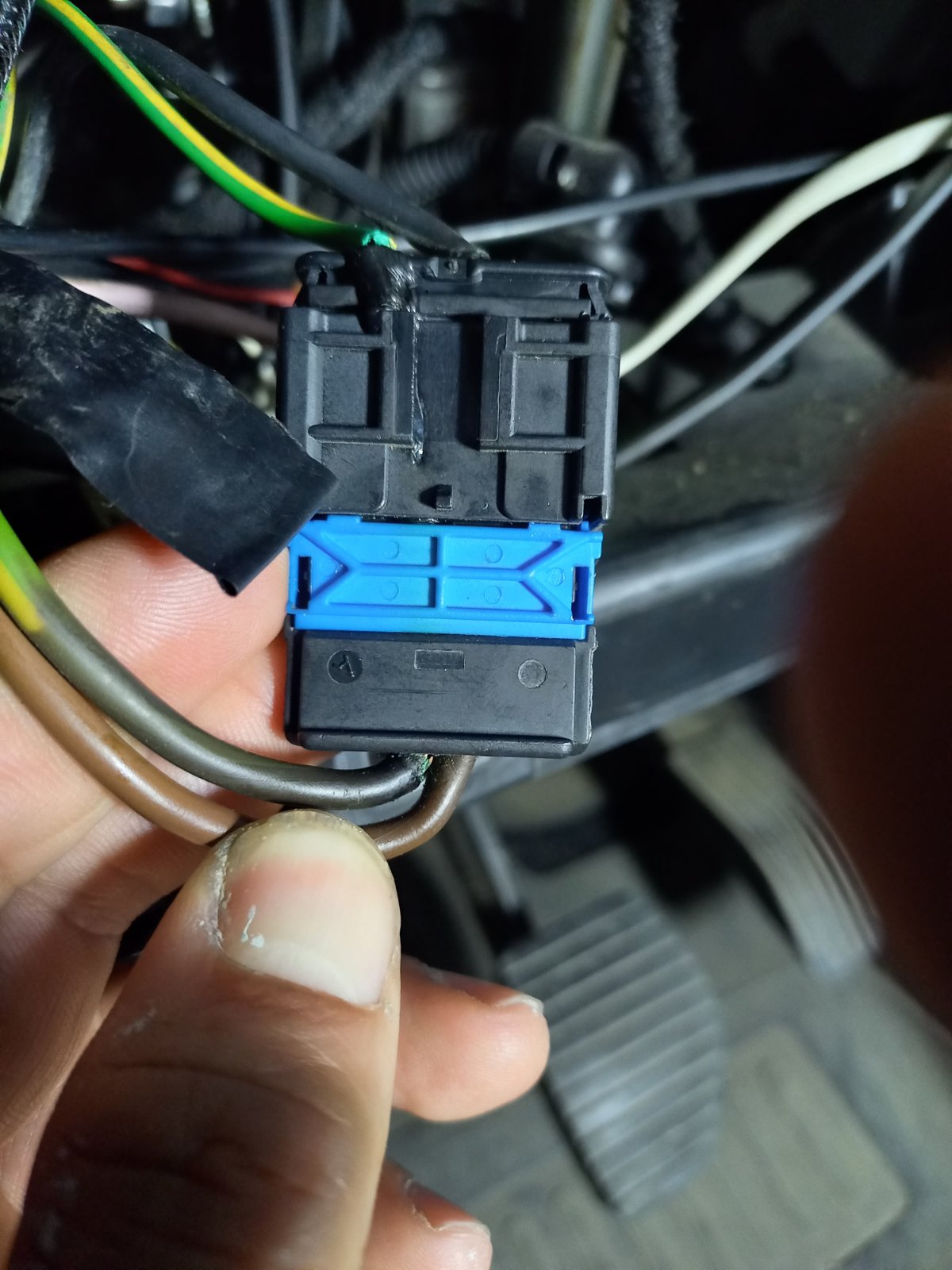

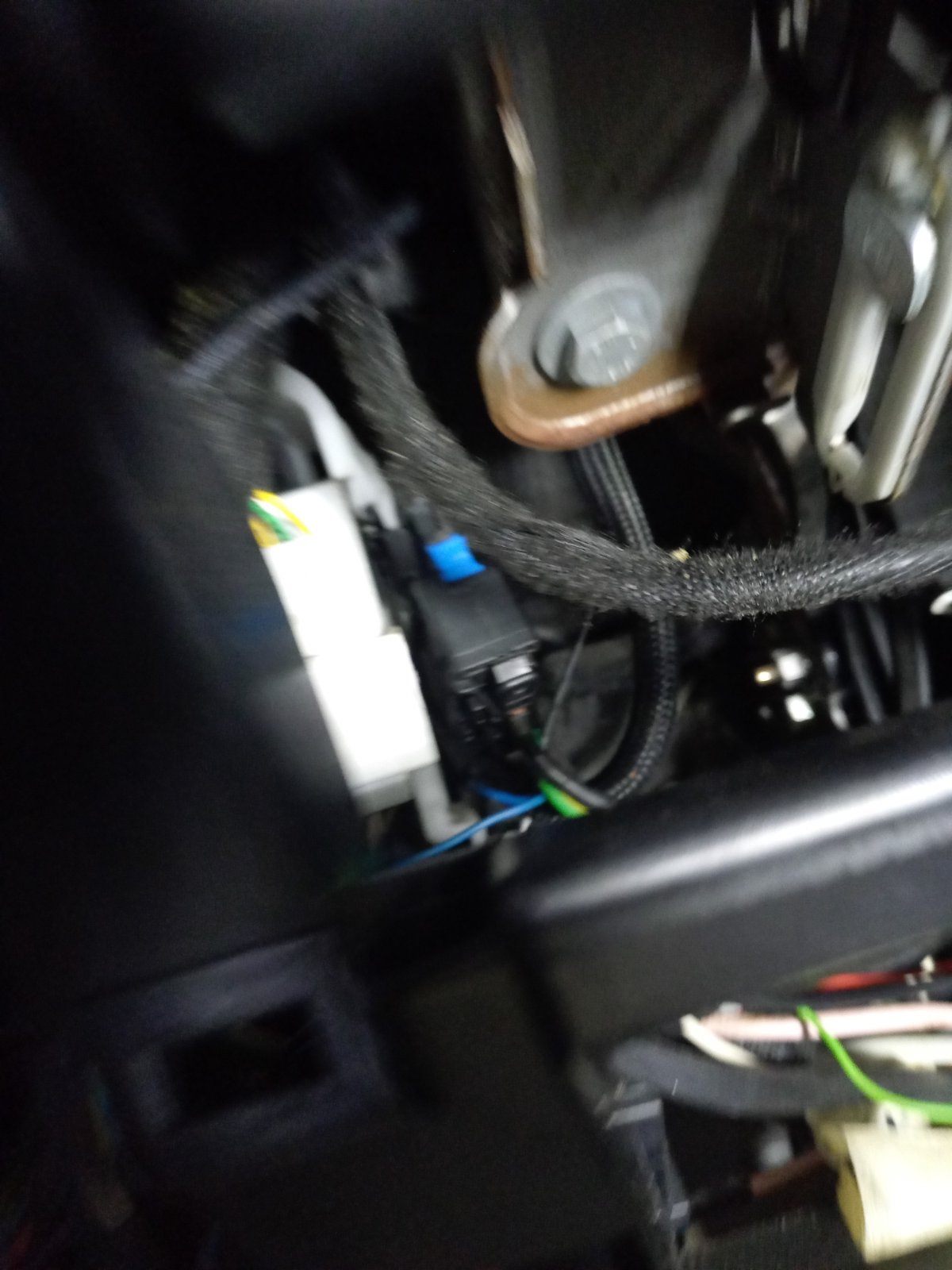

Hi, and yet the connector is damaged, replacing the resistor did not help.
I moved the plug and the blower started to work.

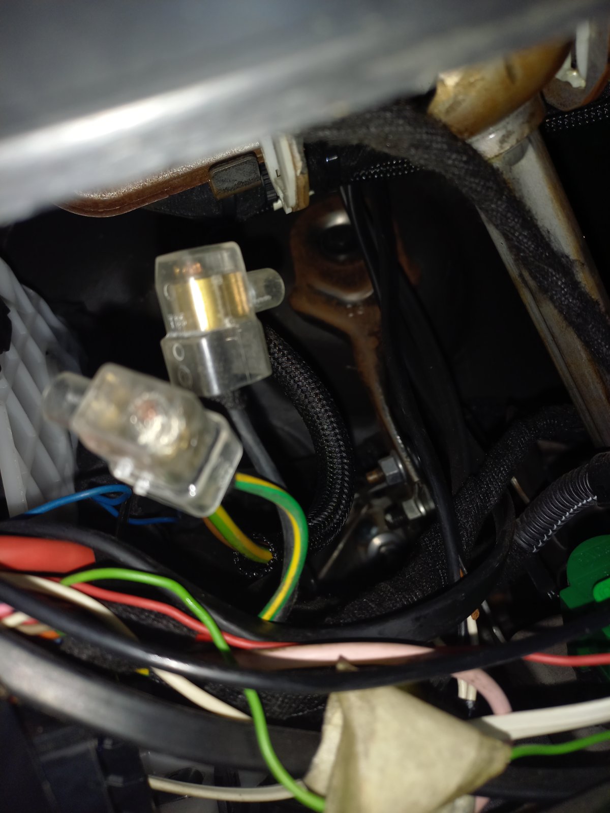

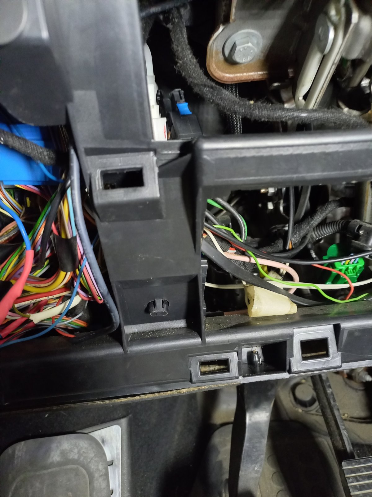

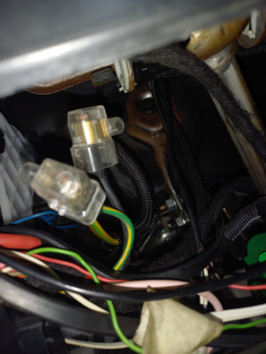

Hi here again with the same problem....the connector was ruined again so now I have adopted this solution... #-o
So that type of connector is not suitable given the temperature that the terminals reach. If you have other suggestions regarding the connection, please do so.
