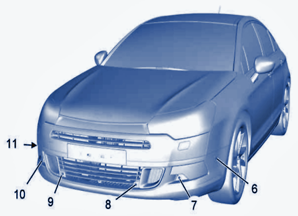

I've had a MK I, MK II and MK III and only top trim X7s have the parking space gap measurement. On the X7, with front & Rear Parking assistance and gap measurement, there is an additional sensor on each of the front left and right bumper skirt shown below as items (6) & (11). These are the sensors that measure a parking space when enabled inside using the button to see if the car will fit.
It was never fitted on the MK I or MK II C5s. These only had a maximum of 4 front and 4 rear sensors, which is why I asked about the configuration being there....
