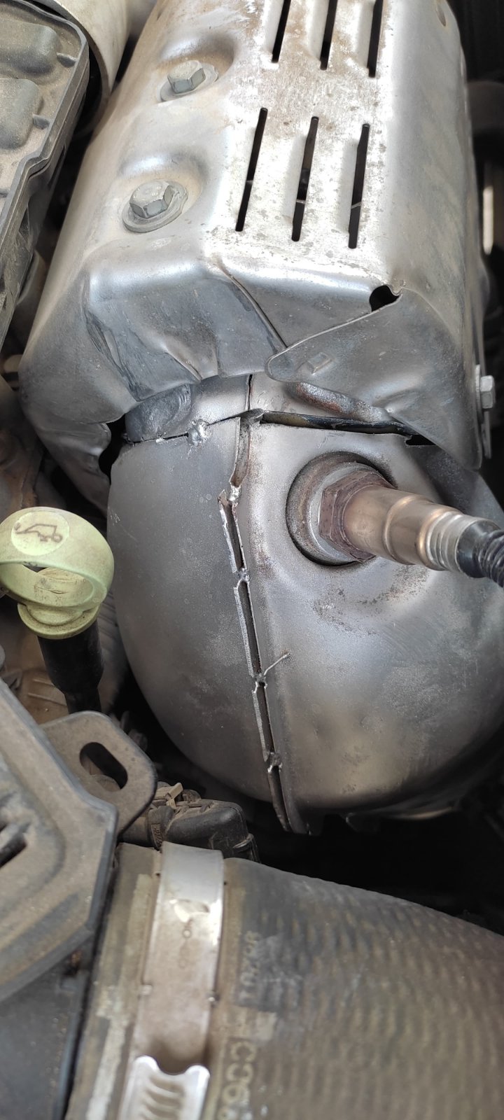

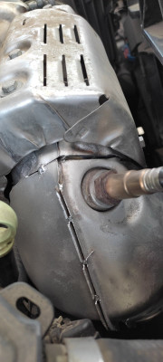

I paid attention, that Catalytic converter maybe has been repaired.
There is welding marks, and Zinc spray paint on it.
Particle filter for Patrol Engines ? I always thought it was a component only diesel engines have.
Thank you
x 6954
Re: Citroen C4 SpaceTourer 1.2 Puretech Engine Check - P226D 95
No, the later petrol engines now also have a particle filter and if you can see welding marks and tape, I would be very suspicious that someone has been there and removed the filter or the catalyst.... and then welded it up. There is no other reason I can think of for breaking it open and going inside it - there are no serviceable parts.

It's just possible the unit was split in order to do a proper clean of the DPF section and then welded up afterwards. I've seen videos of this being done on other cars.

So confirmed that this one does have a particle filter. I can't see why it would need taking apart for a 2020 vehicle. The particulate filter on petrol vehicles last way longer than a DPF, because petrol engines get hotter and therefore have hotter exhaust gas temperatures so burn off the particles more quickly. Secondly, because petrol has far less particulate matter than a diesel and the particulates are smaller, so they hardly clog.

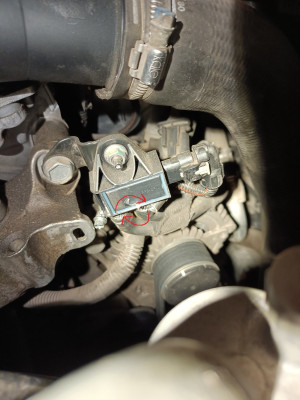

1. I payed attantion that there is some sensor, with 2 pipes connected to the Catalytic converter.
2. I saw it not have the original pipe metal bands.
3. by searching the web, i found at Ebay.co.uk, Second hand of this sensor with the original pipes. and i checked the direction of the Pipes compare to the sensor location.
4. I found that the pipes were connected incorrectly to the sensor.
5. So i switched the sides, i deleted the Error via Diabox, and issue solved. the error light didnt pop again.
6. It match to the error information : "Particle emission filter faulty: Installation incorrect. Incorrect installation of the particle filter."
