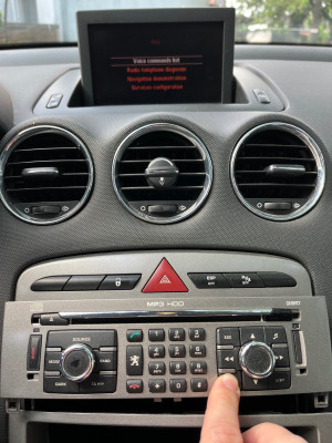

Re: Firmware version
I try to hold 10, 15 seconds... I only get HELP menu after 3 seconds, after that no matter how long I keep pressed MENU nothing happen, just HELP screenGiveMeABreak wrote: 03 May 2024, 23:15 Hold the MENU button in for 10 seconds. You should see an option that says "Unit Description"
Ok, so slightly different on your system.
Go into Radio Telephone Diagnosis
Then select Unit Description
Take a screenshot for me and post it here.

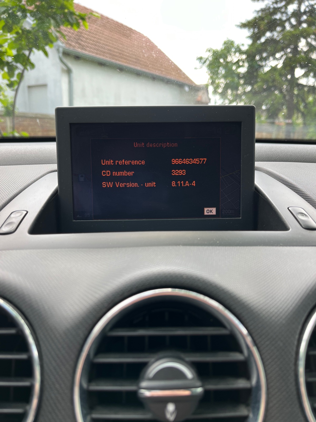

Not sure how I miss menu "Radio Telephone Diagnosis"!?GiveMeABreak wrote: 04 May 2024, 11:30 Ok, so slightly different on your system.
I have 8.11.A-4
There are also bunch of other information if I keep clicking on OK:
Date 11/03/09
Not sure what is: 227d 16h39 (Navigation worked for 227days?)
and: HDD 4d 13h46
Ok so your Firmware version is 8.11
The last version available is 8.31. You can order this on a CD from your dealer for about £10 (UK), part number is: 9679242580 should you wish to upgrade, or if it's working fine, leave it as it is.
