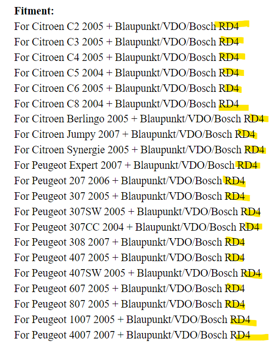

Would this be a simpler alternative: https://www.ebay.co.uk/itm/314150740640 ... media=COPY
Do you think I would regret replacing the stereo and losing this functionality? I didn't think it would be a major issue but happy to be told otherwise.
My main aim is to get Bluetooth so I can listen to music and talk on the phone.
- x 6945
Re: Peugeot 206 (2004) replace radio
No, because that is only for RD4 systems (basic units), and you have a full telematics system.
You may want to consider something like the following designed for the RT3:
https://www.xcarlink.co.uk/peugeot-rt3- ... rintable=Y
Beware there are 2 versions of RT3 (as per the photos above), a CAN and a VAN version. This is critical to ensure you have the correct type as the electronic architecture is very different and they are not interchangeable.
The link above is for the VAN version, but at the bottom of the page is a link to the CAN version of the interface. The photo above shows you which type you have by looking at the red circled buttons on each which have a different function.

Looking at the advert it only mentions music and not phone calls.pajeffery wrote: 01 May 2024, 02:46My main aim is to get Bluetooth so I can listen to music and talk on the phone.
- x 6945
That just won't work on RT3 Paul.

What won't work? I'm pointing out that the advert doesn't mention phone calls, only music.
- x 6945
That interface won't work - it's for RD4 systems, not RT3 so what is supports is irrelevant, which is what I said in my first response....Paul-R wrote: 01 May 2024, 12:22 What won't work? I'm pointing out that the advert doesn't mention phone calls, only music.
I'm trying to avoid the OP wasting time on things that are not even compatible.
