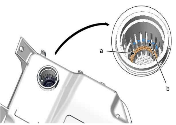

GiveMeABreak wrote: 25 Apr 2024, 09:459. Check fluid is between the 'a' & 'b' marks in the picture below.
If you have fluid between A & B marks when low and then completely depressurise the system with diagbox tank will overflow. Ask me how I know
