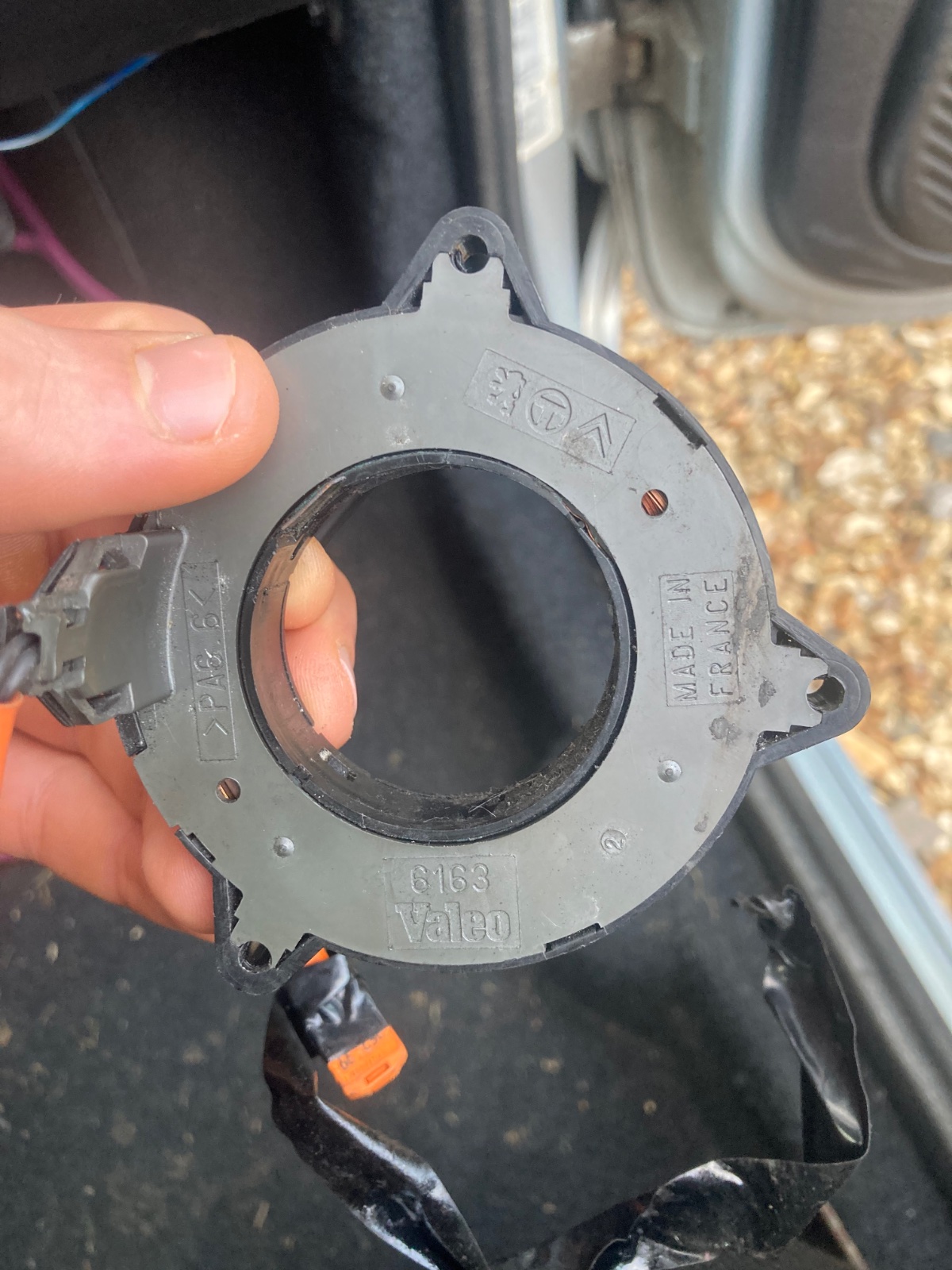

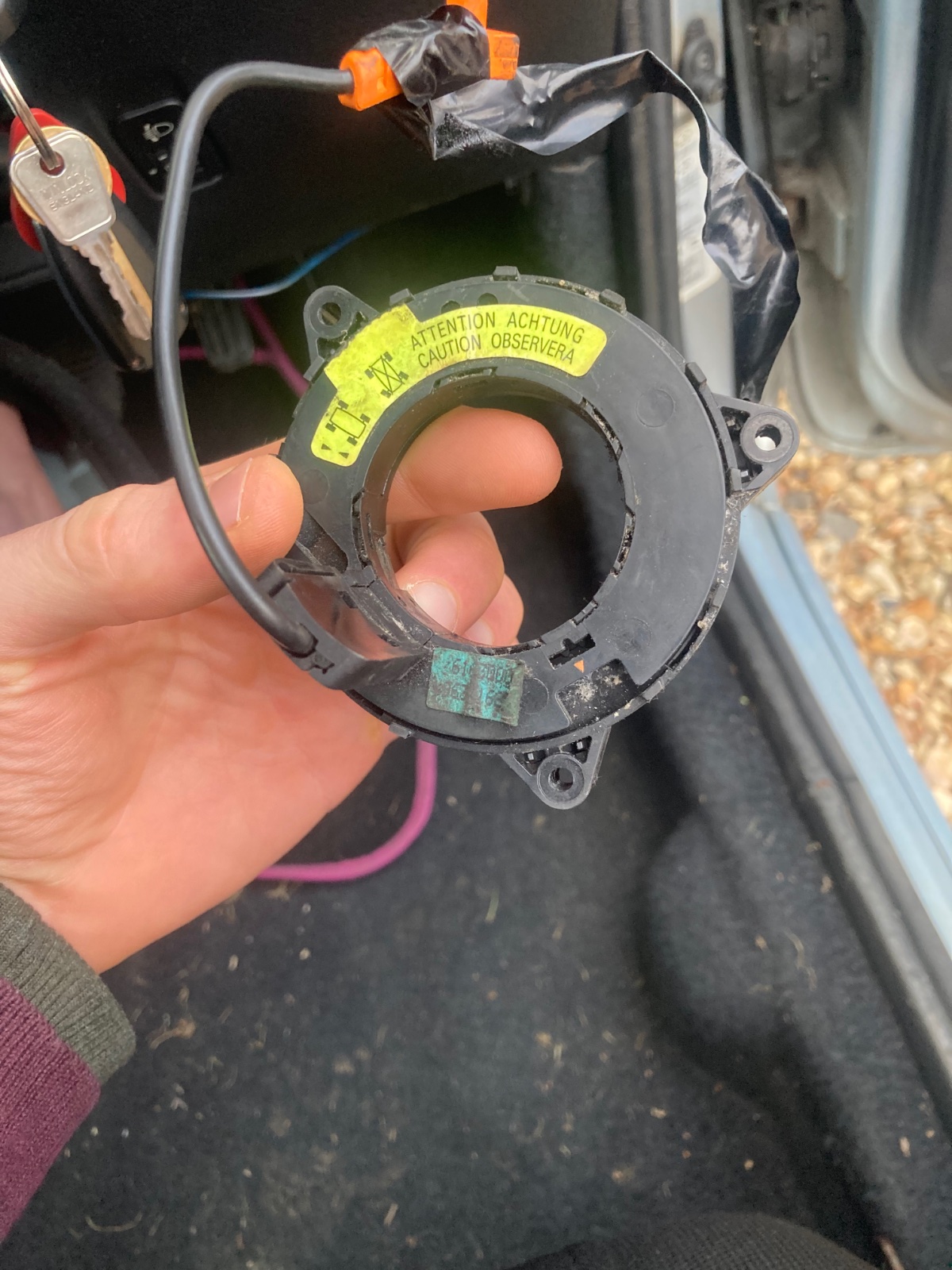

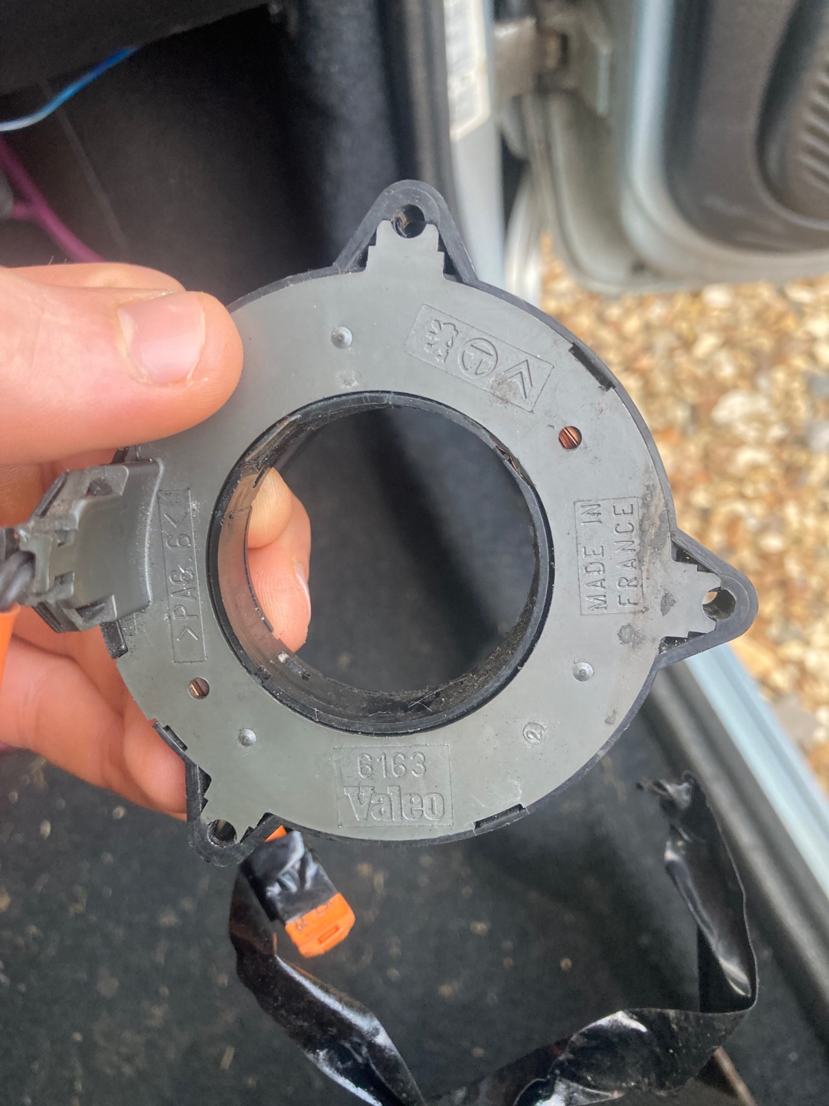

Cyan
- Posts: 8
- Joined: 25 Apr 2024, 13:32
Re: Saxo VTR cant find the immobiliser! help
Also dont know what this thing is. was resting just underneath the steering wheel.
Thanks again for your help mate

- Posts: 11000
- Joined: 09 Nov 2005, 22:03
- x 1473
That is the "clock spring" for the driver's airbag mounted in the steering wheel. I am guessing that your car has had a different steering wheel fitted without airbag.Cyan wrote: 26 Apr 2024, 19:29 Also dont know what this thing is. was resting just underneath the steering wheel.
