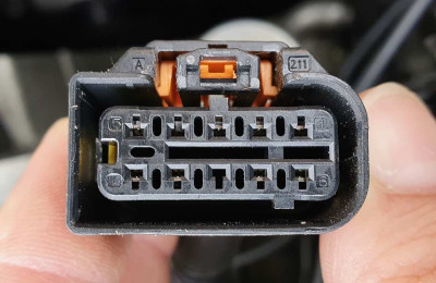

I did have a close look on the headlight-connector, but I did NOT find anything suspicious:
I followed the cabling back behind the engine without taking anything apart and I was not able to find any visual damage or anything suspicious ...

There's probably not a lot you can do with this - apart from getting the dealer to check it out as the LED units are pretty much self-contained. There is a driver unit and the headlamp, so either could be faulty, or an issue with the BSI. The fault descriptor is below. If it's the headlamp internally, then it's a new lamp I'm afraid. But I would check the connector and the pins very carefully to ensure they are making contact and that there is no corrosion. Give the connector a spray with some electrical contact cleaner spray and try to see if this makes any difference.

Yes, I have cleaned the connector using contact cleaner, but it did not make any difference.
