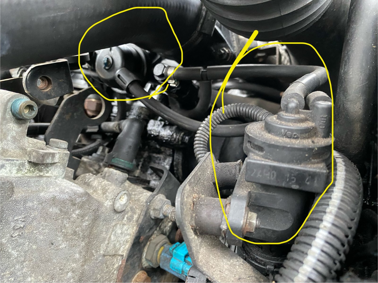

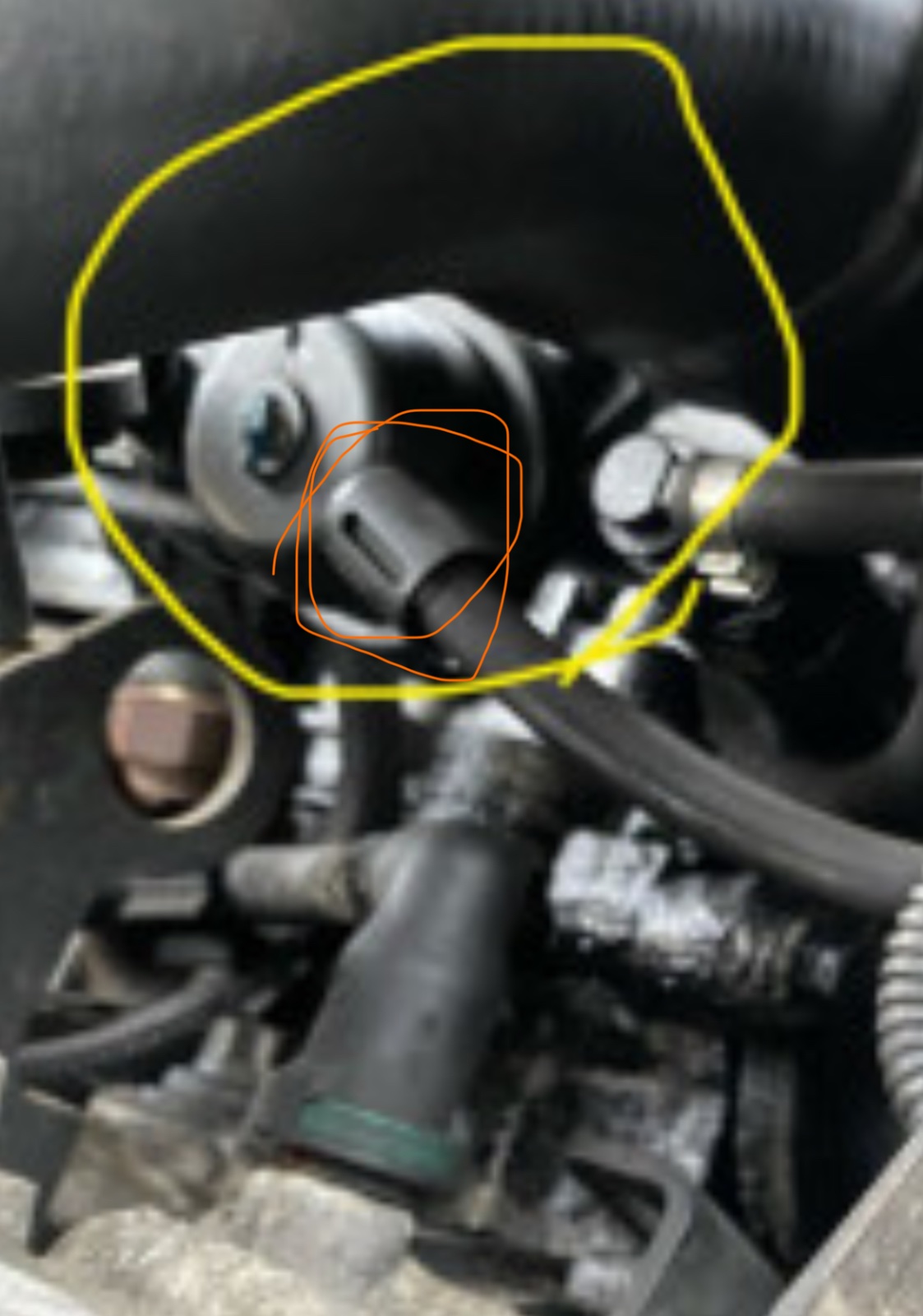

@Wheeler
Here you go. Does this connection look anything like yours did? Left hand yellow 'circle'.
wheeler
Posts: 7927
Joined: 21 Sep 2002, 19:07
x 1056
Re: Xantia HDi power gremlins
Unread post by wheeler »
Yep, exactly the same. Now i have seen the picture it reminded me how i remove them. A pick in the slot you can see to kind of grab the pipe & pull it out. There is deffo nothing else holding it on, just push on like they do on the solenoids. They can be tightly stuck if they have not been disturbed for a long time.

wheeler wrote: 10 Apr 2024, 14:50 Yep, exactly the same. Now i have seen the picture it reminded me how i remove them. A pick in the slot you can see to kind of grab the pipe & pull it out. There is deffo nothing else holding it on, just push on like they do on the solenoids. They can be tightly stuck if they have not been disturbed for a long time.
Well now you’ve said that I’ve realised that I was pulling on the wrong pipe!
You mean the one with the Clic-R clip.
I’ve also just noticed the word ‘Out’ on the solenoid valve. ‘
So In is obviously the opposite and is I suppose on the vacuum pump side of the solenoid valve.
Testing on the in side is always going to show a vacuum.
On the butterfly valve, there is a connection for the ‘in’ and the ‘out’. Again, I will happily stand corrected and perhaps need guidance on this but I suppose they are on the pressure side and the suction side?
wheeler
Posts: 7927
x 1056
No, pulls of from here.
