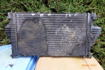

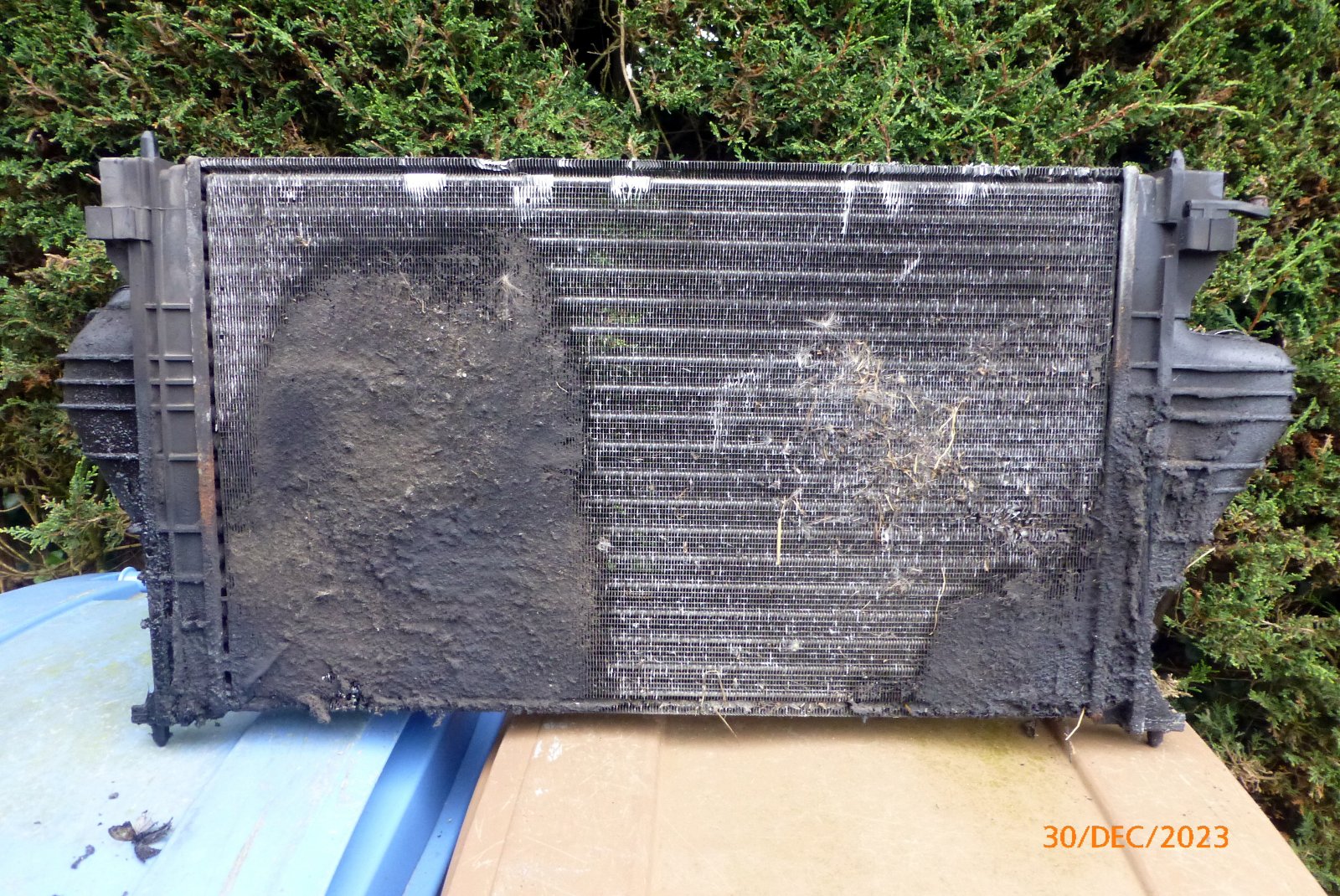

I’m back on the case. Following your suggestion Jim I removed the intercooler …. between showers just to make it easy.
Looking at the state it was in I doubt it was operating at more than 50% so removed nearly 25 years worth of highway crud and pressure tested everything along with complete pipework and found no leaks. The Mg alloy finning was on the fragile side but other than that it was in amazingly good nick. So job was worth doing and where am I now? Been out for a spin and nothing has changed. I’ve tested the MAP sensor on the road and the highest reading I got was 2.7volts. The reading at idle is the same with the engine off 2.35volts. What am I looking for? I am expecting to see a voltage corresponding to atmospheric pressure with ignition on and a small voltage drop due to the slight vacuum at tick over with a steady linear increase to approx 4.5volts at approx 2 bar around 3500rpm. MAP sensor is fully tested and functions correctly so guess its Waistgate , EGR , CAT next. Thanks for replies and suggestions in advance,
Cheers, Alan

Gosh Alan, the muck there on that Intercooler
I'm thinking you mean the MAF sensor. How did you test it? The MAF sensor is easily tested by running with it disconnected. If no discernible difference then it's dead. They are very delicate little flowers.
EGR and Cat are good candidates...

Apologies if I have caused the fog to descend here. The MAP and MAF sensors were tested and found to be functioning correctly. MAF sensor is a quality Hella, new out of the box. Sensor outputs were found to be functioning in a linear, proportional, smooth manner and compared favorably with functional behavior of spares.
As suggested car was run with MAF disconnected and found very little difference in performance between connected and disconnected. Since the clean however I can now report a noticeable improvement, particularly in the lower gears. So Jim the clean is a definite plus! No change in get up and go to report at this stage. Connected an air pressure gauge to MAP sensor pipe and noted turbo air pressure change with increase in engine speed. The maximum pressure was found to be around 7psi which is around half of what it should be at 3500rpm. Operated EGR with hand vacuum pump, found to be working smoothly with a definite sound of the internal gate closing,
Cheers Alan
Cheers Alan

That's good Alan, a lot excluded in the search... Pleased an intercooler clan has helped a little...
To prove the EGR, you could temporarily block it off... Note that it cannot be left in this state but like disconnecting the MAF, it's a good test.
Really now, given the EGR tests good as above, all that's left is either persistent small leaks in the turbo hoses or a leaky turbo wastegate...
