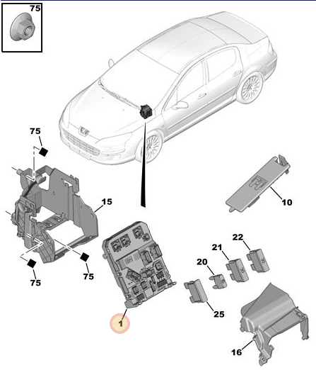

Parts are showing the separate additive ECU at (20) below on the diagram.
(2) Particle Filter Control Box, part: 1525CY (No longer available from Peugeot).
Regarding the P1445 Error:
BSI
(1) BSI New JCAE Visteon Electronics (to be configured), part: 6580JL (NFP)
Standard Exchange BSI (to be configured), part: 1660728180 (NFP)
JCAE BSI (pre-configured), part: 6580JN (NFP)
NFP = No Longer Available
Engine ECU
(1) New Engine ECU (Bosch) to be configured, part: 1942CR (NFP)
Configured ECU, part: 1942CS (NFP)
Remember that the BSI, the engine ECU and the transponders in the Fobs are matched sets and can't just be replaced unless you are replacing with a complete matched set from the exact vehicle with the exact same options.
Engine ECU

Thank you for your advice. But we still couldn't find the additive ECU.
The factory ECU part numbers 1942CR & 1942CS you send me, require a cross-range BSI. And when I looked up the schematics in ServiceBox/Sedre, a Cross range BSI doesn't have an addditive ECU.
Am I worng?
Am I worng?
- x 6956
Re: Peugeot 407 SW 1.6 HDi additive quantity problem
I've just had a look at the wiring diagrams too and yes, you have a cross-range BSI, and there is no separate additive ECU. So this is why it's confusing with the engine data that says otherwise as you can see from the previous info in my last post. Unfortunately this can be where they update one system and not the other - or don't make it clear.
