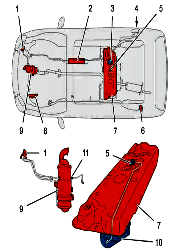

I provided the BSI, but forgot the engine ECU, so will update my previous post shortly on this. This is the official diagram, so shows it as fitted. On later vehicles the function was switched to the engine ECU, but for a 2006 model, this function should still be carried out by the additive ECU.
Here is the location of the Additive ECU - item (6).
| Reference | Designation |
| (1) | Particle filter differential pressure sensor |
| (2) | Fuel cooler |
| (3) | Fuel tank unit |
| (4) | Fuel filler cap |
| Fuel tank cap presence sensor | |
| (5) | Fuel additive injection valve |
| (6) | Fuel additive ECU |
| (7) | Fuel tank |
| (8) | Engine ECU |
| (9) | catalytic converter + Particle filter (FAP) |
| (10) | Additive tank |
| (11) | Downstream exhaust gas high temperature sensor |
Pedja

Thank you for your advice. But we still couldn't find the additive ECU.
The factory ECU part numbers 1942CR & 1942CS you send me, require a cross-range BSI. And when I looked up the schematics in ServiceBox/Sedre, a Cross range BSI doesn't have an addditive ECU.
Am I worng?
Am I worng?

I've just had a look at the wiring diagrams too and yes, you have a cross-range BSI, and there is no separate additive ECU. So this is why it's confusing with the engine data that says otherwise as you can see from the previous info in my last post. Unfortunately this can be where they update one system and not the other - or don't make it clear.
So at least you can rule the separate additive ECU out and just need to focus on the additive pump:
Other options are that if we are talking about the original additive pump that wasn't used for years, then it could be damaged from dry running.
Also when the engine ECU was replaced (I assume you are referring to the engine ECU) I an guessing you had to have it 'virginised' in order to code it to the BSI? If not, and you also replaced the BSI as a matched set with the fob transponders, then it may be a matter of incorrect configuration of the BSI and / or the engine ECU as to why it isn't working. But there is data from somewhere as it obviously thinks there is too much additive int he tank. So there looks like something has been altered there....
