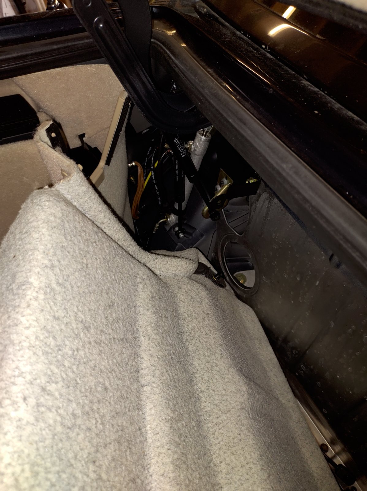

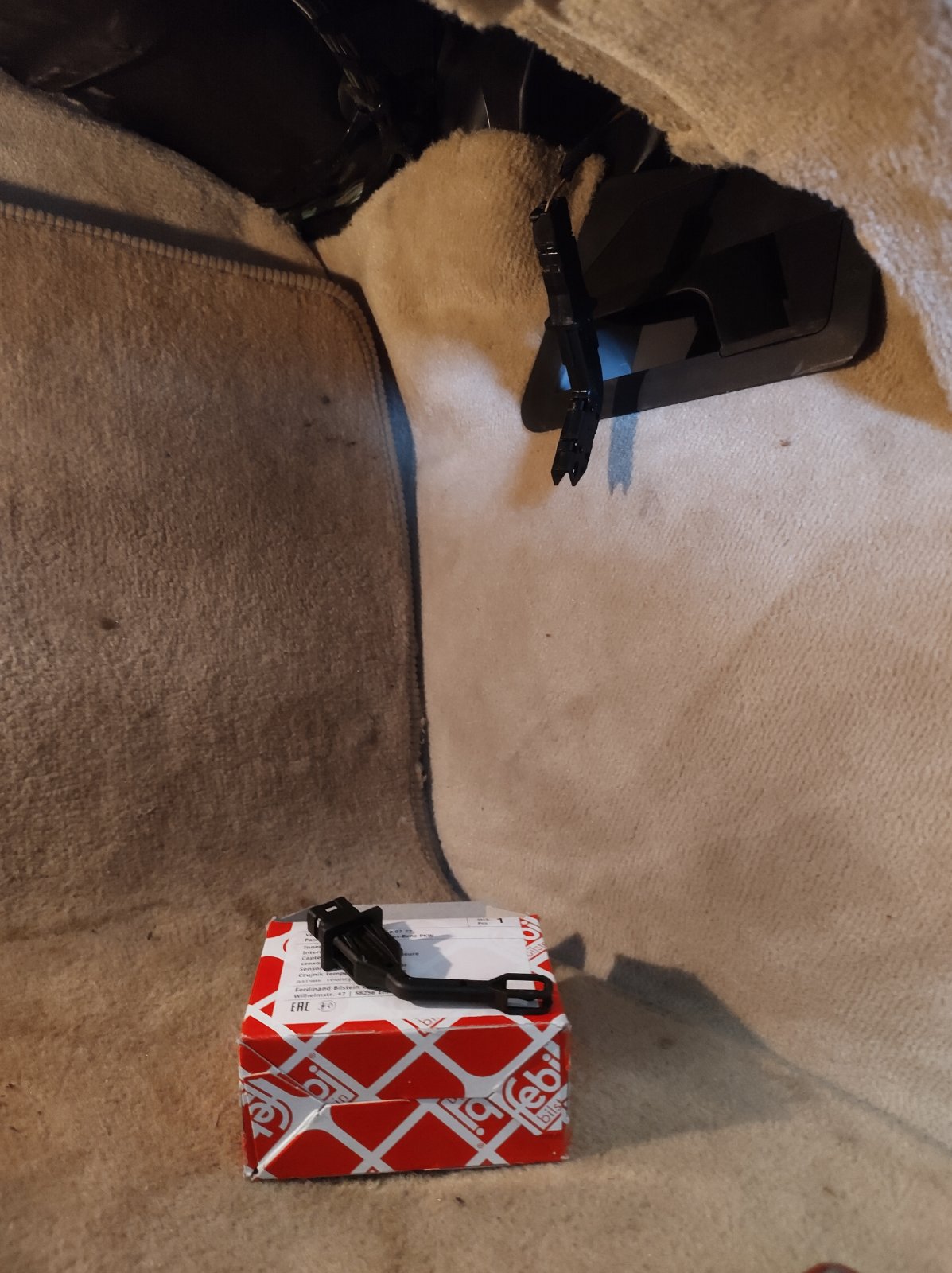

I fitted the new boot struts which was easy enough. The originals were made by Stabilus but with the all important 3 pointed star printed on them. The repalcements I fitted were also made by Stabilus but without the 3 pointed star printed on them. They were half the price of the 'genuine' Merceds ones

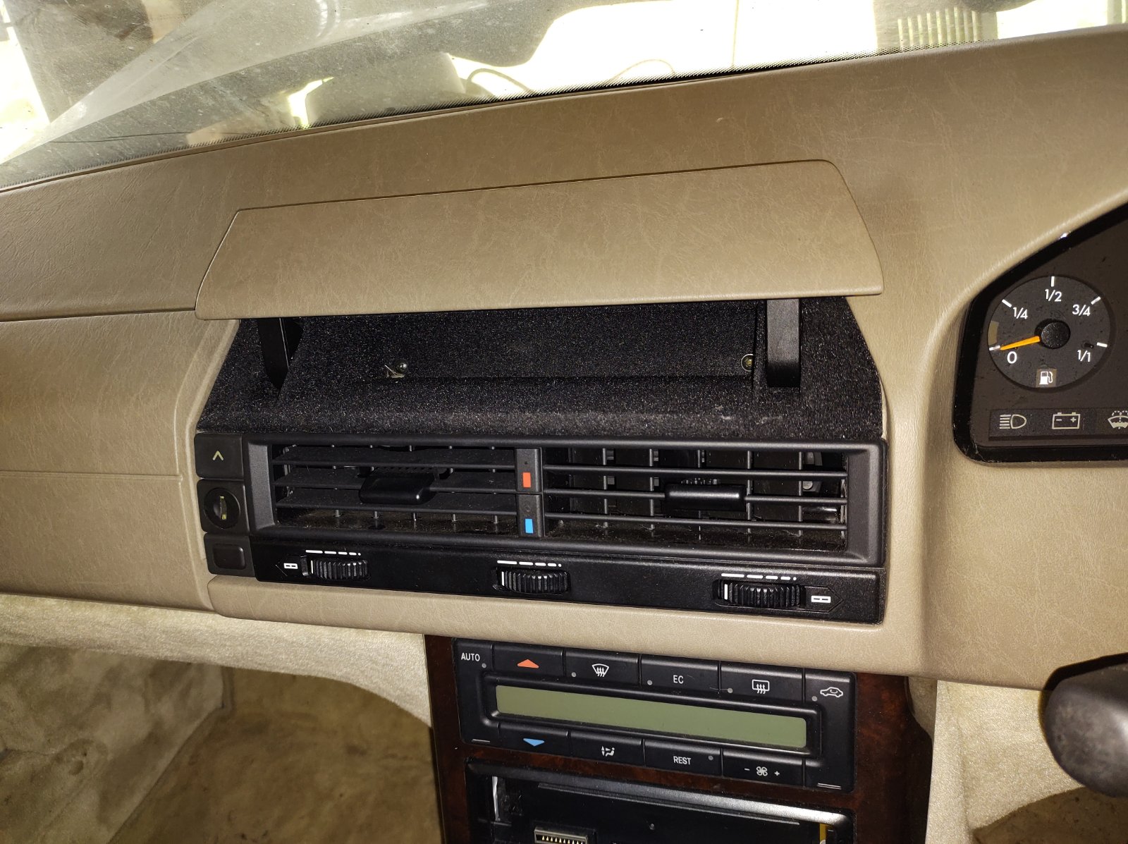

I also fettled the centre 'glasses compartment' cubby box on the dashboard so it shuts - and stays shut - now. Not a perfect job, but an improvement on what it was. No photos of the work involved as it involved grease and swearing and filing. At some point in the past someone had forced the cubby box (it's lockable) and bent bits of its mechanism so it didn't perform as it should. This is the 'before' shot - use your imagination for the 'after' shot

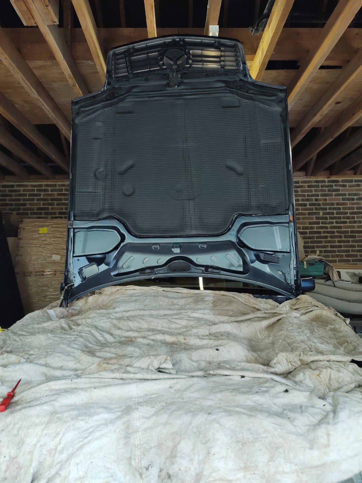

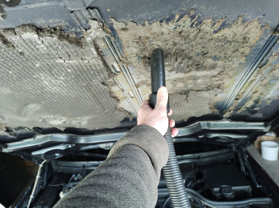

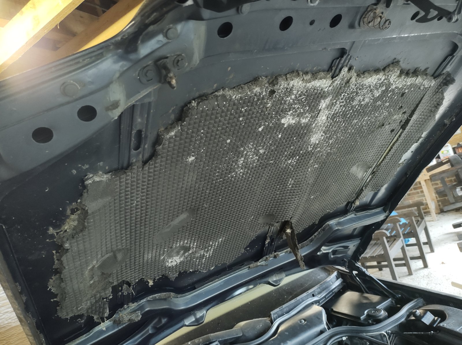

Another job on the 'to do' list was the under bonnet insulation pad.

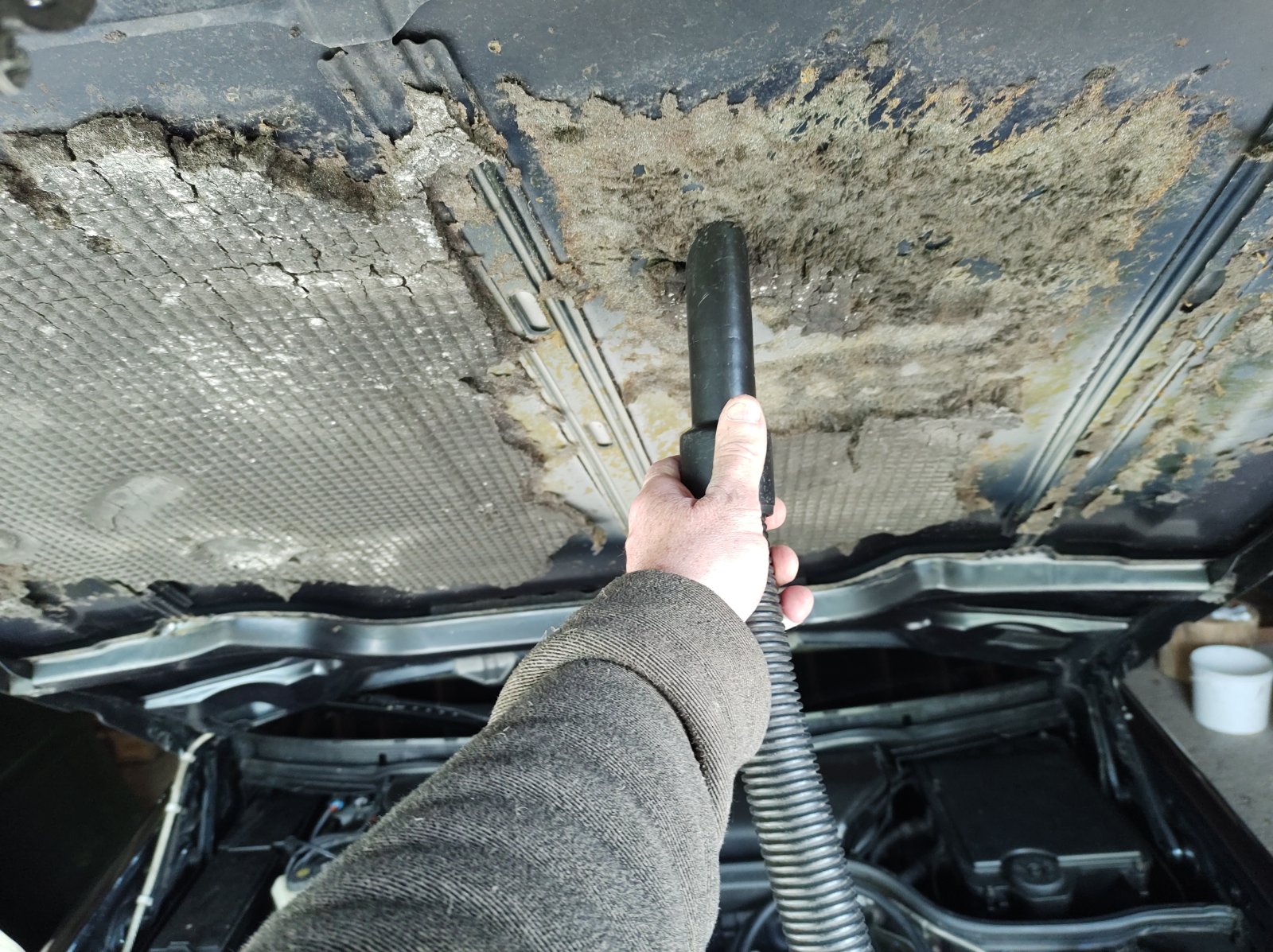

The old under bonnet insulation pad had seen better days..........
Most of it came off with a Henry vacuum cleaner.
Fitting the new pad is one of those jobs that is just ripe for misery
It requires trim spray to be applied to both the under bonnet and the new bonnet pad..... and not on the car's bodywork

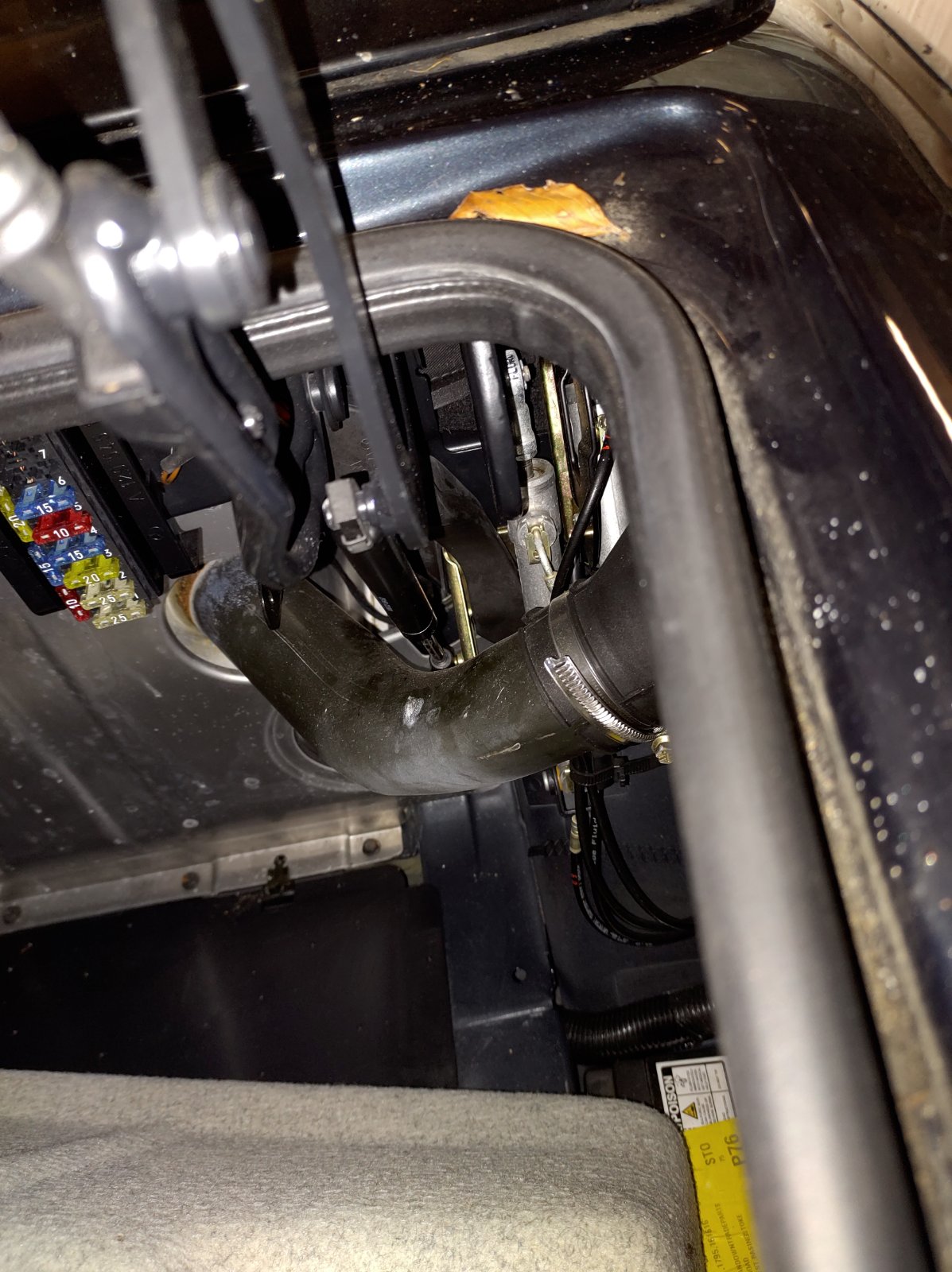

After previously running a diagnostic session on the climate control unit, it'd shown an erronious temperature on the air temp sensor. This turned out to be a ridiculously simple job - if you don't count having to stand on your head in the passenger footwell. First - locate the sensor plug using stereognosis. Second - pull the sensor out of its housing and unplug it. Third - plug in the new one and shove it back where it came from. Why can't all jobs be like this ?
One job done on the aircon.... and another one shows up. Low gas pressure on the diagnostics. I tentatively put some gas in the system using a home top-up bottle, but didn't get very far before it let go on the condenser in the front. Bu88er.

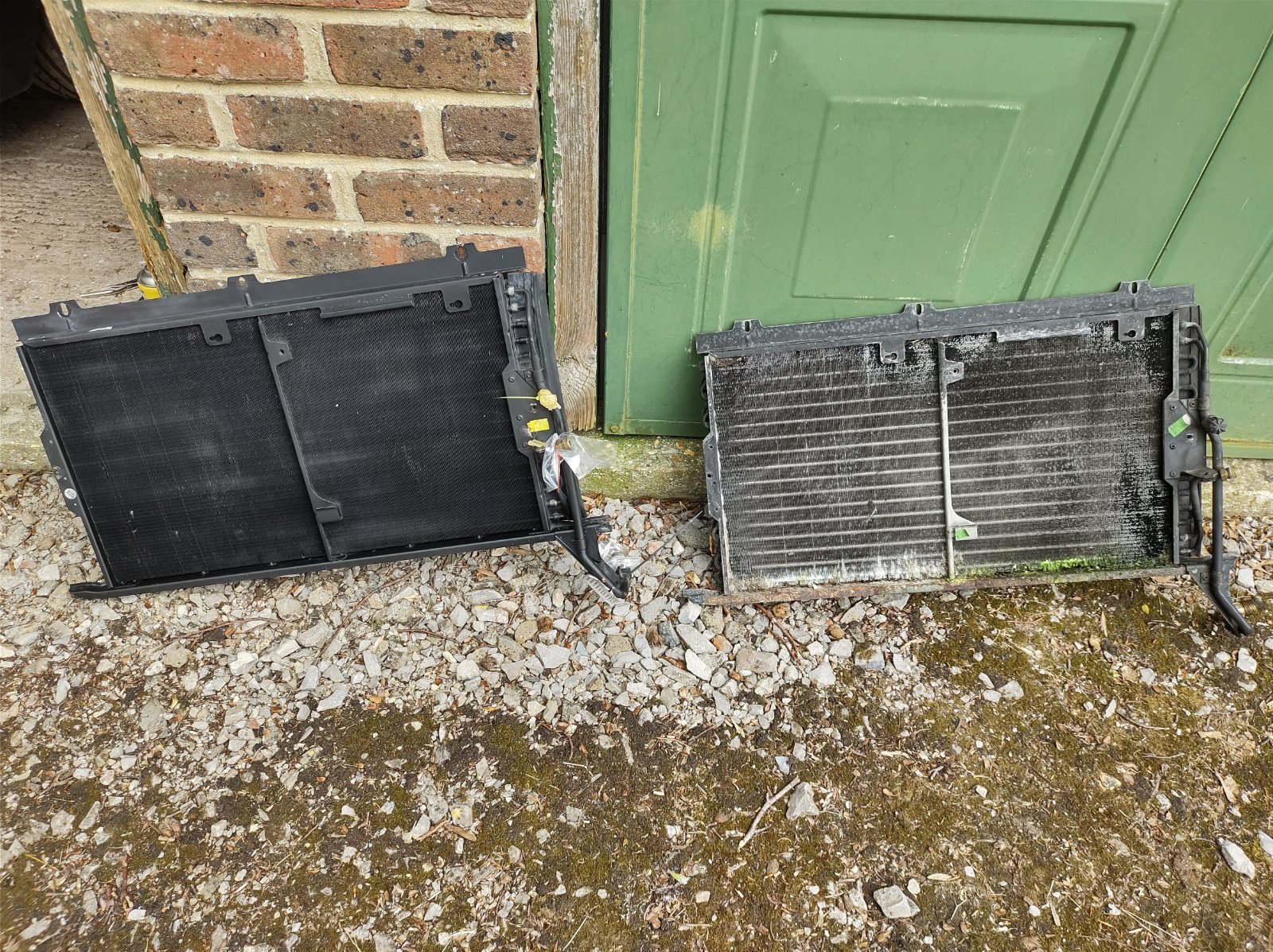

Condensers for these are hard to come by, but I did find a very good condition used one for sale.... in Lithuania
I paid my money and crossed my fingers and waited, and......... it arrived and it was just as good as in the pictures
See if you can work out the good one and the bad one.
Fitting wasn't too much of a drama.... apart from one of the steel pipe unions not wanting to part from its brass connection. A bit of heat and some swearing saw it give in in the end

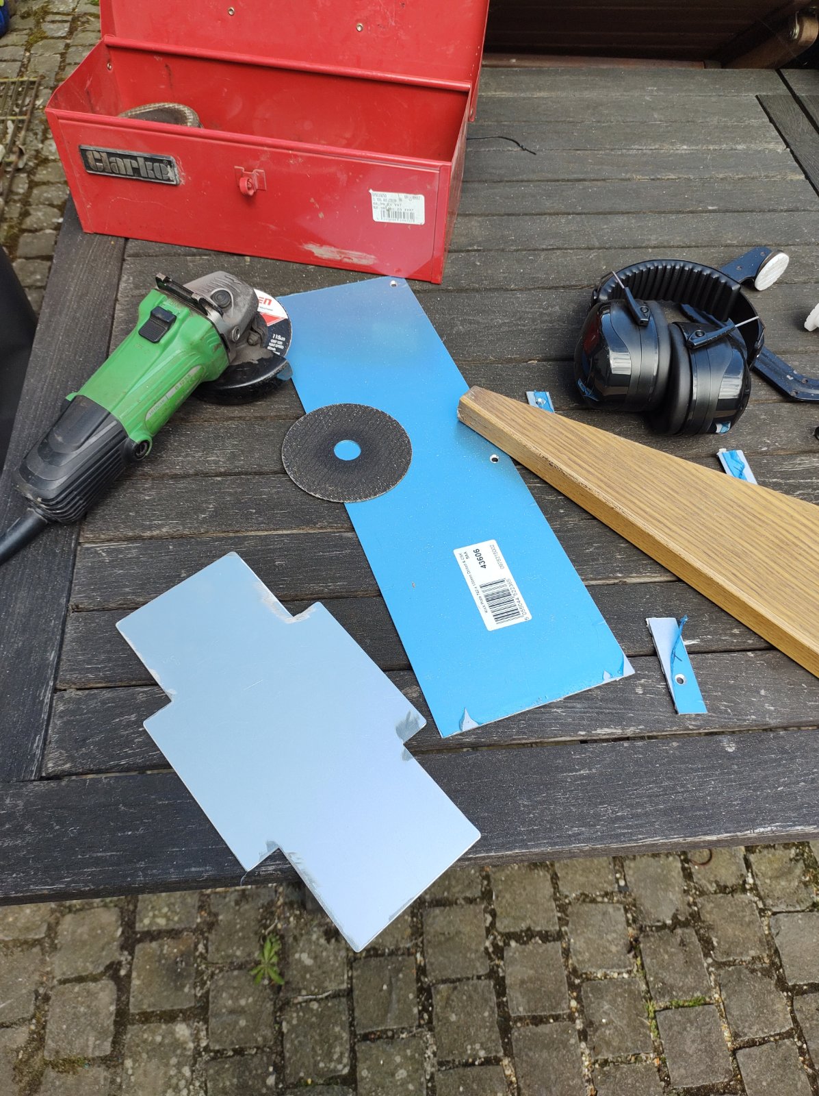

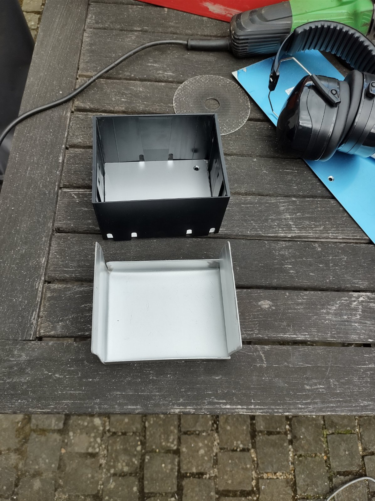

Onto something different - a bit more fabricobbling was called for to convert the old cassette tape storage rack in the centre console into something more useful. You can buy a genuine Mercedes plastic tub that replaces the cassette (or CD) storage box if you want.... but I'm not prepared to pay just shy of £100 for that pleasure
The cassette box sits between the gear lever and the arm rest.
So with a bit of aluminium that bears a strong resemblance to a door kick plate from Toolstation, I cut 'n' bent up a box to take the place of the cassette thing, and then covered it in black baize cloth.

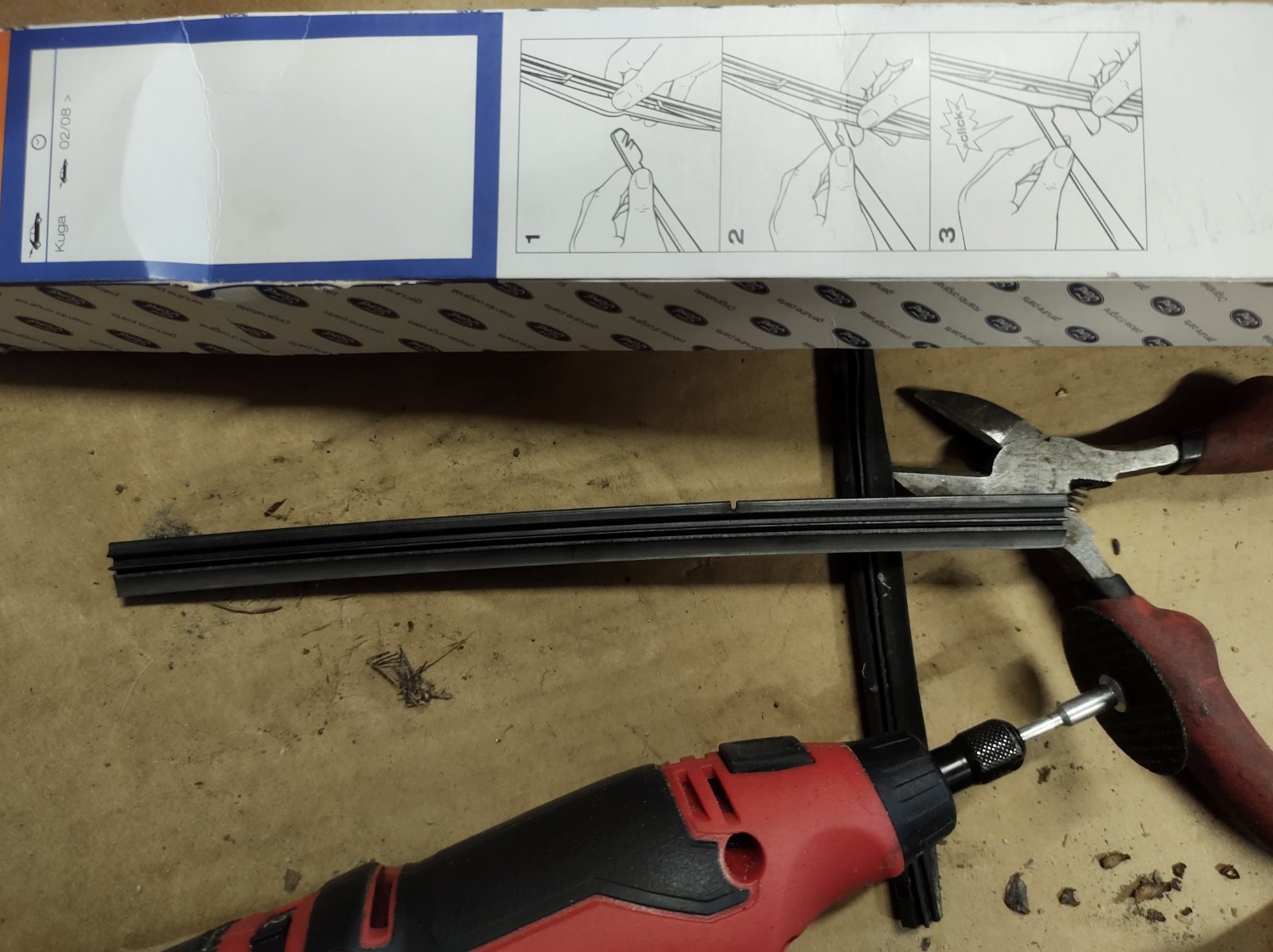

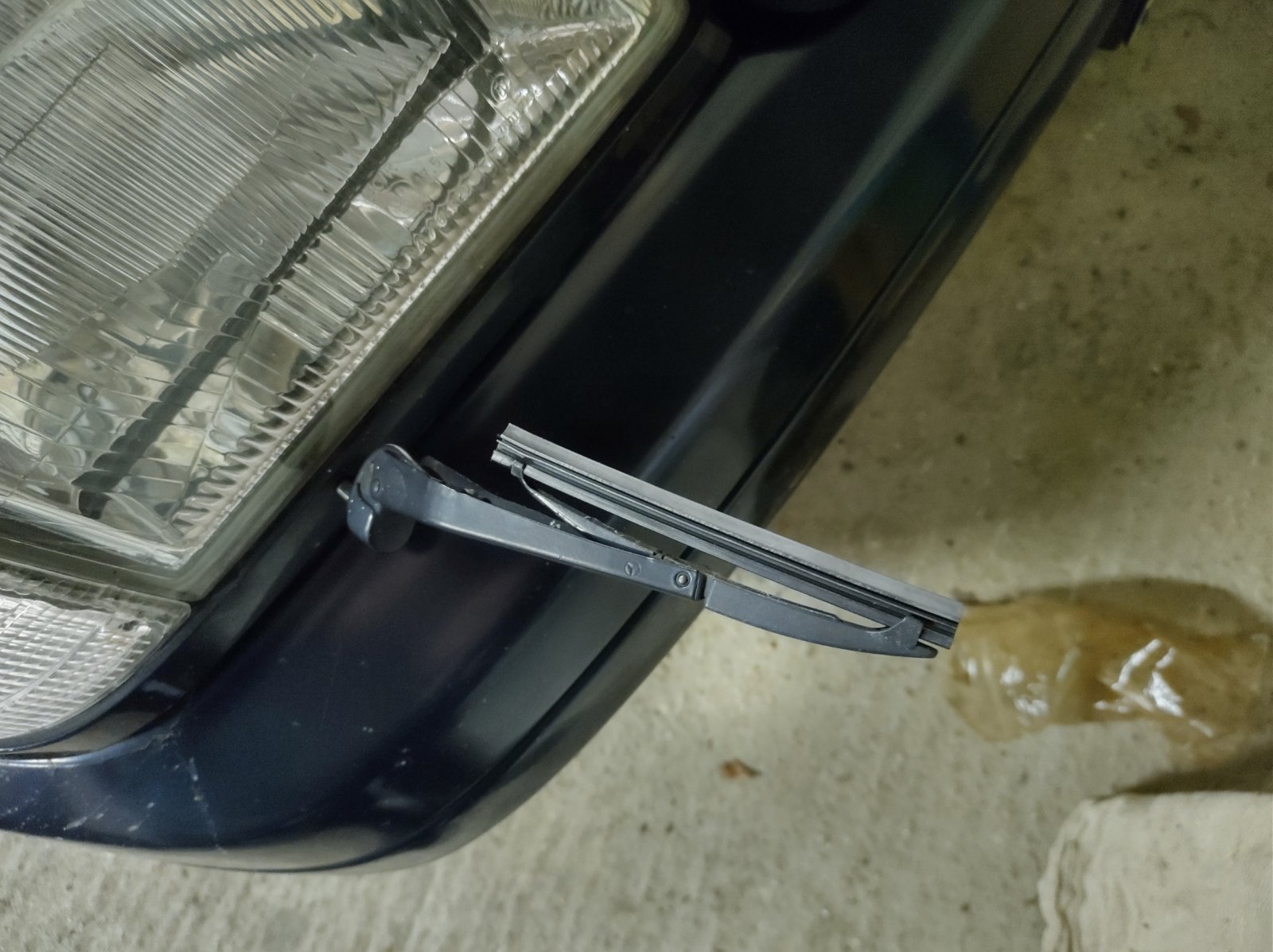

More cheapskating was required for the headlamp wipers. The old ones no longer resembled rubber wiper blades, and you can buy 'proper' replacement blades for lots of money...... or if you're me you find a cheaper way of doing the job
The blades are of a specific construction and design, and no amount of opening up the various wiper blade boxes in Halfords on a Sunday morning would come up with the proper design. Fortuitously, I stumbled across an ebay listing for a genuine Ford Kuga 'Premium' rear wiper blade that showed the correct design - it has a central stiffener running down the spine of the blade rather than the much more common 2 steel spars running down the sides. A few minutes with the Milwaukee and I had 2 replacement wiper blades.
