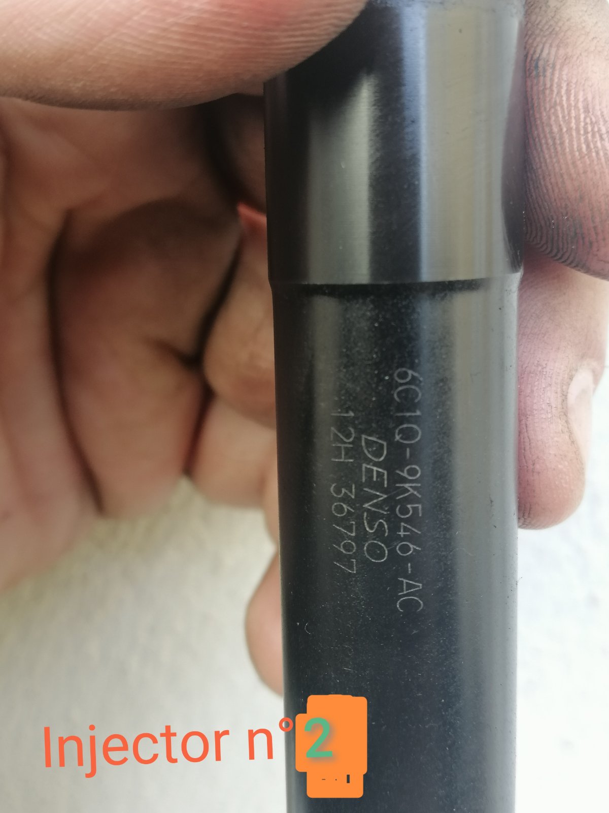

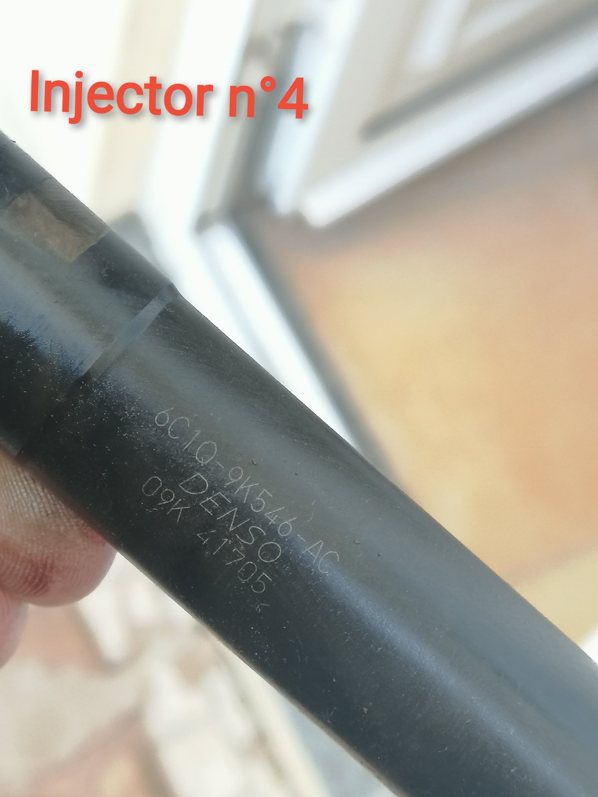

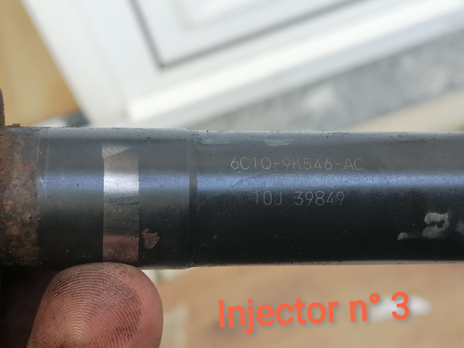

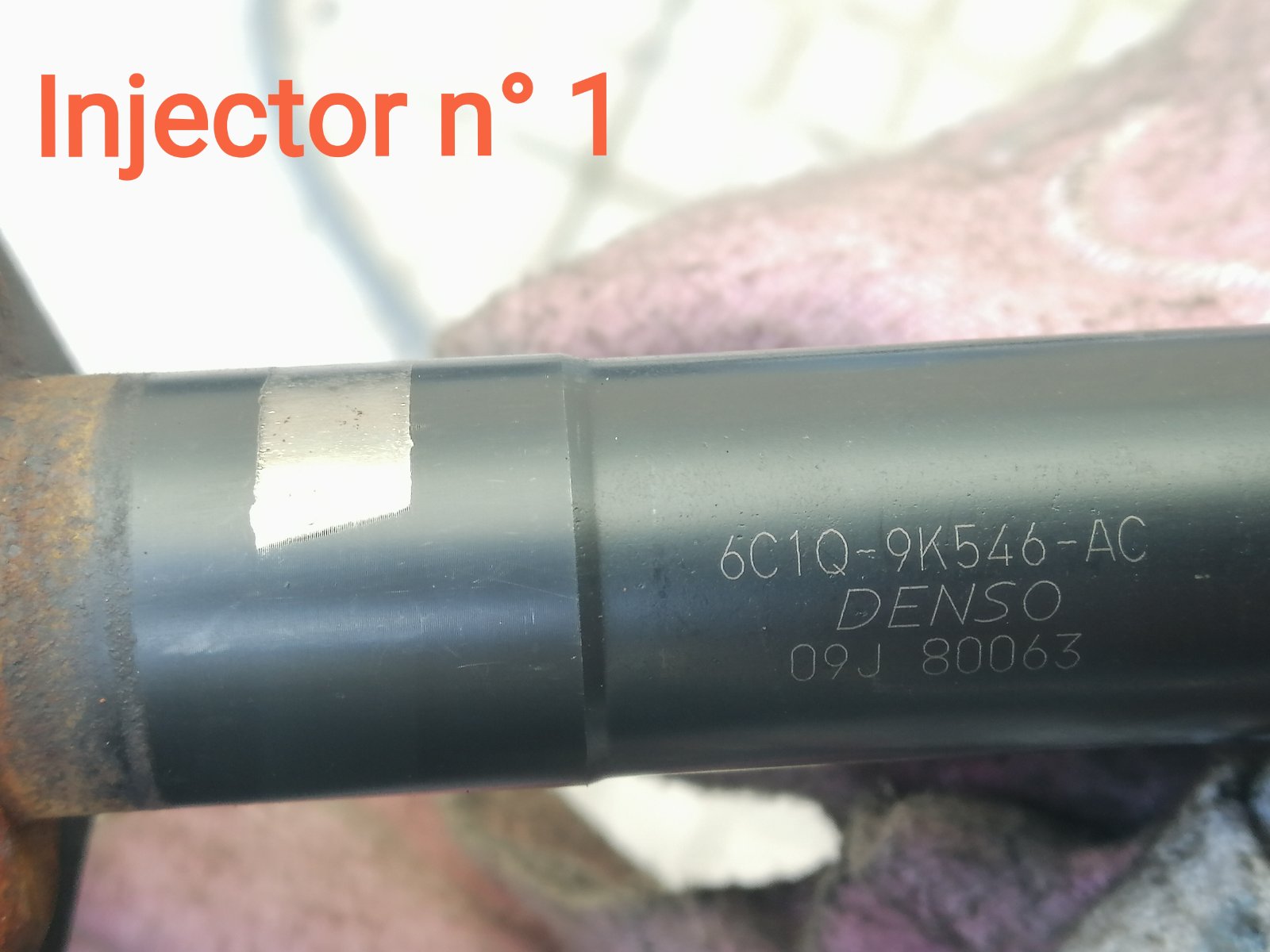

The engine was replaced (complete, including injectors) however the "new" injectors were not recoded into the van's ECU programming.
The original codes that are programmed are 16 characters long, however current injectors only have an 8 character code that the diagnostic program (diagbox) does not accept.
The injectors in question are the 6C1Q-9K546-AC, and I cant find any code on top connector, just the following codes on side body of injectors:
1 - 6C1Q-9K546-AC 09J 80063
2 - 6C1Q-9K546-AC 12H 36797
3 - 6C1Q-9K546-AC 10J 39849
4 - 6C1Q-9K546-AC 09K 41705
I would like to know how I can convert the 8-digit code of the current injectors to the 16 characters requested in the diagnostic software.

Aren't the codes just the last 8 alphanumeric of the above?

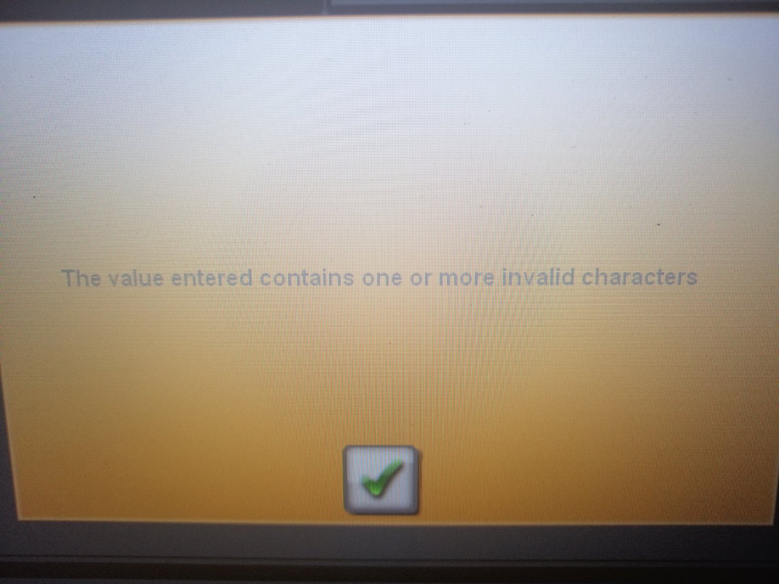

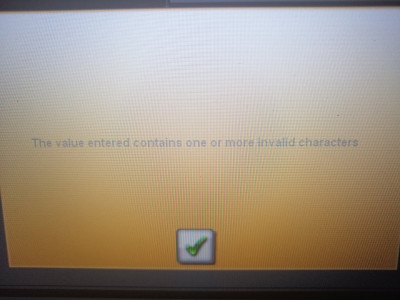

It makes sense that it would be those last 8 digits, but Diagbox doesn't accept them. Diagbox only allows you to enter a 16-digit code.
Could it be that my ECU software is not compatible with these injectors?

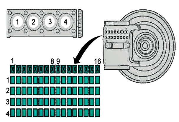

If it is not accepting the code then have you selected the incorrect information in Diagbox? Did Diagbox autodetect everything from the VIN or did you enter details manually.
If you have selected the incorrect injection system or other information then this may be why it is not accepting the codes.
Information suggests the following:

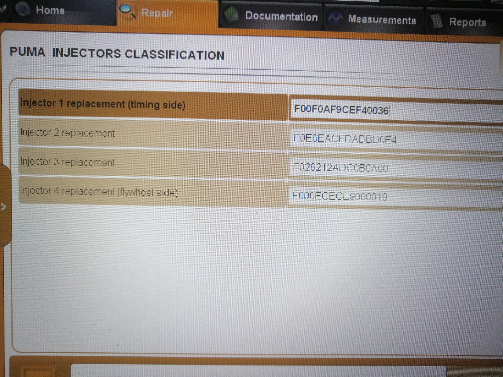

You are right regarding the lack of autodetect of the VIN/van details, when I enter the diagbox I am forced to manually enter the VIN and model of the van (I always choose the Boxer 3 option, am I choosing correctly?).
But after that, the Diagbox correctly identifies both the injection ECU (Puma engine, dcu-102 ECU) and the BSI.
The diagram you posted from Diagbox showing how to enter the injector code is the same to how it appears to me.
Is it only supposed to accept 8 digits?
(When I try to enter just 8 digits, Diagbox responds with an error saying that there are invalid characters in the code. I tried all 4 codes, always the same result).

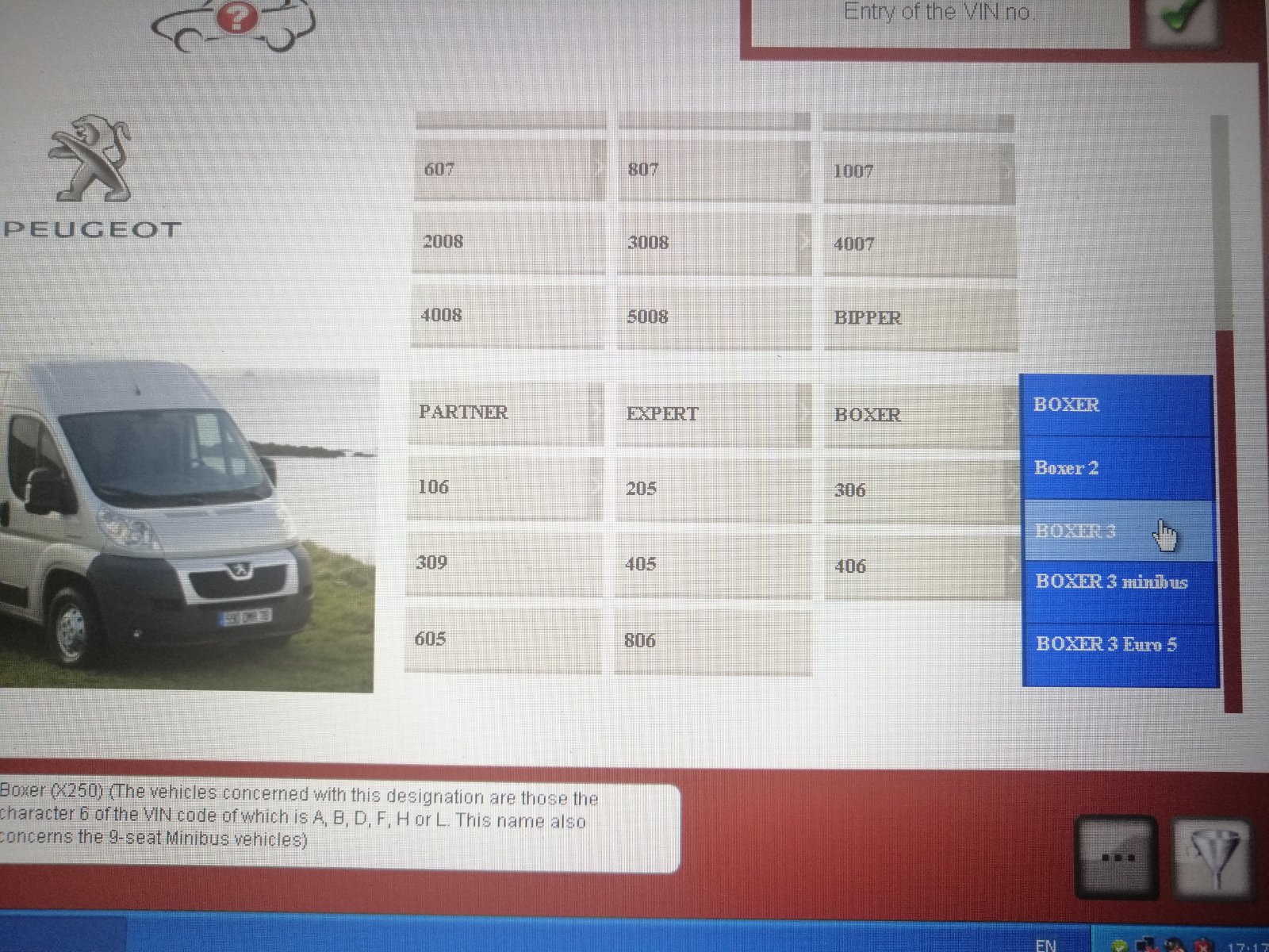

1) What other options did you choose when selecting vehicle type
2) Did it ask for the build date? (RPO / DAM) and if so what did you enter?
3) Did it ask to choose the injection system and if so what were the options and what did you choose?
4) What version of Diagbox are you using?
Anything else that might be relevant.

1 - Just the Model (Boxer 3) and manually the VIN number.GiveMeABreak wrote: 25 Mar 2024, 18:43 1) What other options did you choose when selecting vehicle type
2 - No, never asked

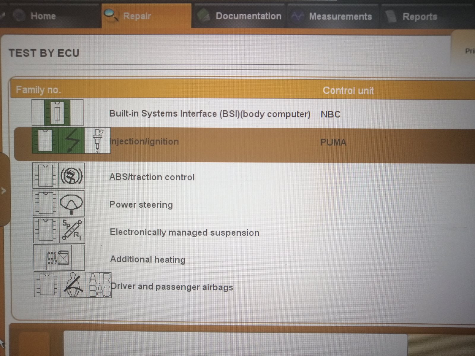

3 - No option for that too. After connected, Diagbox lists the present modules. In this list we can see the BSI (NBC) and the ECU Injection/Ignition (Puma).
If I enter in one of these control units, I can see all parameters, live data, options from Repair menus, etc.
I can't do telecoding because I'm offline...
4 - Diagbox Version 7.62
