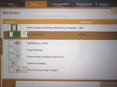

You are right regarding the lack of autodetect of the VIN/van details, when I enter the diagbox I am forced to manually enter the VIN and model of the van (I always choose the Boxer 3 option, am I choosing correctly?).
But after that, the Diagbox correctly identifies both the injection ECU (Puma engine, dcu-102 ECU) and the BSI.
The diagram you posted from Diagbox showing how to enter the injector code is the same to how it appears to me.
Is it only supposed to accept 8 digits?
(When I try to enter just 8 digits, Diagbox responds with an error saying that there are invalid characters in the code. I tried all 4 codes, always the same result).

1 - Just the Model (Boxer 3) and manually the VIN number.
2 - No, never asked
3 - No option for that too. After connected, Diagbox lists the present modules. In this list we can see the BSI (NBC) and the ECU Injection/Ignition (Puma).
If I enter in one of these control units, I can see all parameters, live data, options from Repair menus, etc.
I can't do telecoding because I'm offline...
4 - Diagbox Version 7.62
The Injection ECU was opened before by someone, and reprogrammed (immo related I think). For some reason, the injection ECU don't fire any faults, never. I don't know if it is possible to someone deactivate the faults trigger on ecu code, but this is odd and very bad to diagnose the van problems.
In another hand, BSI triggers and stores faults when they're present.
Anyway, are you sure that it is supposed to Diagbox accept a 8 digit injector code?
I suspect that I'll need a 16 digit code (I think that Denso injectors have at least a minimum of 16 characters, what correspond with the diagbox diagram/representation that you shared above. Maybe, somehow, the top connector codes are missing in my injectors?).
