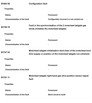

So the very kind RichardW helped me out tonight and we found some fault codes. Wondering if you could help me with them Marc?
There was a whole array of codes but after a wipe then trying to open the tailgate these are the ones that returned.
x 6955
Re: C4 grand spacetourer tailgate issue/battery drain
Here are the reasons for these faults. My thoughts are that as I mentioned previously, one of the struts is likely weakened or has a supply fault - that is causing the other 'calibration' error / alignment fault.
The other thing of note is that if the tailgate is opened or closed with the battery disconnected - it doesn't like that and the positioning is all out. But I would expect a reinitialisation of a manual opening and closing operation to resolve this.
So a few things to start considering.
Fault Code: B1003 55

Fault Code: B1746 78
Description of Fault: Fault in the synchronisation of the 2 motorised tailgate gas struts (Initialise the motorised tailgate). Difference in position between the right-hand strut and the left-hand strut. Conditions of activation of the diagnostics: In all the operating situations.

Fault Code: B1747 04
Description of Fault: Motorised tailgate initialisation fault (Loss of the motorised tailgate ECU supply or position of the motorised tailgate not coherent). Loss of initialisation of the motorised tailgate, if:

Fault Code: B1751 11
Description of Fault: Motorised tailgate right-hand gas strut position sensor signal fault: Short circuit to earth. Short circuit to earth detected for 1s.
Unread post by Spacetourerman »
Thanks very much for the info.
Yeah you did call it, so hopefully a change to the strut should resolve this and the other issues? Could I check the cable coming out of the strut, continuity check with a multimeter perhaps?
I don't think I have moved the tailgate whilst the battery is disconnected but I couldn't be 100% certain to be honest.
With regards to the B1003 55 fault, how would I go about configuring it, assuming this is different to the initialisation (hold the internal tailgate button for 3 seconds when fully open right?)
The initialisation looks to be what is required to clear faults 2 and 3, with a strut replacement or maybe wiring correction for fault 4. Would you agree mate?
x 6955
I would first deal with the strut, on the basis that this may cause the ECU to think there is a calibration issue - in that it is not getting the correct data, being that one strut is not operating effectively. The ECU can only act or make assumptions on the data it is receiving.
If it was just that fault code alone I would check the ECU configuration / programming - but as we know there are other issues with at least one strut (whether that is a wiring / supply / short problem) you might want to consider dealing with that first. I would be checking the connections and looking for breaks / shorts from the struts to the tailgate ECU and from there to where the loom enters the tailgate at the top rear left.

Yeah I think will take the tailgate trim off and have a look at some point soon, hopefully I can figure out how to take that off without snapping the bloody thing or breaking clips. Then I should be able to do some checks on the wiring, the fact that the fault refers to a short circuit to earth, does that mean its likely to be an electrical rather than mechanical issue - even thought was groaning etc?

The configuration fault was a hard fault and wouldn't clear. All the other faults cleared with the door closed, but came back as soon as we tried to open it - and on live data it reported 'invalid' value for the position as soon as it moved. I tried the configuration but there were only 3 fields, and they all look correct. There was an auto config option, but I doubt that would work on the hacked version of DiagBox! The struts are £310 each... but they are the same left / right so in theory it would be possible to swap left to right and see if the fault follows the strut.
