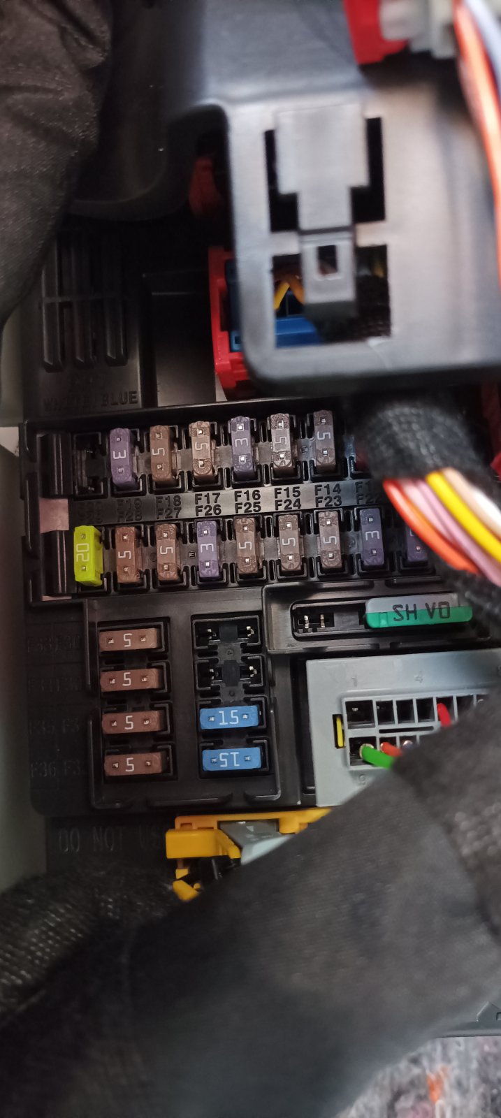

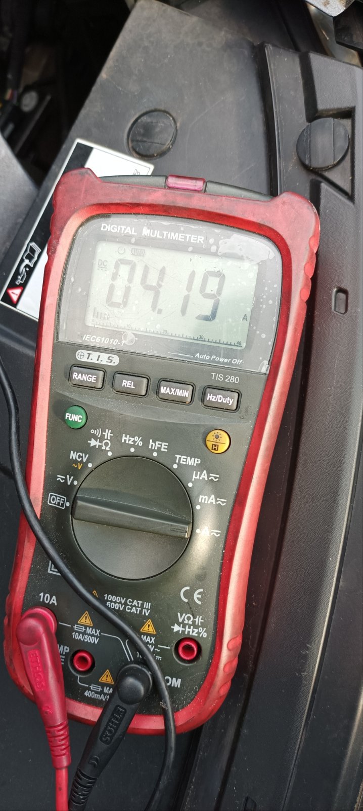

Don't mean to spam the thread but can anyone help with this type of fusebox? I can't find a layout diagram for it. Should I remove the plugs as well?
Also, this is the readout that I'm getting, 4amps right? I've tried as many fuses I can get to on that fuse box (which is also the BSI I believe?) but the current stays the same.
I can only find a fusebox behind the glovebox and the the one next to the battery. With the later, is it worth removing the larger plugs, relays right?
Lastly, do I need to do a BSI reset each time I want to try and find the parasitic drain?
Any help would be super appreciated.

No, you only need to use a BSI Reset / Battery Disconnect / Reconnect Procedure if you're planning to remove the battery or actually want to reset the BSI.
Be very careful around the BSI as this is the main computer and there are a lot of connections here to all the other systems.

I do have each of those features you mention but 4A seems like a lot does it not? When I read that 50mA is more usual for a regular drain.

- x 6957
Re: C4 grand spacetourer tailgate issue/battery drain
These are the units with fuses - some will surround the BSI, others in the engine bay area.
BSI: Built-in systems interface
PSF1: Engine compartment fusebox panel
BCP3: Relay 3 protection switch unit
BPGA: Electrical supplies protection and management unit
BFH5: Passenger compartment 5-fuse box /
BMF4: Maxi fuse unit
BFH3: Cabin relay fusebox 1
BFRM: Engine fuse and relay box

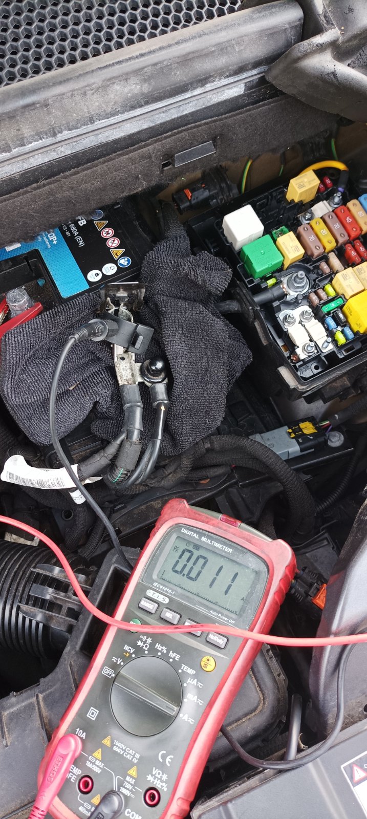

So a bit of 'development'. I retried checking for a draw on the battery however, this time I left the meter connected using crocodile clips. Immediately after closing the door the meter showed 4amps, but after a minute or so I could hear the clicking off of electrics. Slowly but surely, the number went down to 3amps then 1.6amps. then it settled at 0.011amps.
I guess when I was doing it yesterday, I was only seeing the reading when I closed the circuit with the multimeter and things were still awake. Is that right/make sense?
Not sure if I've been chasing a ghost or not here, you did warn me! I did notice when pulling out fuse F7 - 70amps, the reading went down to zero. Not sure what that fuse is for?!

This is what happens when we do a BSI reset and why the timings are so important. In order for the data networks to go to sleep, especially the RCD circuit, we have to ensure all the doors are closed and wait for the BSI to shut everything down. Until this happens, some networks are active, monitoring the doors and other kit in anticipation that the car is going to be started, so they won't shut down and of course this is drawing power.

So checked voltage this morning. Initially I was disappointed when I booked up the multimeter as the voltage was 12.25v. But I remembered that it would have dropped when I unlocked and opened the door to pop the bonnet.
After a little while the voltage climbed steadily up to 12.68v. so I think I'm all good right?!
I'll still need to put the glove box back together and reconnect the glove box light and footwell light but I'll check again after I've done that to make sure those aren't an issue.

That's correct - you're getting it now and haven't lost the plot!
