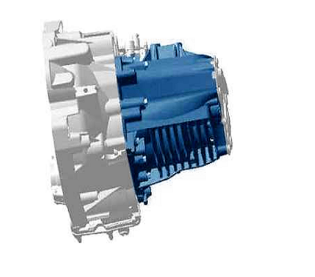

If you have the ML6C Gearbox with fins it will look like this:
For this vehicle:
| ML6C | Gearbox casing without fins | Gearbox casing with flanges |
| Drain and refill | 2,6 litres | 1,9 litres |
| After overhaul | 2,8 litres | 2,2 litres |

Main changes of the revised ML6C gearbox with fins on this model:
- Ribbed gearbox casing for improvement of the lubrication and lowering of the oil temperature
- Discontinuation of the output shaft greasing filler tube
- Reduction of the oil capacity
- Engraving of the oil capacity below the sequence number on the differential housing (From 21/03/2006)

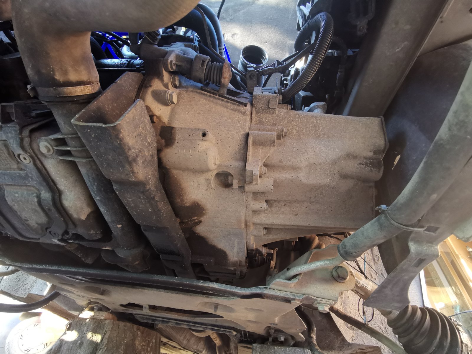

Hello,
Pretty hard to come by the gearbox oil spec and quantity….
Looks like my 59 plate C5, 6 speed manual has this ML6C WITH fins, is that expected from VIN VF7**************[VIN obfuscated, can be read by forum staff] ?
And does it still need the GL4 spec oil ? Opie oils, GSF etc are pointing to GL5….
Car has 103 k miles on it. There is a light transmission wine, dependant on road speed and throttle.
Gearbox oil change seems like first thing to do… look for metal particles, get the level right etc…
Hope this isn’t too much of a derail of thread, delete if it is and I’ll look for more appropriate thread.

bumpy001
- Posts: 9
- Joined: 08 Sep 2023, 09:01
Re: Gearbox oil for Citroen C5 II HDi 138 , 6 speed manual.
Hi Andy,
Thanks for that.
I hadn’t considered adding a magnet, good idea if I can make it happen.
Regarding quantity, I don’t know if it is filled to right level, might have leaked some and it’s had a drive shaft boot changed at some time so who knows . No harm in measuring what comes out of course but I would like to refill with correct quantity (dunno if there’s a level plug, I will look).
Oil classification, you and I agree, just need an expert to agree as well, then I can ignore what the stores want to sell to me and buy the right one.
