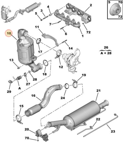

If you can keep all future parts requests in the official thread that will help me avoid missing requests:
viewtopic.php?t=69962
(10) Catalytic Converter, part: 9823467180, £1,094.90
Note that on this vehicle the Particle filter is not contained within the CAT assembly, but separately further down the vehicle shown at (21).
I have to say that this would be the first I've heard of the Cat going in such a relatively recent vehicle.... or many others for that matter, so I think you're barking up the wrong tree, but any or all fault codes really are essential.

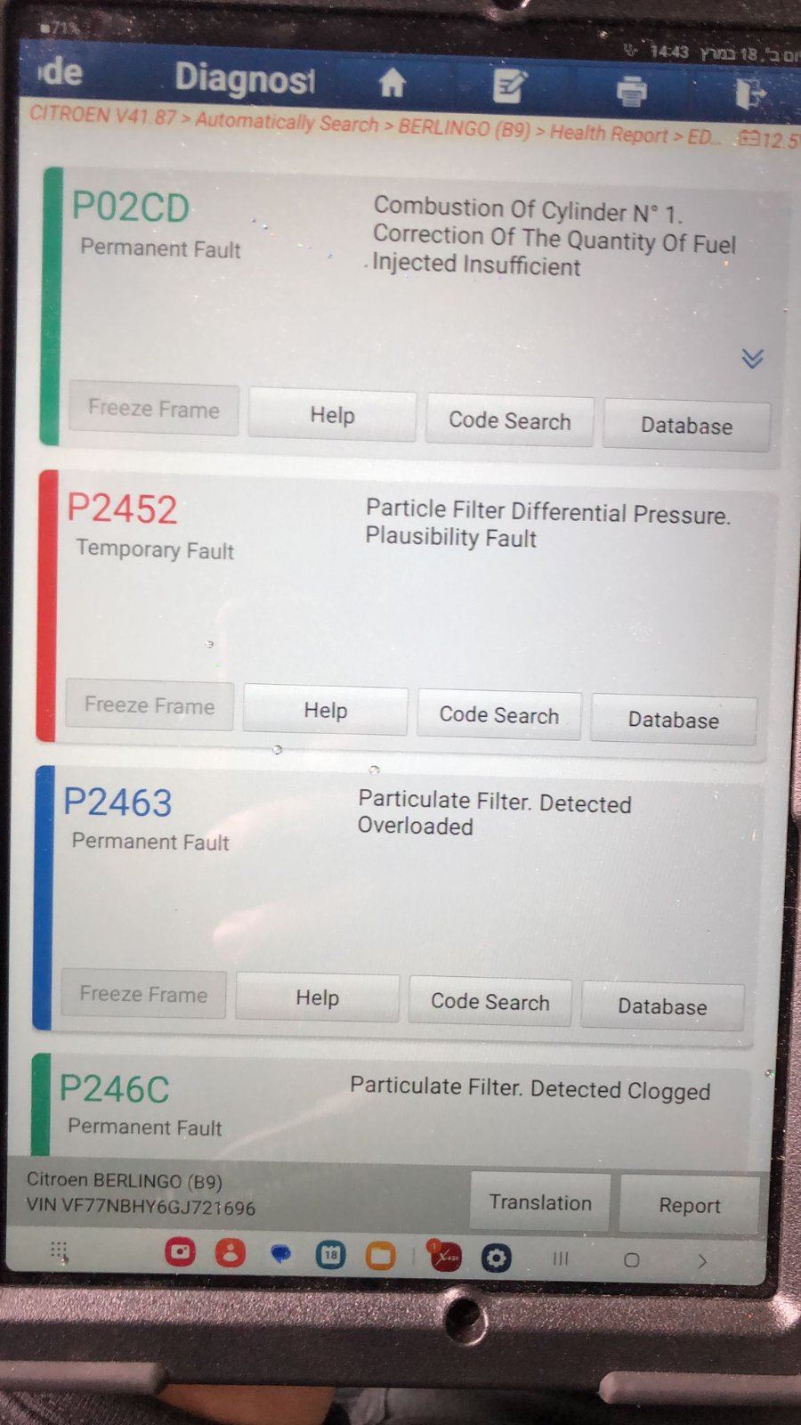

Re: Risk of filter clogging
These are the fault codes attached.
- x 6957
The presence of fault code: P2452 may require an update of the engine management software.
The other faults refer to clogging of the particle filter, so nothing here to do with the catalytic converter. Your particle filter is inside item 21 in the previous diagram. How many miles has the vehicle done and are the normal journeys short stop and start journeys? If so, these may be prohibiting the regeneration of the particle filter, or the regeneration process may be getting constantly interrupted. So it may be the particle filter is one issue, but your engine problem and speed limitation will be due the problem with No 1 injector.

cncjeff1
- Posts: 22
- Joined: 11 Jul 2022, 10:18
- x 2
The engine management software update is strictly a dealer activity, correct?
The vehicle has almost 190,000km on the clock. Typical journey is 10-20 minutes city driving to reach the highway, then 60-150 km highway driving at speeds of 110-130 kph, followed by another 10 minutes of local driving, followed by 2 hours parked, and then the whole thing in reverse. I drive very little in the city.
Could the particle filter issue be the cause of the #1 injector problem?
What is the part number for #21 that contains the particle filter?
Shouldn't a minimum of 30 minutes driving at 100-130 kph, be enough to complete the regeneration?
Should I be changing the #1 injector, or be checking something related to it?
- x 6957
Yes, practically a dealer job. At that mileage. your DPF is certainly near end of service life, so needs a deep clean or replacing.
No, the DPF has nothing to do with the injector fuel supply - this is a separate issue.
Remember the particle filter burns off the particulate matter (soot) and converts this to ash. Over time the ash which cannot be further burned will clog the filter, along with the Cerine deposits that cannot be burned off.
New OEM Particle Filter, part: 9810717180, £883.85
Exchange Particle Filter, part: 1616515180, £600.19
