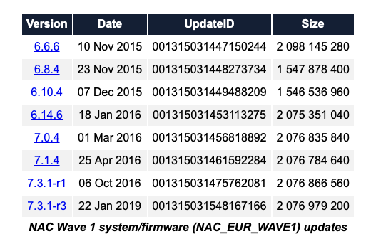

It may be the initial firmware update that's the issue. As a last shot, this is the firmware that is one version ahead of the one you have:
Firmware V7.1.4
May be worth a go just to see if it wants this before it will update to a later version.
Firmware V7.1.4

Many have tried to upgrade the software (firmware) on NAC Wave1 but sadly to no avail.
1) Head unit in question here is also NAC Wave1 which only supports CarPlay. For both CarPlay and AndroidAuto, you'd need next hardware version; NAC Wave2 (end of 2016 - 2018).
2) Both sw versions for Wave1 (7.3.1-r1 and 7.3.1-r3) have expired credentials by manufacturer (Continental) so no matter how you prepare the sw upgrade files (through Desktop aplication or by manually download and transfer to USB pen drive) it just won't work in the car and user will face a message like "software incompatible with hardware". Even a dealership garage will get the same message as on the Stellantis servers's side that upgrade doesn't go through - due to said expired credentials.
My guess is that Continental doesn't bother to renew those credentials as NAC Wave1 is present in roughly 6-7% of Stellantis vehicles and they actually leave it as it is (obsolete).
Even Wave2 had several months of expired credentials back in 2023, but it's the mostly spread infotainment system in Stellantis vehicles (over 35%) so they fixed it after a few months of halt and it bacame "ugradable" again. Wave 3 and 4 don't seem to have faced this issue (yet).
3) Software 7.1.4 for W1 won't help either as it's older than the current Paul's version (7.3.1-rx). NAC can't be downgraded with earlier sw and even if it could - I suppose we would face expired credentials again.
