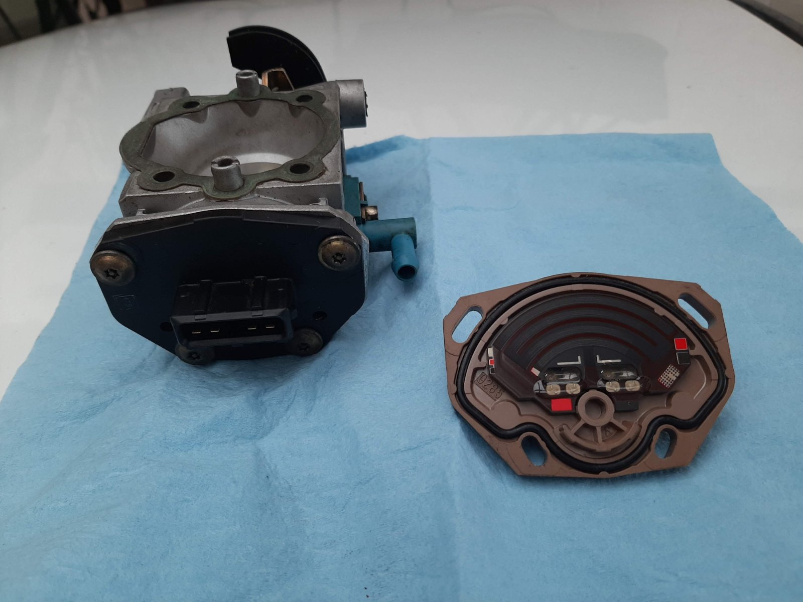

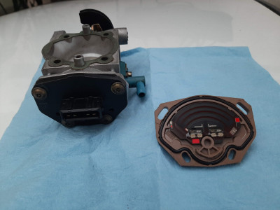

I'm slowly homing in on the idling issue. I have replaced the damaged loom connector for the TPS but that did not help matters at all. I managed to source a used throttle body which came complete with TPS and Idle Control Stepper Motor. I swapped out the stepper motor and this has improved things but it is still not 100%. There is still the occasional dip in idle revs and it did cut out once the other day. I still think the TPS is acting up; when the car is idling (usually when cold) the engine light comes on for a few seconds. If I press the throttle pedal slightly, the light goes out immediately. However, before I swap out the throttle body, I want to ask the forum if there is supposed to be a gasket fitted between it and its mounting bracket. The Haynes manual suggests there ought to be and I remember seeing an imprint of what looked to be a gasket when I lifted the throttle body for cleaning. So, should there be a gasket? If so, can someone please point me to where I can purchase one? If it comes to it, I can get some gasket paper and make on if they're no longer easily available.
Regards
RobC

Re: 1998 106 1.1 Zest 3 Idling Issues
I can't be 100% sure Rob but I'd think there would be a gasket.
It's not going to be a very complex one and making one from a sheet of gasket paper should be absolutely fine...

Update:
For the last two months my 106 has been happily running on its replacement throttle body. Prior to fitting it, I swapped the idle control motors between the old and "new" throttle bodies and it did not fix my issue. That leaves three possible causes: 1) Throttle Position Sensor, 2) Gasket or 3) Injector. As I wanted to get the car running well as soon as possible, I simply fitted the "new" unit and the problems went away immediately. Given the symptoms, I believe the issue was the Throttle Position Sensor although the old gasket didn't look to be in good condition. For a short time, the engine management light would still illuminate when idling but after a few weeks/few hundred miles, this ceased.
So, now the idling/stalling issue has been fixed, it has meant my son has learned to trust the car and has had many driving lessons in it. He is now ready for his test.
Thank you to everyone who helped get me to this resolution.
