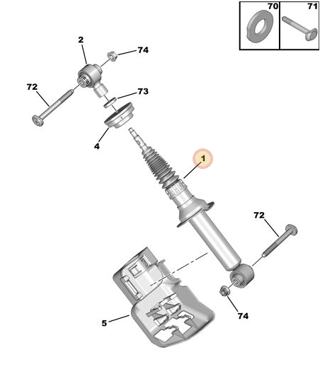

Here you go:
(1) Front Suspension Damper, part: 9837905080, £99.48 each
(1) Rear Suspension Damper, part: 9837905280, £97.32 each
Please also note, there is an outstanding after-sales campaign being flagged up from 11/01/2023 . There are no details shown as to what it is for, but give DS a call and quote the JNJ reference with your reg and they'll be able to advise.

That's brilliant mate, fantastic, and thanks for looking at it straight away.
I was aware of a recall campaign on the front bumper just below the bonnet. Mine was ever so slightly loose. I did expect it could be reaffixed but the DS dealer said the whole thing needed replacing, it's in at the dealers at the moment having the work done. However to double check I have just spent 20 mins on the phone to DS customer care, and provided my VIN to establish 100% the after sales campaign was for the same thing. It is. So that's cleared up.
Many thanks for the part numbers. I have done google searches on them and just a few european websites come up. Have you any idea how to find suitable OEM alternatives?
