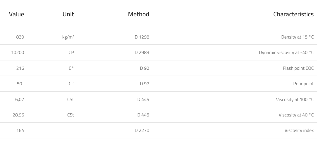

Yes, that i already do know, its a 2012 508 163hp. Its the JWS 3324 i need. Just wanted to check, if you have any opinions on that particular oil
https://www.mannol.de/create-pdf/270/en
- x 6955
Re: Aisin Tf-80 / AM6 Oil Change Questions (Mini-Guide Page 4)
We only recommend the official oil, but as long as it meets the specific requirements for the gearbox and Euro standards you should be ok.

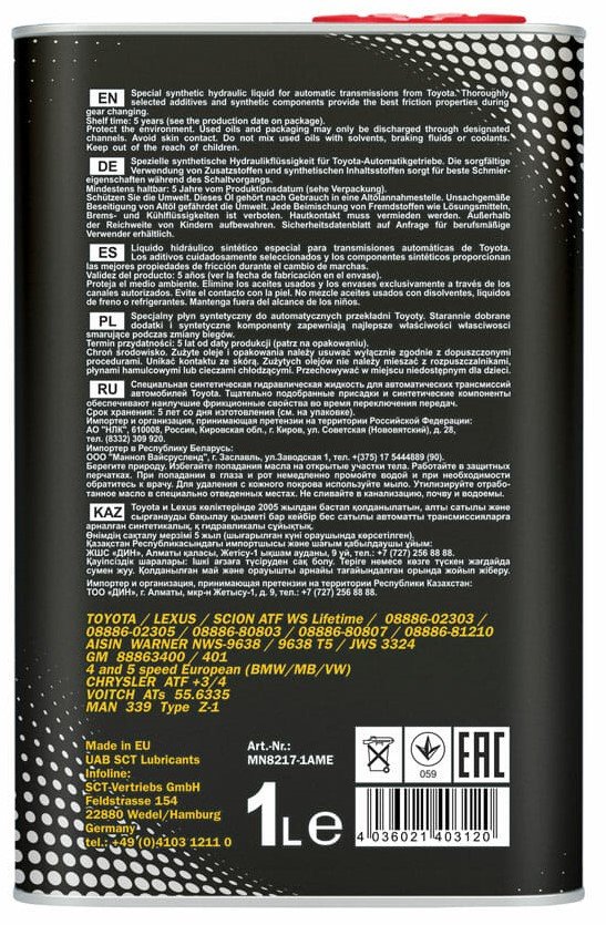

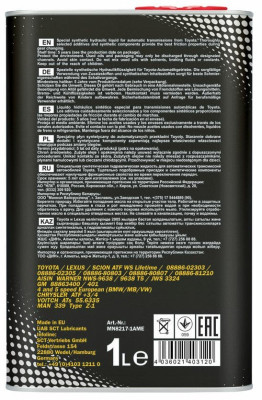

Hi
is it ok to use this oil "ATF WS Lifetime" specs are shown in the images
my vin code is VF3**************[VIN obfuscated, can be read by forum staff]
I've only just seen this post, a bit late for a reply but the same for you JWS 3324 Oil for this gearbox.Mostafa Mahmoud wrote: 09 Jun 2024, 08:24 Hi

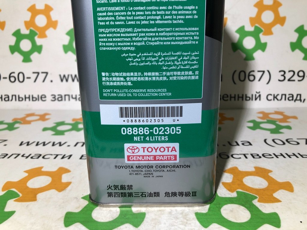

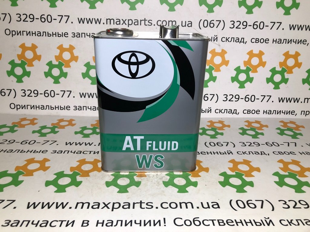

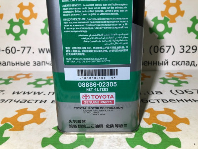

Hello everyone! I have a Citroen C5, 2012, 2.2 liter engine, station wagon, diesel, VIN code VF7**************[VIN obfuscated, can be read by forum staff]. I want to change the oil in the automatic transmission. And the question is - can I use Toyota AT Fluid WS for oil change?
- x 6955
You require JWS 3324 oil, or equivalent to this.
