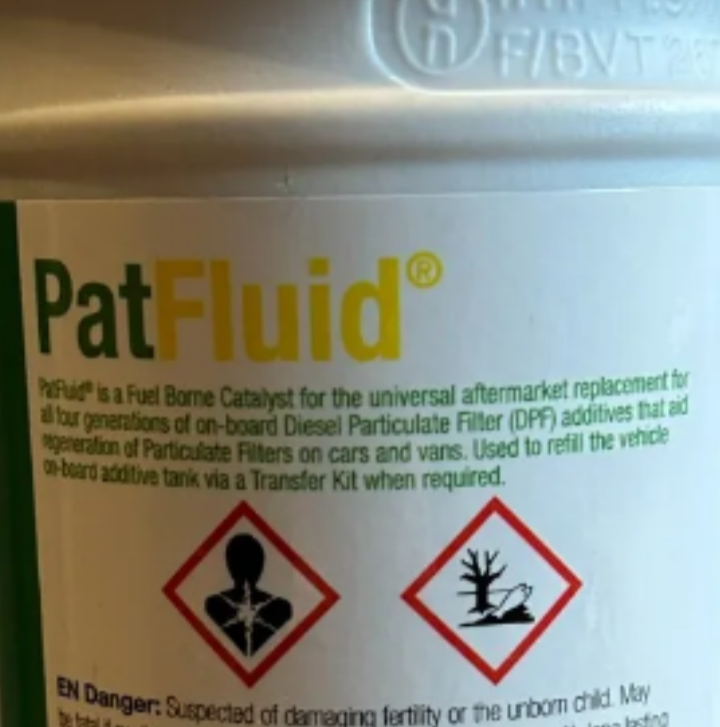

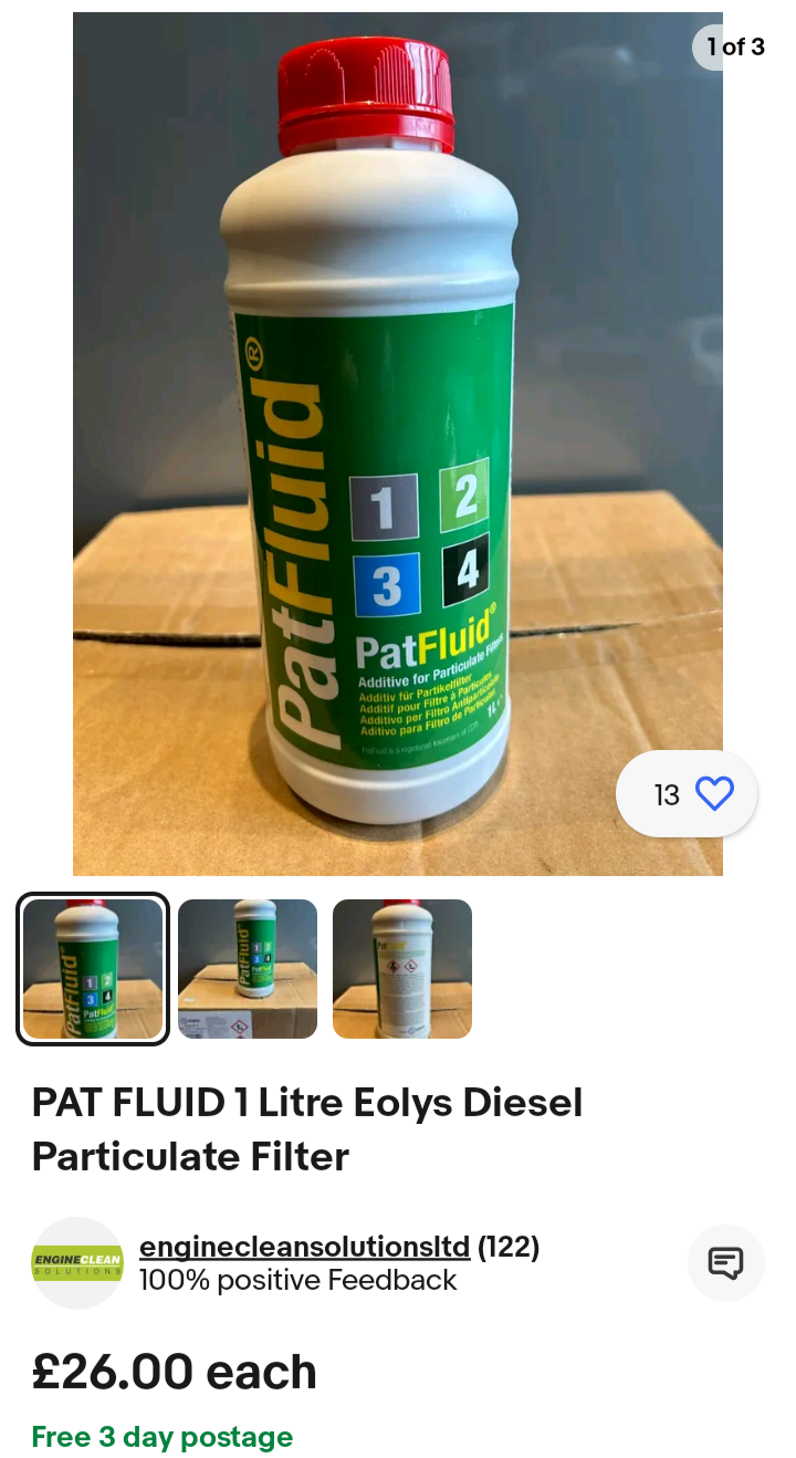

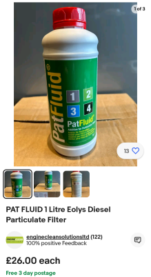

So the DPF adaptive options seem to be:
"PAT Fluid" an aftermarket fluid that claims "compatible with all four types"
my local motor factors (who didn't seem clued up on DPF additives and was pretty sure I wanted Adblue, explained it further and then realised "ah, that green stuff" is what I mean!) £42 per litre bottle!
Eolys Powerflex (i.e. the proper stuff)
eBay £82 for 3 litres Or some mystery stuff in a plain bottle More research needed.
Side note: there's about 3 litres of Pat fluid in the 206's tank. Draining some of that back out to use in the 308 is in the back of my mind too

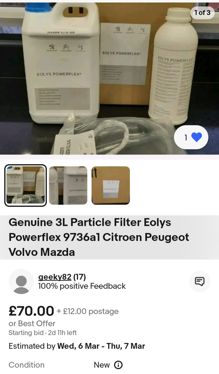

Dealership price:
1Litre 9736A0, £85.01
EBay has genuine stuff for (£55+5 p&p) £60 for a litre:
https://www.ebay.co.uk/itm/196265924724
3 Litre 9736A1. £202.37
eBay has 3 litres:
"Opened but not used" £110+6.95 p&p
https://www.ebay.co.uk/itm/285007300940
Or new for £160
https://www.ebay.co.uk/itm/334953665598
eBay has 3 litres:
Or new for £160

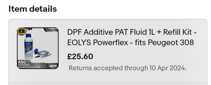

As is my normal mode of operation, much procrastination has occurred, finally this morning I've bought:
A litre of stuff, claims specially compatible with the Eolys Powerflex and comes with filling kit (i.e. a few fuel pipe connectors, length of clear hose and a bottle lid with a hose tail built in)
When I get chance I will seek to remove some of the 206's PatFluid and then the 308 can be topped up to a full tank.

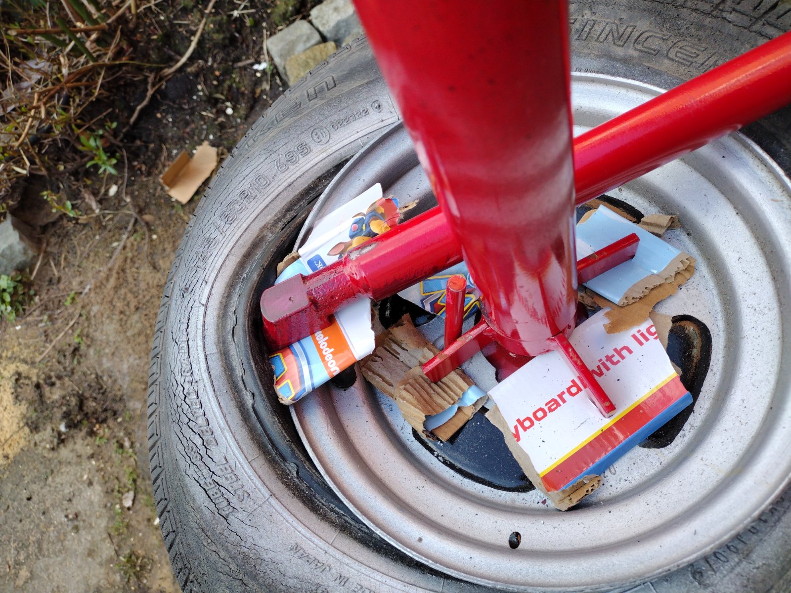

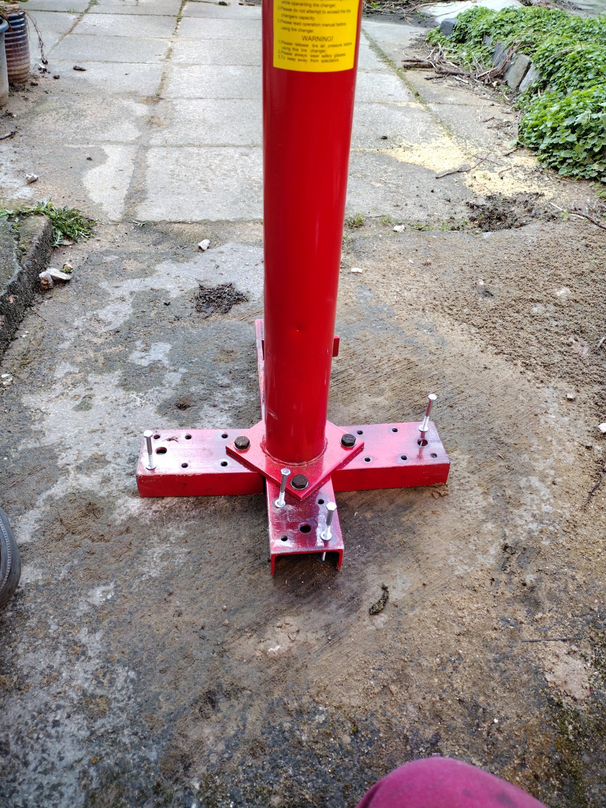

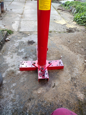

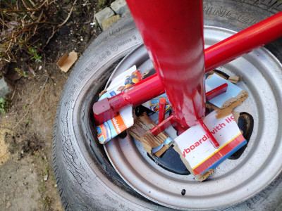

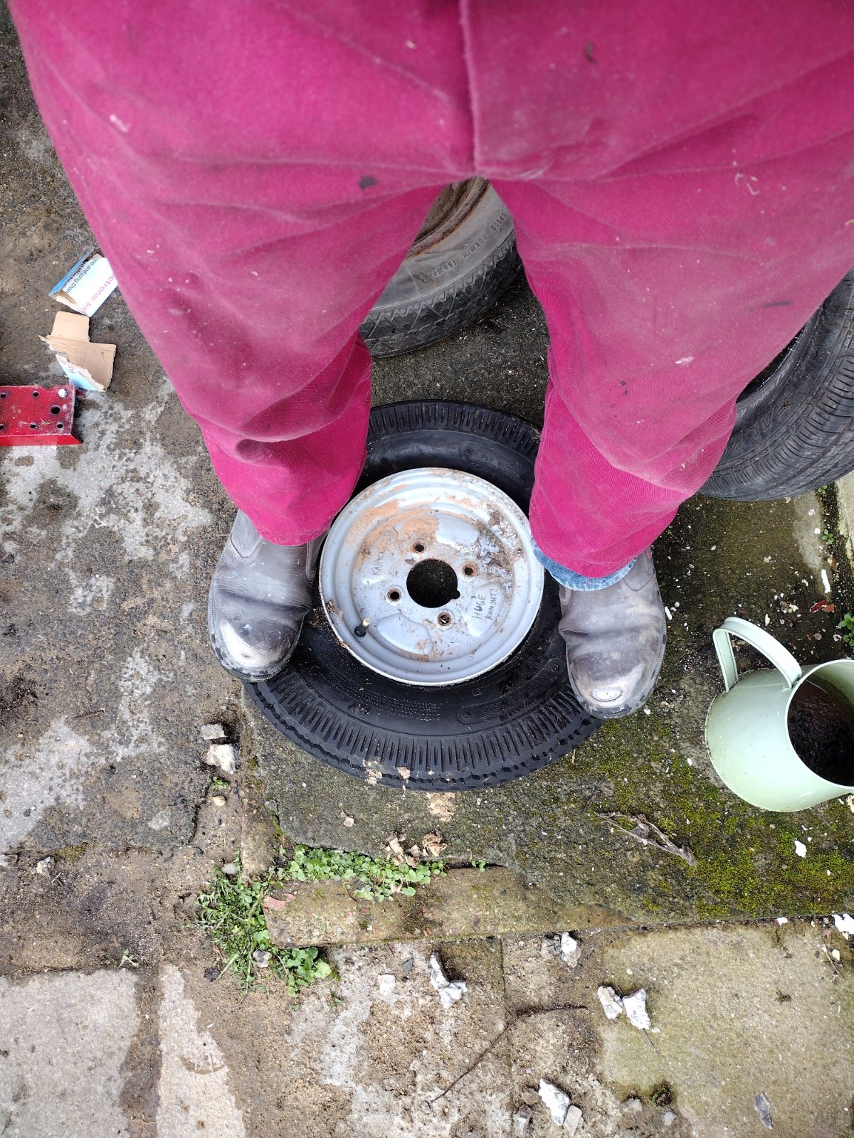

Tyre change machine bolted down and another quick play:
For less well stuck tyres, an alternative bead breaking method: Worked well on the near new trailer tyre. No chance for the 308 spare that's had more than a decade to get settled
