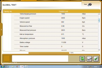

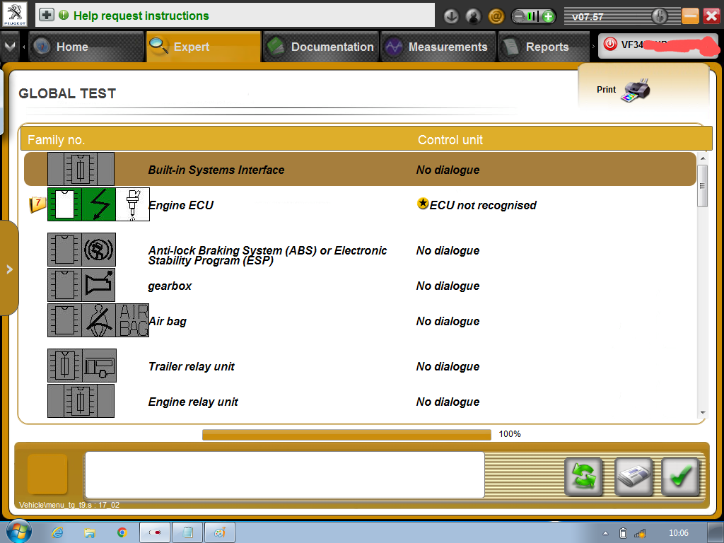

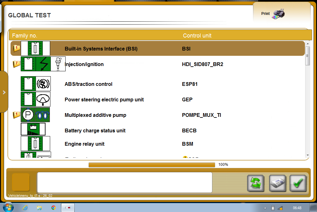

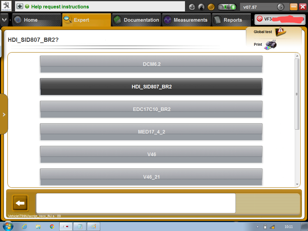

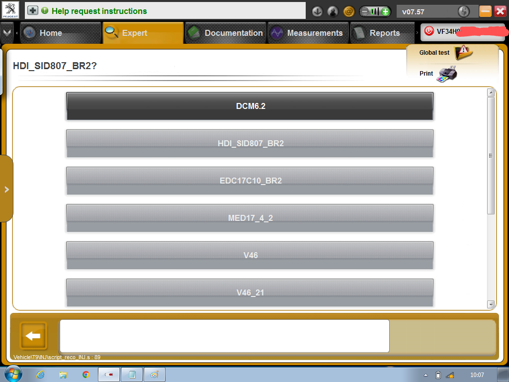

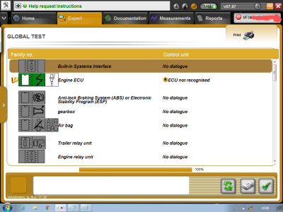

Brief 308 SW update, plugged it in this morning:
It did not automatically populate the VIN number, so I must have done something differently??
Typed the VIN (from the sticker in driver's doorway, the under bonnet VIN is well hidden! There's no front cross member above the radiator (well, only a plastic piece) - Google tells me it's near the expansion tank where I thought I had looked but didn't spot it)

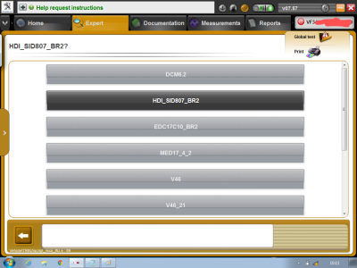

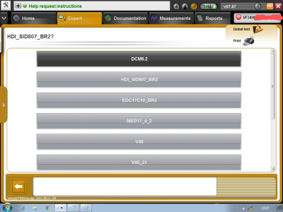

Then it was a little odd and needed me to choose which ECU was fitted?? Not had that on other cars before.

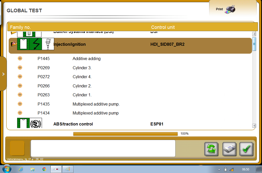

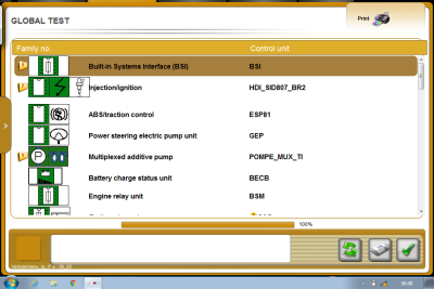

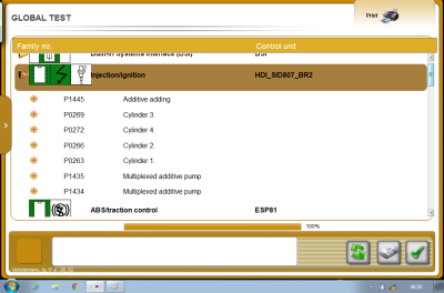

List of faults.

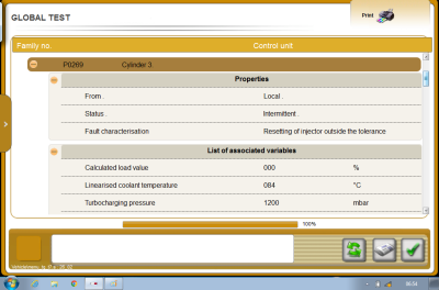

Though, under each it said "the error details might not be applicable if the wrong ECU type is selected" or words to that effect. Hmmmm.
Additive system (makes sense with relationship to the "risk of blocking" message) but not sure why it's thinks an issue with all 4 injectors.

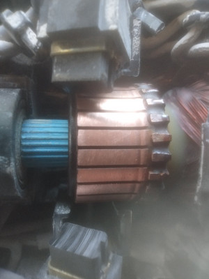

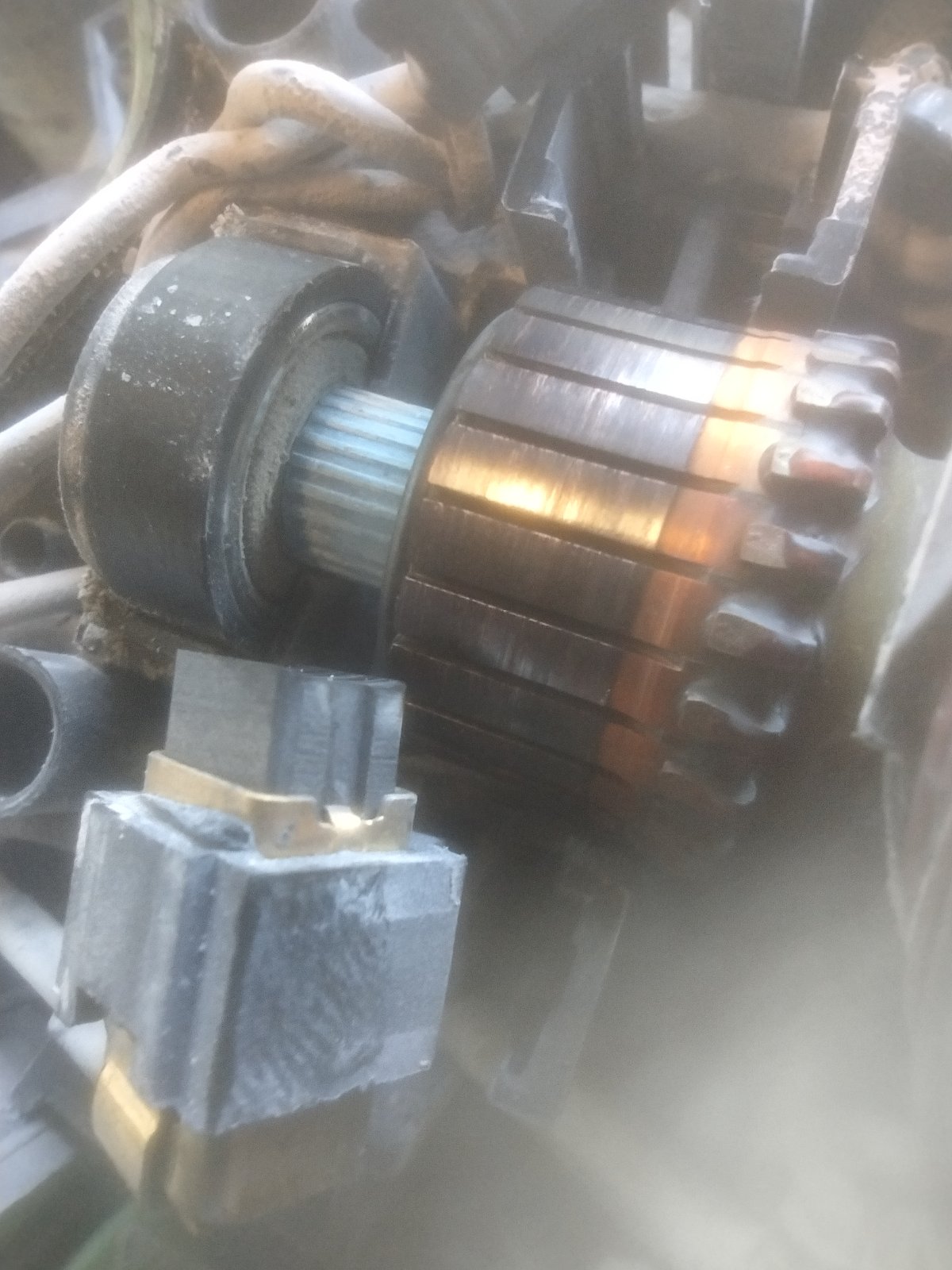

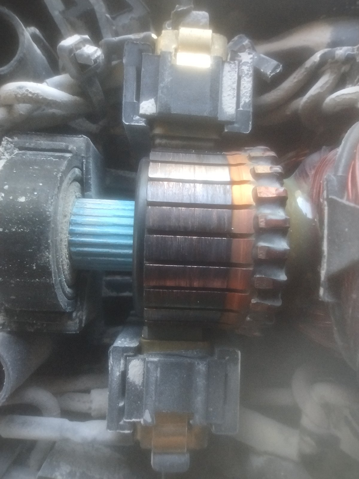

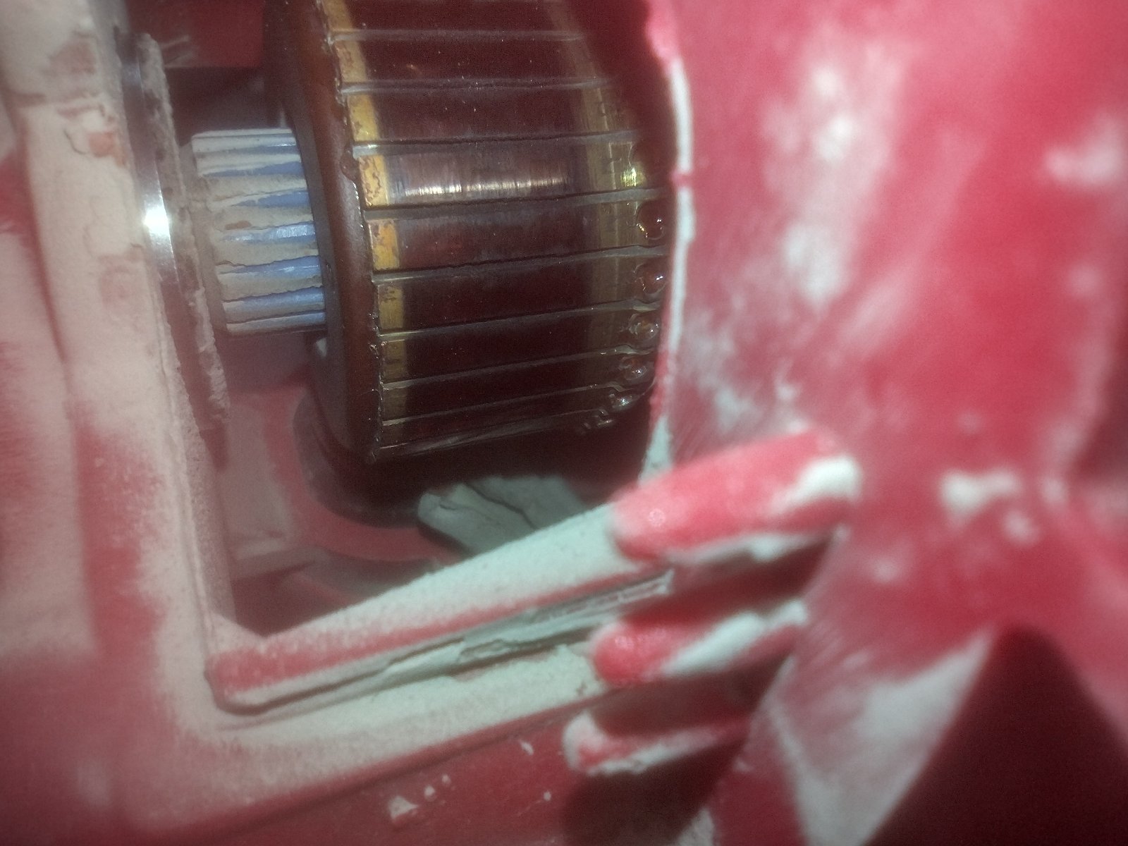

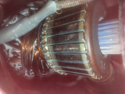

A drill fixing update, next!

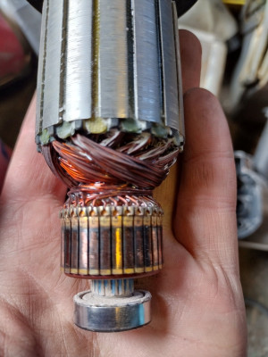

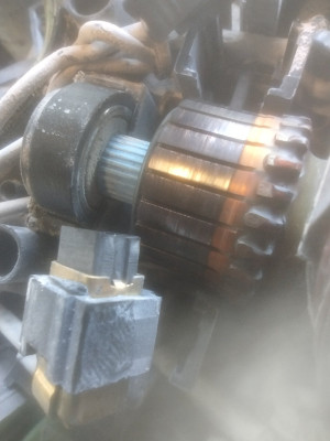

New bearing arrived, now installed
Bearing
Bearing
Bearing
Bearing

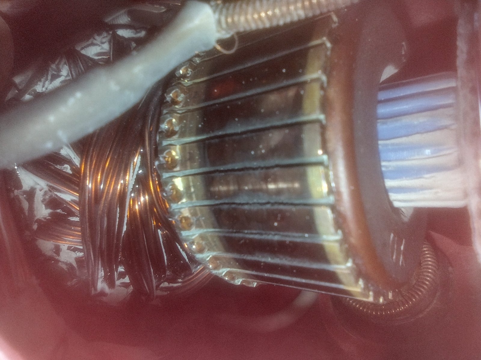

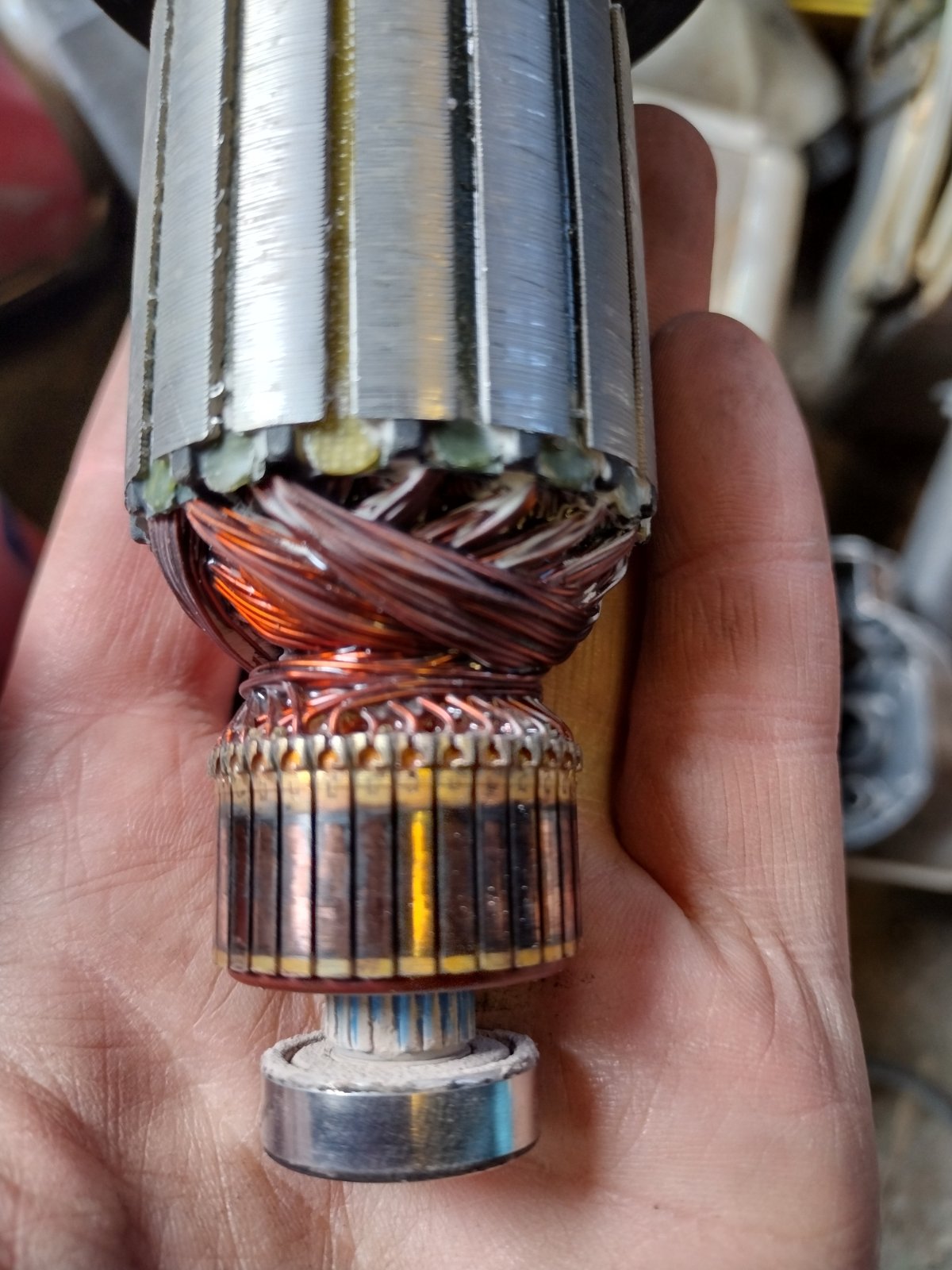

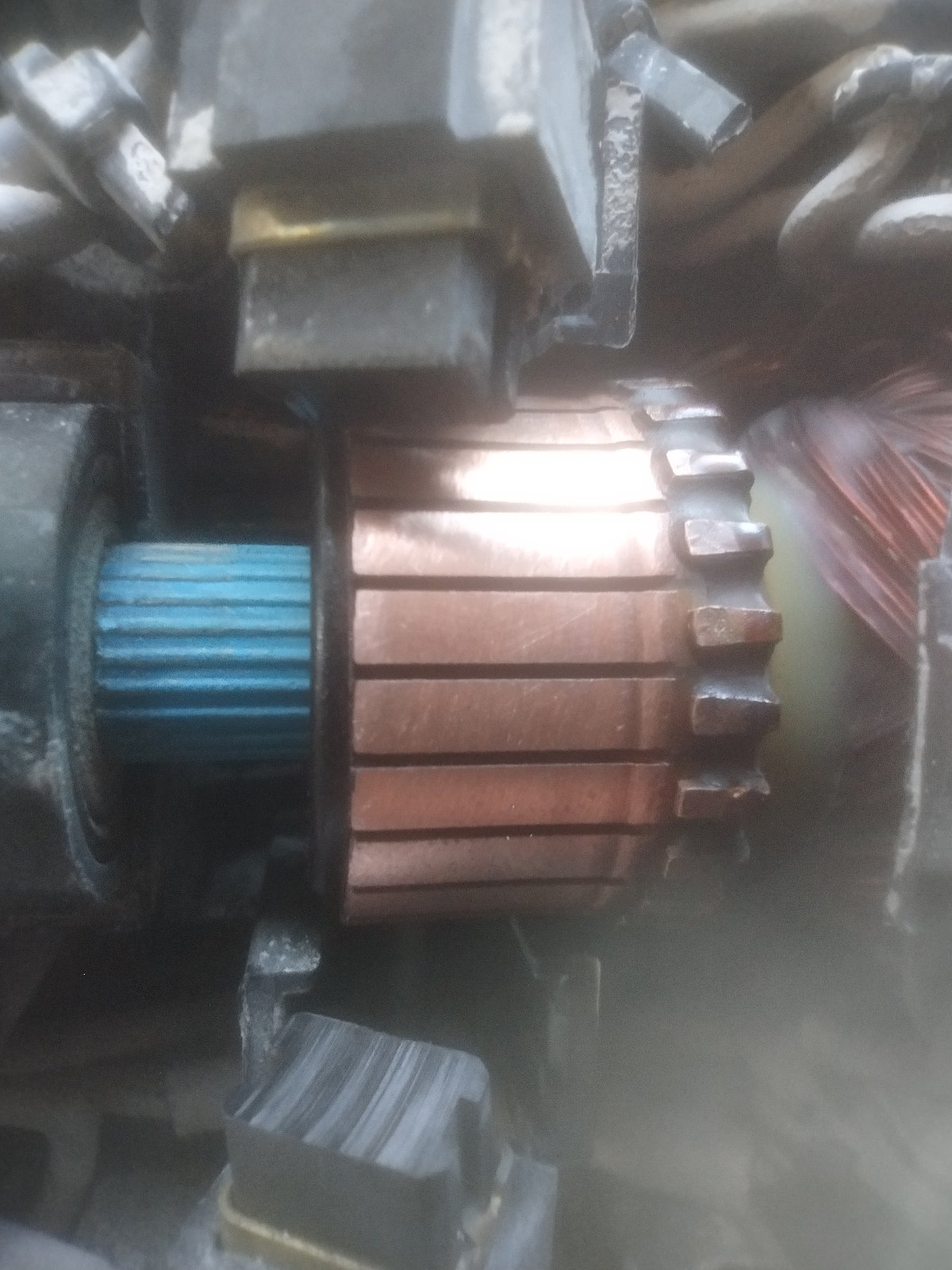

Commutator pretty horrible, cleaned up (240 grit then 600 grit)
Commutator
Commutator
'tator
'tator
Cleaner:
Better
Better

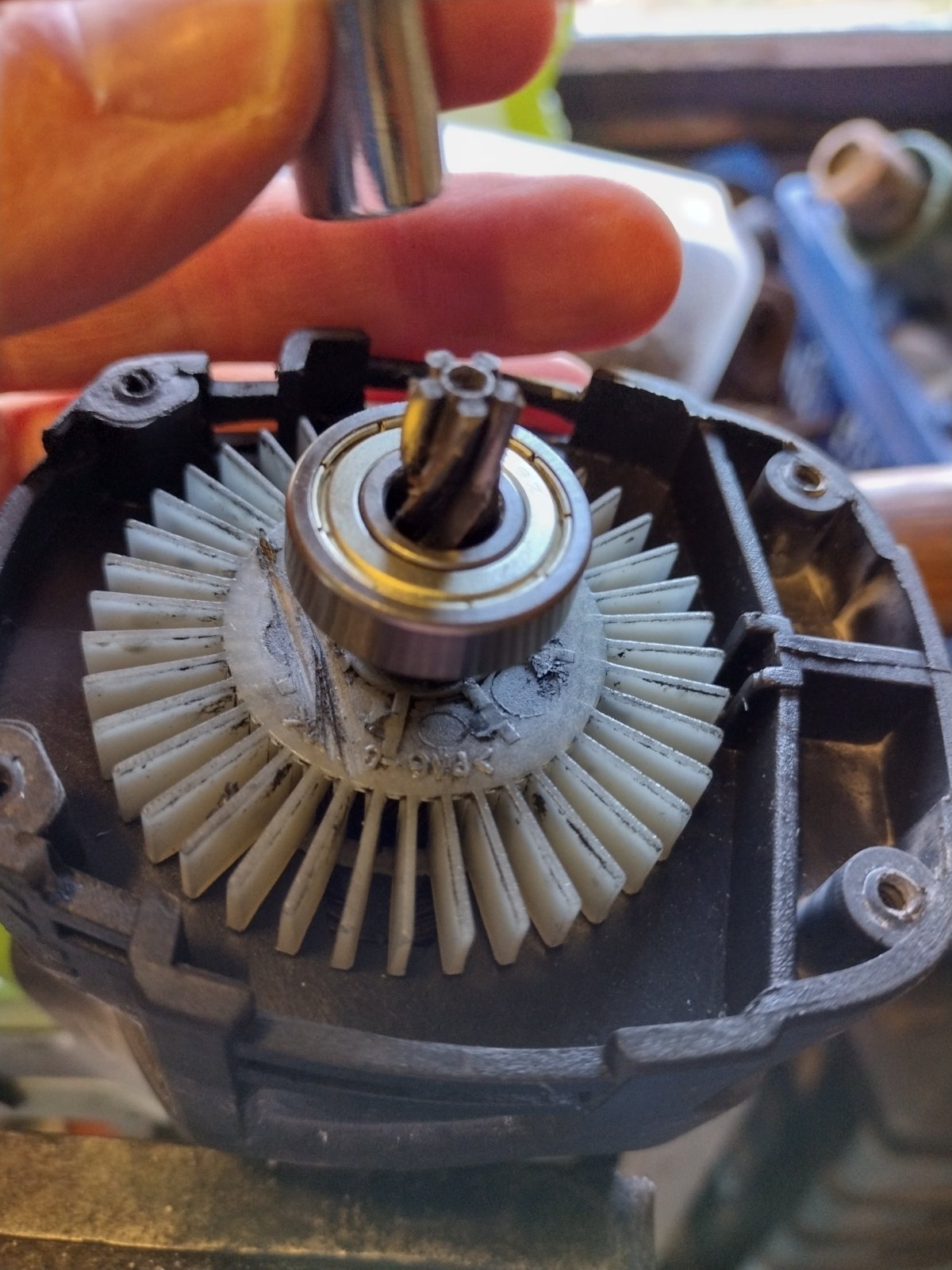

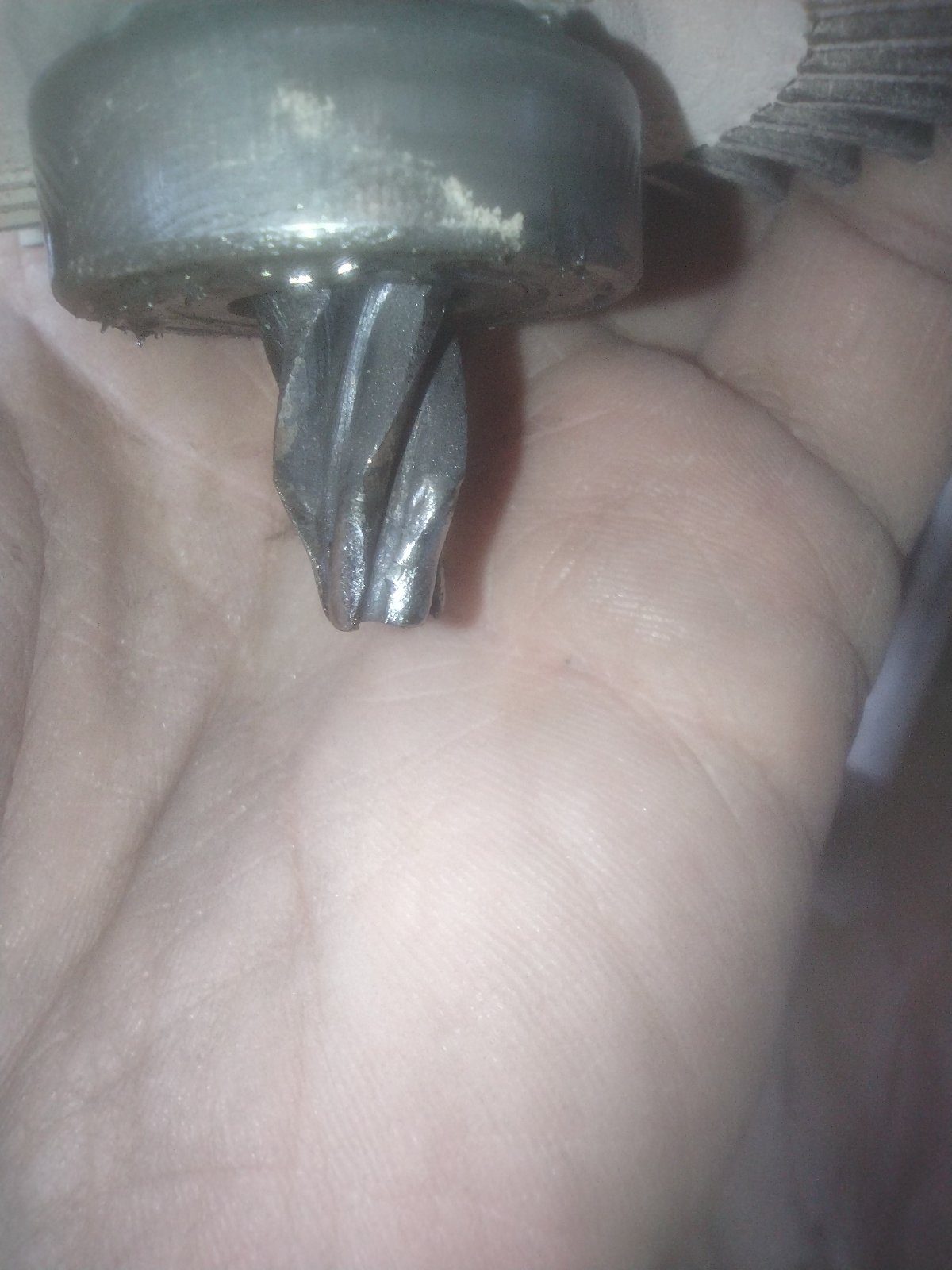

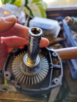

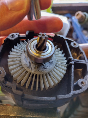

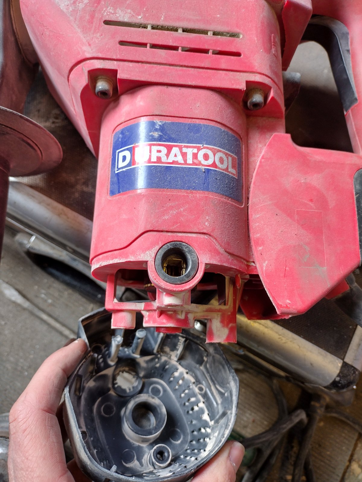

Then flushed with success, I did the same job again on the bigger drill:

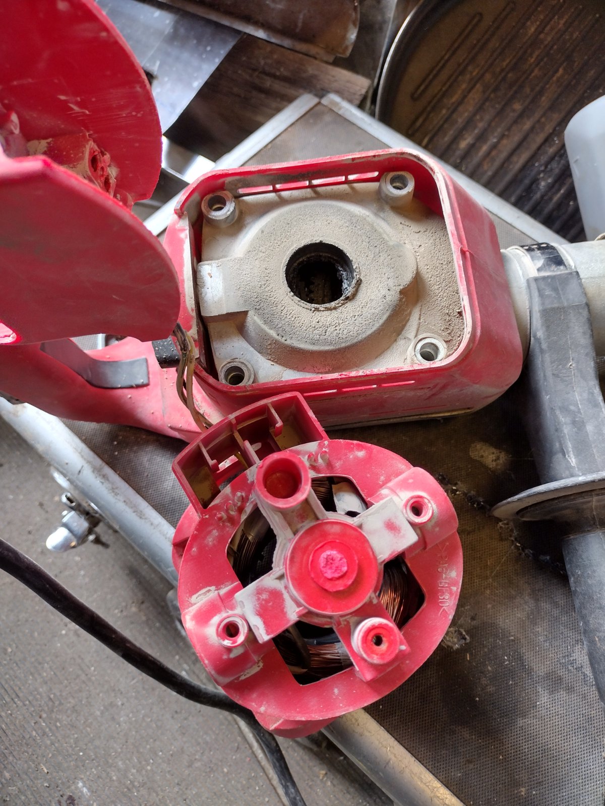

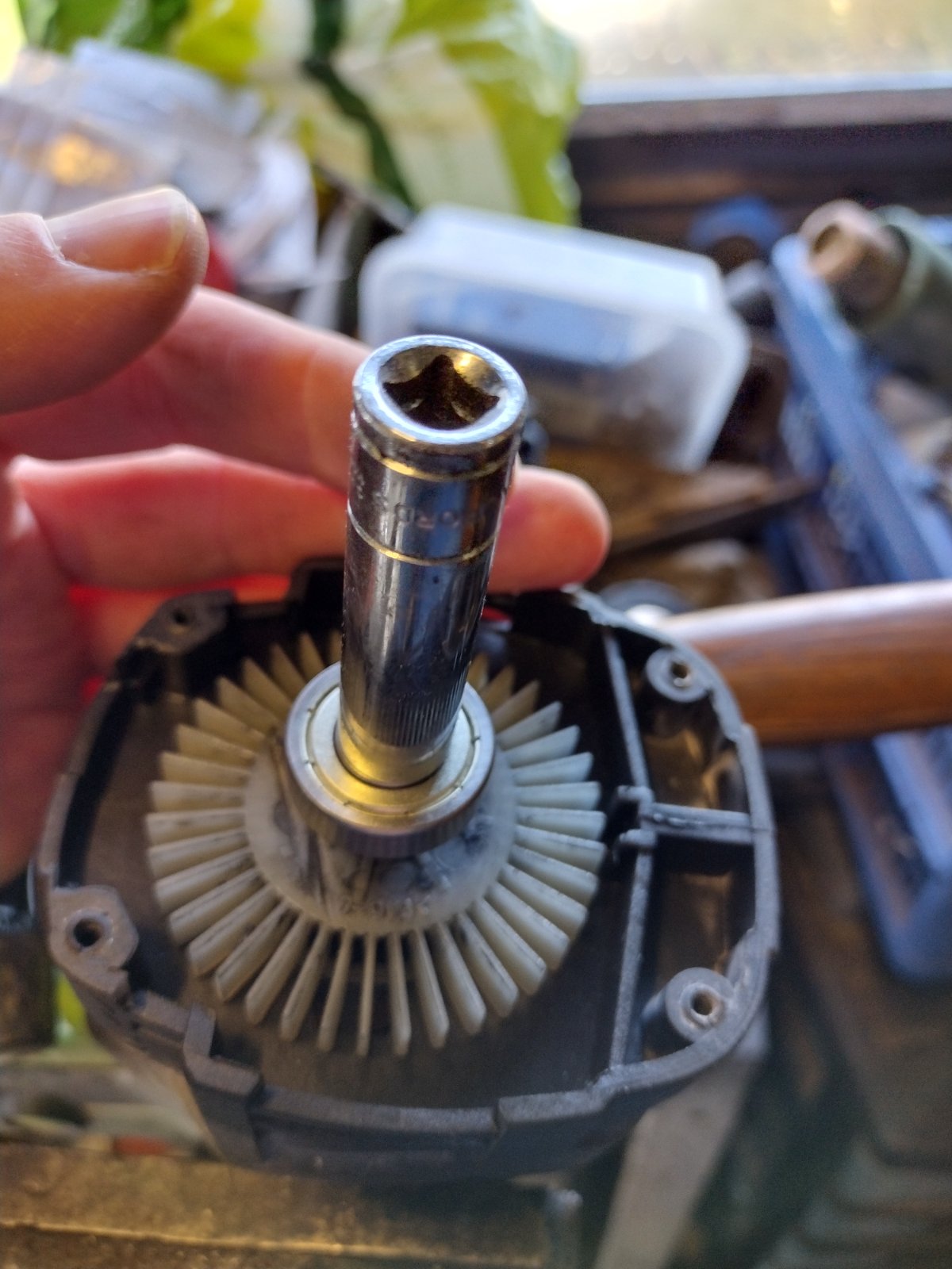

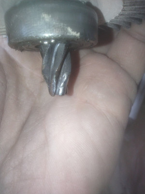

However, it seems there's a pretty significant failure not far off at the other end of the motor shaft:
Toothless wonder
Toothless wonder
Oh dear!
I've seen that on a Berlingo I put my Diagbox on a while back Matt... It does seem odd that it can't work it out for itself which is which?
I eyeballed the actual ECU to ensure I was looking at the right one.

308 DiagBox= I realised on the main screen I had clicked "308(T9)" whereas this facelift is still original 308. So have clicked that this morning and now it auto recognizes the VIN.
Just doing a second quick scan

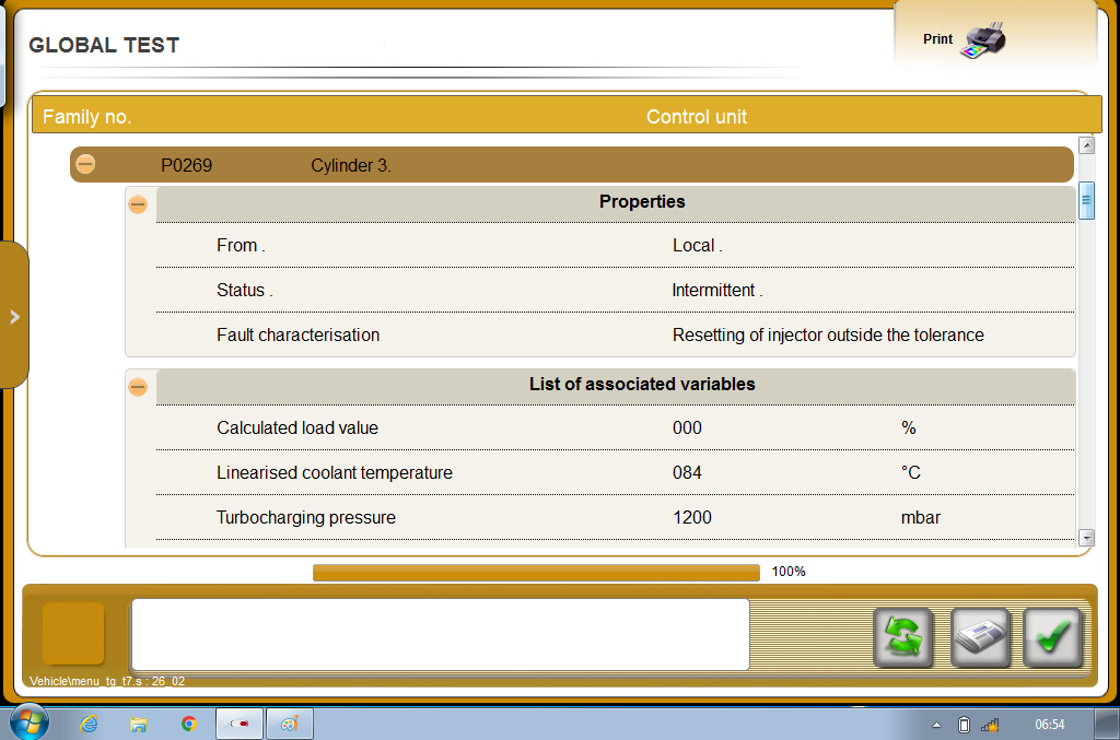

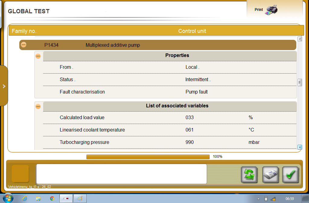

Unread post by MattBLancs »

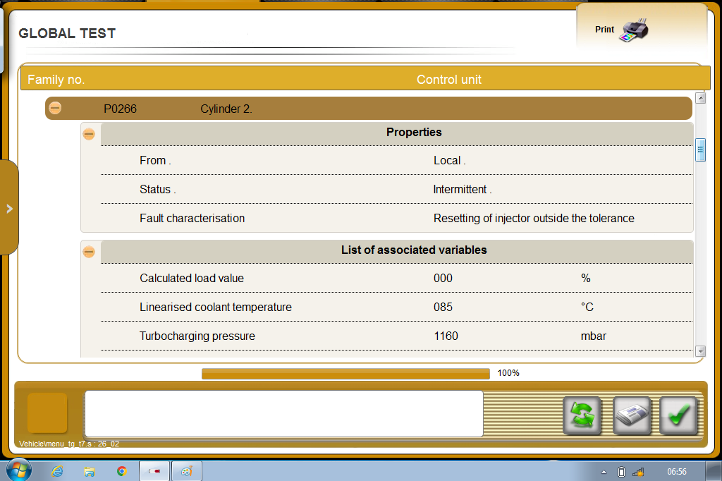

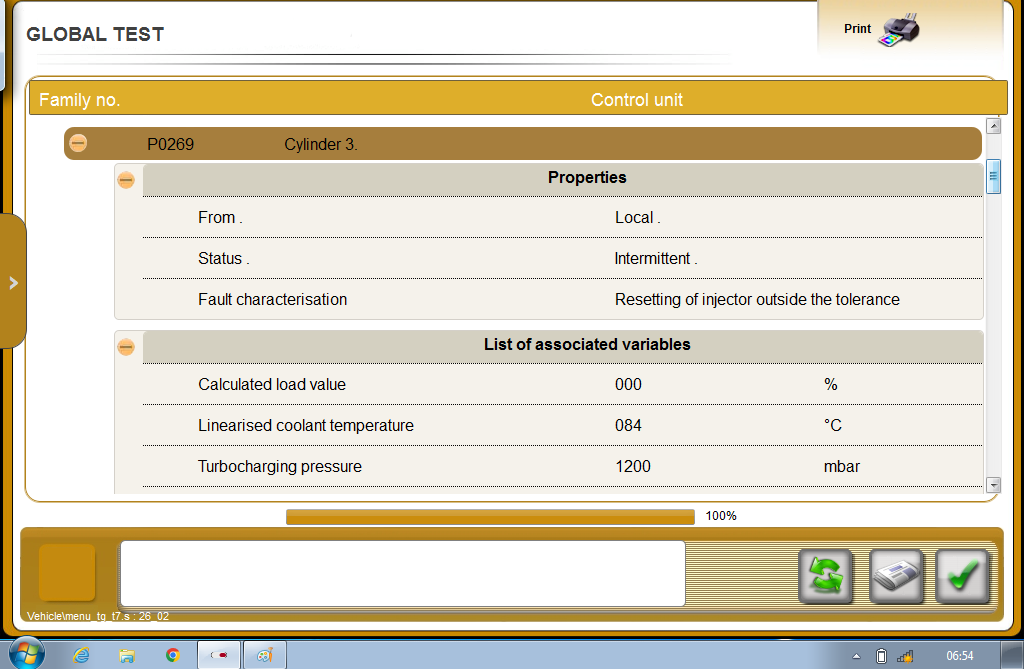

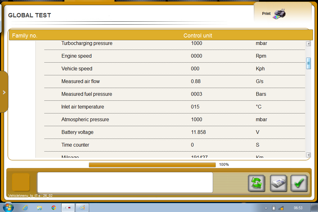

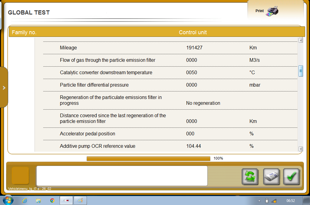

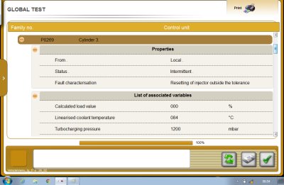

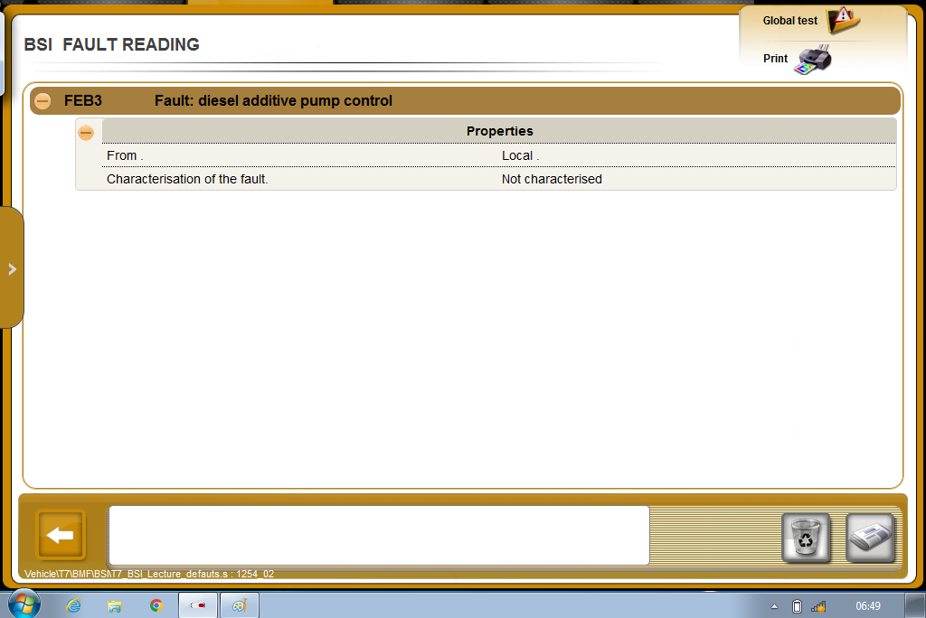

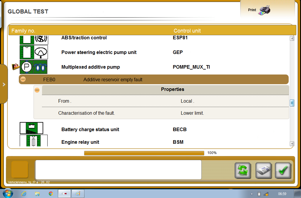

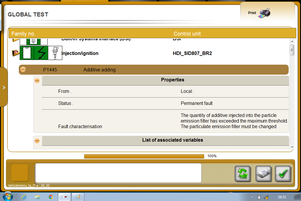

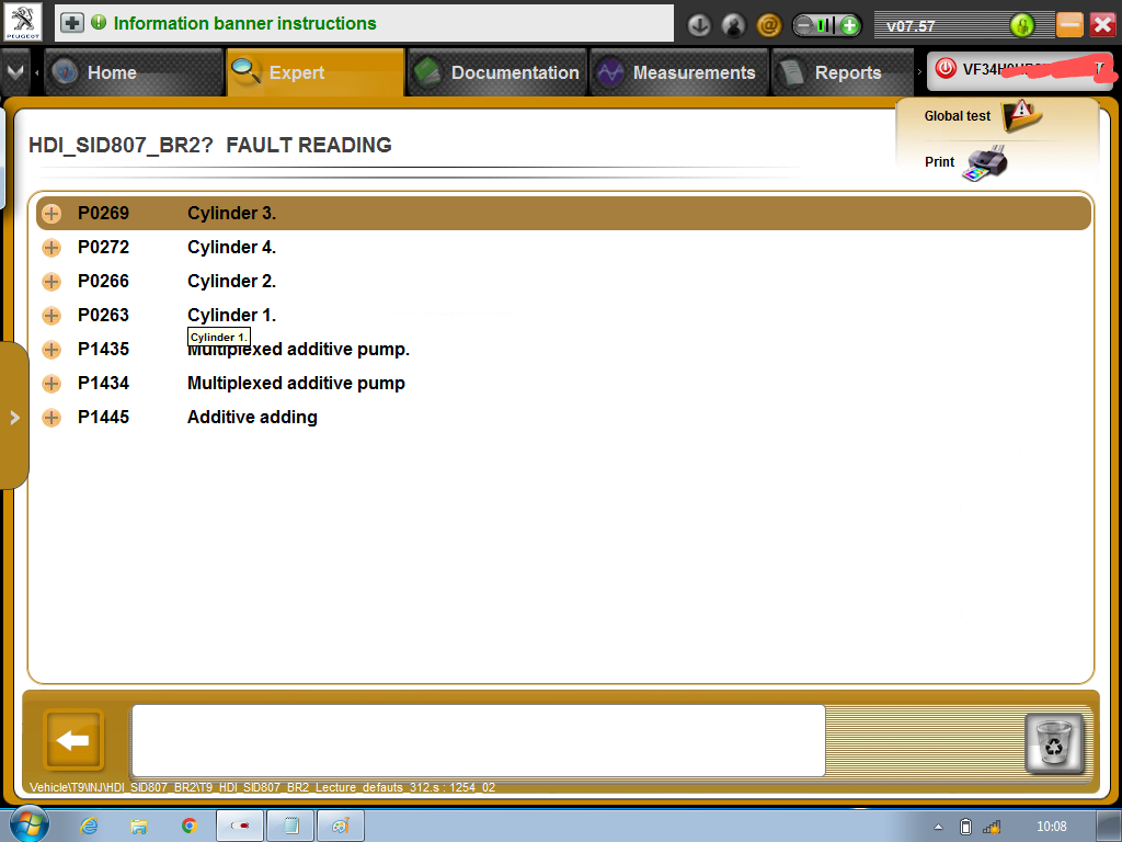

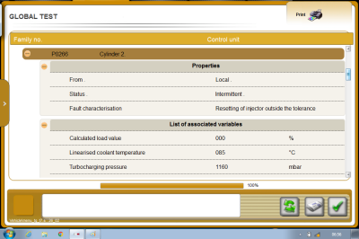

Quick drop of the screenshots collected, will add to later

Oh gosh Matt... Hard to tell just what's going on there...
Top up the tank, reset the counter and try a forced regeneration perhaps?
Posts: 5342
Joined: 25 Apr 2022, 09:03
x 2356
CitroJim wrote: 27 Feb 2024, 08:30 Oh gosh Matt... Hard to tell just what's going on there...
Yes a fair list!
Plan as it stands is adaptive top up and code clear, see if it regens itself. I'm not sure what the trigger point is for regen (4 mBar indicated in the results above currently) = will research this.
I've put a request to confirm what's what on the additive fluid front over in the parts list.
Handy cross link for my future use:
viewtopic.php?p=791514#p791514
Feedback from my wife is car ran fine today since the code clearing session this morning.
The not yet departed 206 has a near new DPF and in the the garage is it's original. Potentially get that professionally cleaned as replacement for the 308 = another research topic.
Not sure what to make on the 4 injector codes as yet!

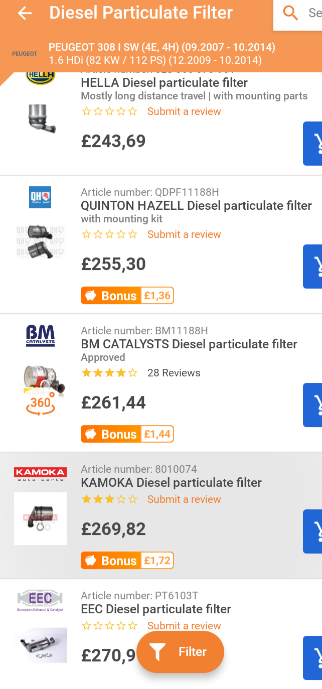

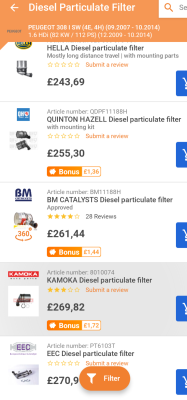

£250 doesn't compare that favourably with "bin it and fit a new one" which a very quick AutoDoc search suggests starts around the same price range:
From Autodoc app
From Autodoc app

I'd just reset the injector codes and see what happens Matt...
Posts: 5342
x 2356
CitroJim wrote: 28 Feb 2024, 05:16 I'd just reset the injector codes and see what happens Matt...
Yes, definitely.
Just quoting the good information from Marc:
GiveMeABreak wrote: 27 Feb 2024, 23:22 You need Powerflex Additive Matt.
This 308 has a reservoir not a pouch system. You need to add a minimum of 1 litre, but it does not specify capacity. It is usually at the rear left of the vehicle hidden behind a heat shield near the rear exhaust.
More research/ shopping to be done :)
