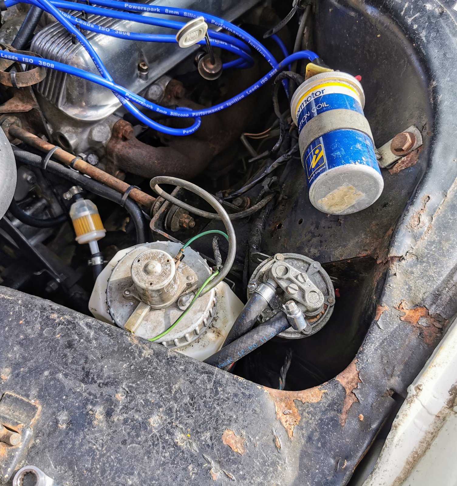

Yesterday I set about making my temporary fuel return system on the Rover slightly less sketchy. I had originally run this using 3/8" brake line for most of the run just as proof of concept. I wasn't happy with that though, but I just didn't have enough proper fuel line on hand at the time.
The end results (well, save for a couple of hose clips I was short of):
Where we hook up to the original return line from the carb feed line.
The original return line has been capped off for safety's sake. I don't think it's going to suddenly start spilling fuel back to the engine bay, but I don't want to take the chance.
Hose clips obviously still had to be added here.
That bolt is only half threaded so there's a nice smooth area to seal to the hose, and the bit of hose is a snug fit on both the bolt and the nylon line.
The line follows the route of the factory fuel lines down the back of the engine bay.
Then follows the main bundle of pipework and cabling along the underside of the car.
Up into the car through the bung I'd found in the floor under the rear seat (with a suitable grommet to protect the hose).
Then joins the loom of cables and pipework that runs through into the boot through a grommet behind the backrest of the rear seat.
Then around the tank and onto our former vent port that's now our return spill port.
Couple of additional hose clips needed here in the photo.
Which should have us most of the way towards having a working fuel system. Though the car was still running a bit lean it seemed (as it demonstrated to me a week or so back when I had the air cleaner off and blipped the throttle, resulting in a cough and then proper shotgun like report out of the left hand carb which left my ears ringing for about an hour). This didn't surprise me really as I know the original return line had a restriction in it to act as a crude pressure regulator. I have picked up a cheap regulator, though I don't have huge hopes for that (because...well...cheap parts). If it doesn't work I've an idea to make my own crude version using an adjustable clamp on the line.
You may ask why I'm messing about with a cheap pressure regulator. Quite simply because this isn't intended to be permanent, and it doesn't seem worth spending real money on a regulator that's going to get stuffed in a box in the garage and forgotten about after a couple of months. I have however ensured it's installed in the boot rather than the engine bay just in case it does leak. Yes, because I trust it about as far as I can throw it.
Guess what happened after I'd been driving around for about 20 minutes? The engine cut out and wouldn't restart. Guess why...no fuel being delivered.
Initial suspicion fell on the regulator...which when removed revealed no fuel coming down the return line. Cue much poking and prodding and swearing at everything I'd done yesterday.
That fuel pump, which I bought from a marque specialist...yep, it's dead. Well it's kind of dead...it pumps just fine until you present it with anything resembling a pressure head to pump against, at which point it stops pumping until it's power cycled an indeterminate number of times. It has always been horrifically noisy so I'm not hugely surprised, but it's disappointing as it wasn't cheap.
I then tried to switch over to the spare Hardi pump I've been kindly provided with by a reader of my blogs. That apparently needs a service, as more fuel came peeing out from around failed seals on that under gravity than I was getting out of the previous pump when it was running. Guess I'll need to order a service kit for that then...and will be nicking the pump back out of the Invacar again for now!
That's a job for another day though. Next job is sorting the failing wheel bearing on the Trabant which has progressed to making an unpleasant gronking noise with each wheel rotation now, so that's not going anywhere again until that's changed. Which is great as it's meant to be going to a show at the weekend. I'll need to drop by and cancel the MOT tomorrow as the odds of me getting everything needed for that done tomorrow are slim, especially as I'm going to be otherwise engaged for a large chunk of the afternoon. I don't *think* a press is required - though apparently getting the hub off can be a real pain.
...I did replace the broken reflector on the nearside tail light though with a random one I found in the parts stash.
Let's see how things go tomorrow.

Having stolen the fuel pump from the Invacar again, I figured it was about time I tidied up the power supply. I was still using the piggy backed feed from the starter solenoid back from when I bodged things together when it broke down on a previous occasion and I shoved an electric pump on as a get-me-home fix. Not a long term solution.
A proper ignition switched feed was sourced from the heater blower fuse on the fuse box (which already had a spur running from it for the radio, so I nicked that), and routed it properly to the pump following the factory wiring loom. Even using all the factory wiring clips.
That's a bit tidier. I still need to add the inertia switch, but that's a ten minute job, and I want things working reliably before adding another potential point of failure.

However, you remember the fuel leak which caused a small environmental disaster and caused our house to stink of fuel for a full week? Guess what reappeared this afternoon? From exactly the same spot...Yep, the same bloody leak.
I think the root cause of the issue was actually down to the fuel filter itself. This had no ridge on the end of the hose barb, and I think the hose was just sliding down from the 8mm to 6mm section. Said cheap and nasty tiny filter has now been consigned to the bin and a larger, better quality one has been fitted.
It was immediately apparent once the hose was connected that it was far more secure even before the hose clip was done up. Said hose clip has also been replaced to be safe. I've had that happen before on one of these but thought at the time it was a fluke. They're getting binned though now.
