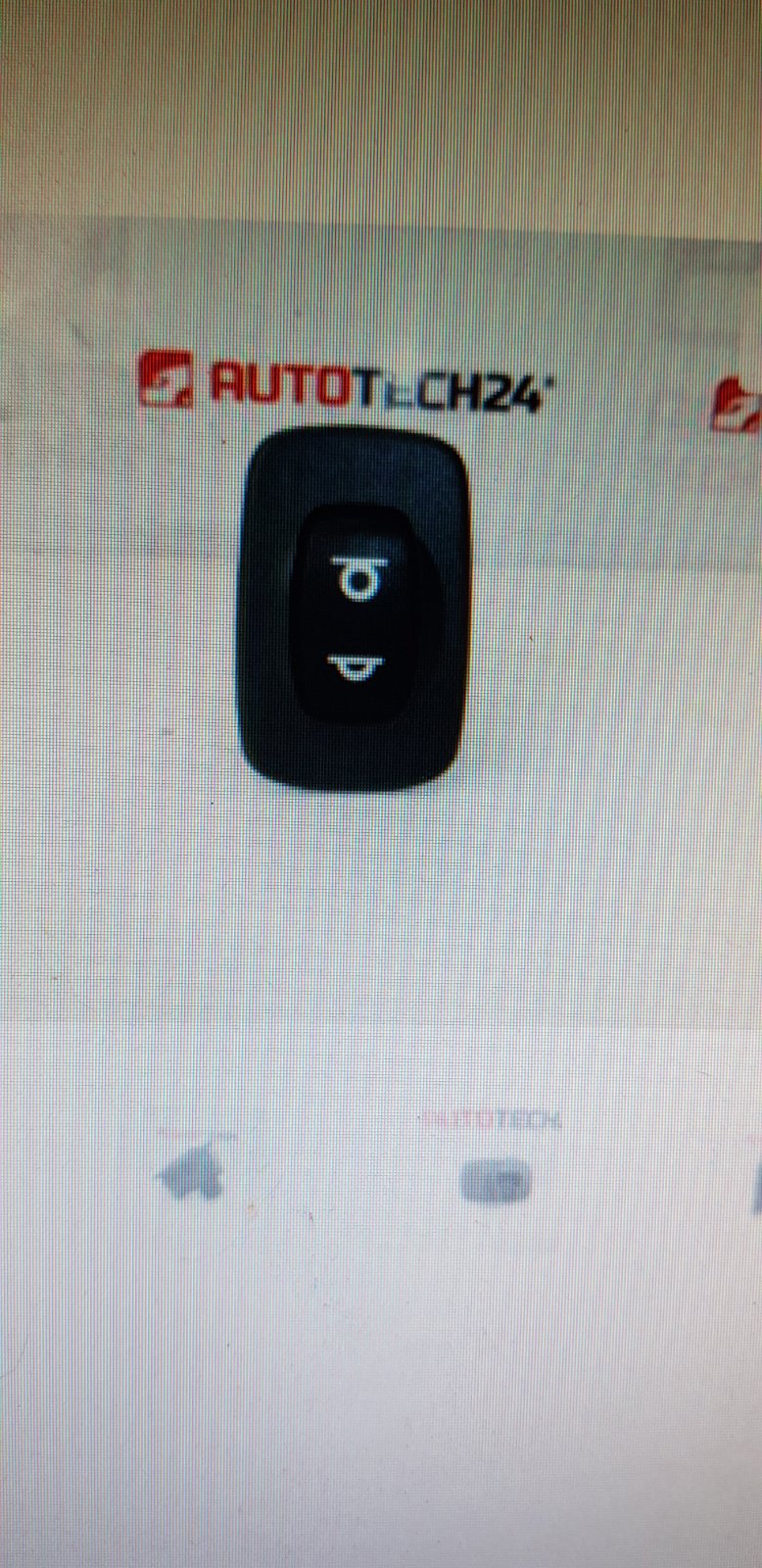

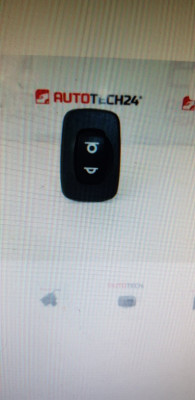

Re: Citroen C5 rear suspension questions & problems
You know, there is also a switch in the boot on the right side?
I mean this one!
But the car will return to normal position after this vehicle has been driven- and the OP would have to push the button to lower and raise the rear manually - so surely would of known he was doing this?
