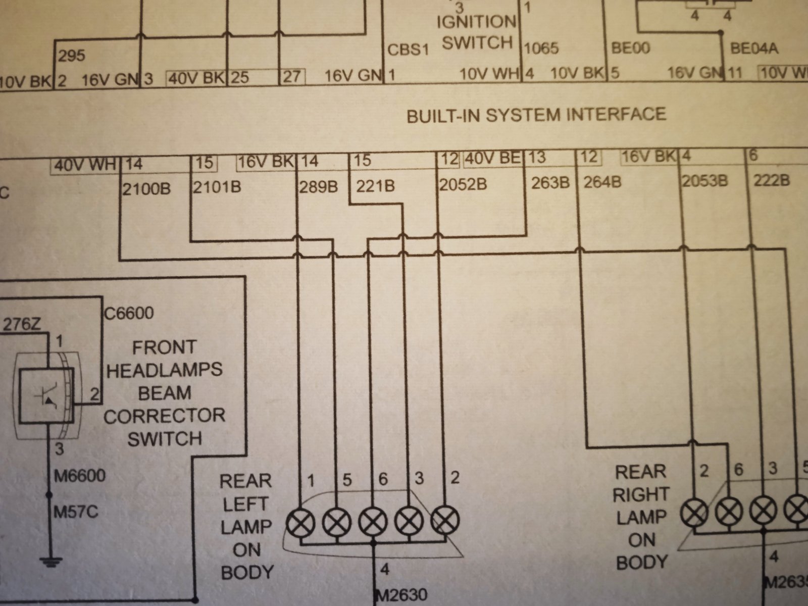

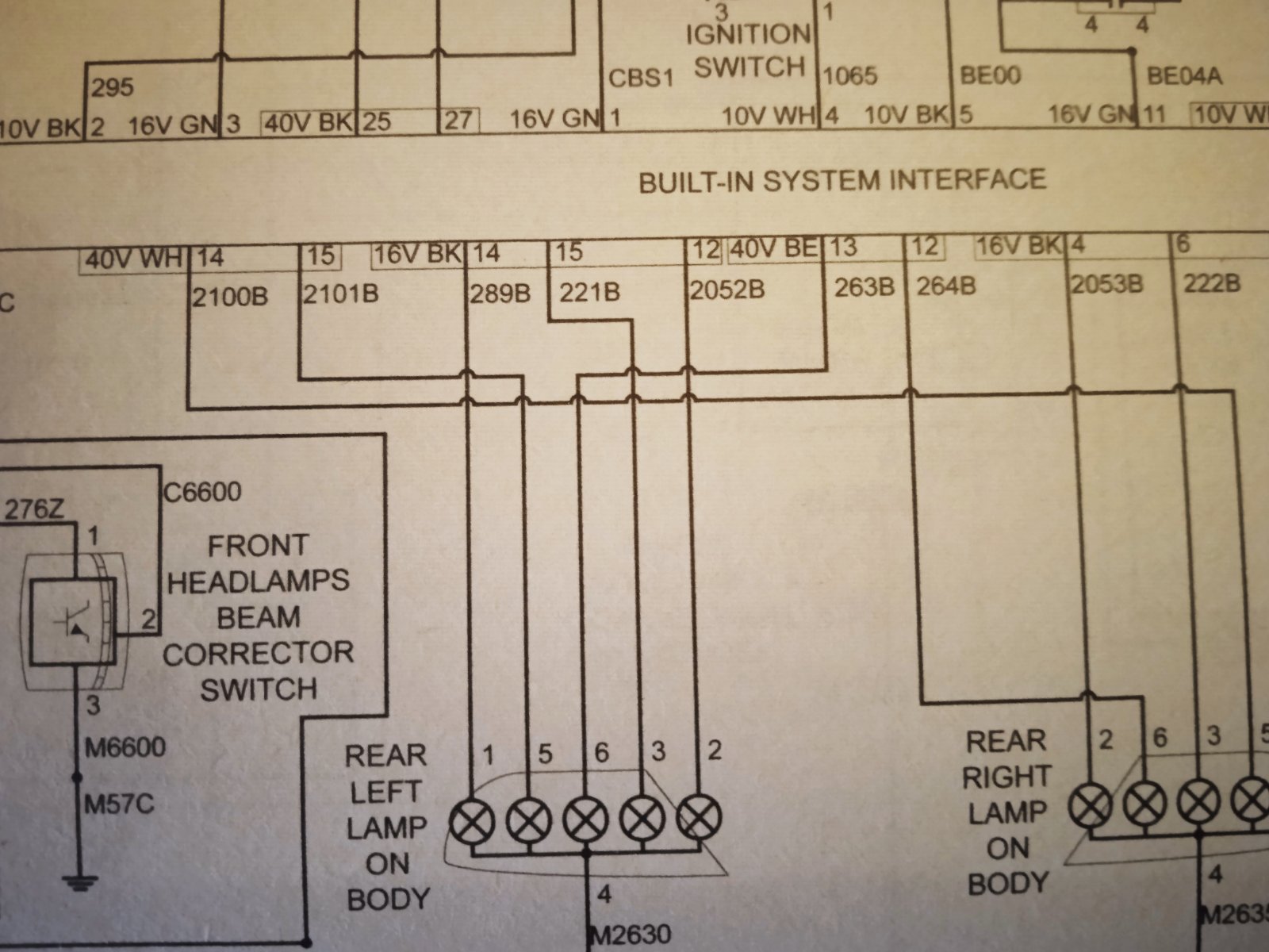

- x 6948
Re: BSI info needed
PSA Electrical Diagrams - Wiring & Symbols Codes Index
As you can see the rear left and right lighting unit (2630) uses MC80 earthing point, so I would check the connection shown back to the cluster on the second diagram below. Also check the electrical connection, specifically pins and socket, especially the earth for signs of melting. Try an earth bypass to see if the issue is the earth point or not.

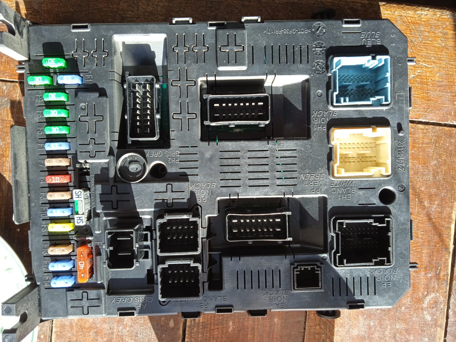

Re: LH Rear Indicator not working 2010 Dispatch.
Thanks for all the advice on the other threads regarding the satnav and BSI plugs, wiring diagrams etc. I've got the BSI out. I can't work out which pin socket powers the indicator. My plan is to do a resistance test along the wire from plug to plug. If this shows up OK and not shorted then plug all other plugs back in then do a diag fault check and everything should come up short to positive (open circuit) on that unconnected plug. If the LH rr indicator still shows Short to earth then the BSI may be shot?
Does this sound a decent plan?
Does anyone know which socket relates to the plug? I'm thinking bottom right labelled EP Noir/Black but am unsure.
I've already checked the wire from the Rr cluster plug for a short to earth and it reads OK. I've also checked the plug wires to see if any of these are shorted to each other, fine. I've also plugged in the RH RR cluster on the LHS and the fault remains.
Pete
- x 6948
I've merged these 2 threads to avoid repetition and duplication Pete. Please keep all related posts on this thread.
The diagram I supplied (now above) is for your vehicle and shows the pins and wiring for the rear light cluster indicator and connections to the BSI.
moizeau
- Posts: 1867
- Joined: 12 Jan 2015, 16:08
- x 423
Thanks Marc. It's the '16V NR' on the diagram I am confused about. There isn't anything that resembles that marked on the BSI to give me a clue as to which socket it is.The closest thing I have is a socket labelled 'EP Noir' but nothing that realtes to '16V'.
Pete
wheeler
- Posts: 7932
- Joined: 21 Sep 2002, 19:07
- x 1056
16v NR is this one
Remember it refers to the colour of the connector on the harness, not on the BSI.
moizeau
- Posts: 1867
- x 423
Thanks Wheeler. I dawned on me from somewhere that the 16V referred to the number of pins (not mentioned anywhere that I could see in the BOLs) . Tested it and I have continuity plug to plug and no short to earth so looks like a BSI problem.
Is this the case or is there some other electrickery that can cause this issue?
When hazards are on all indicators flash at the correct speed...apart from the dead one.
Can I nick a feed from the trailer socket behind the Rr Lh panel or the side repeater or will this cause another issue or overload?
Cheers very much for all the help so far
