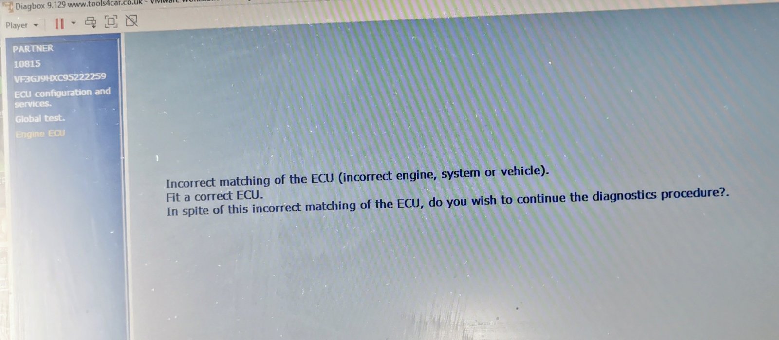

Yesterday Jim and I had another shot at getting the cruise control on the Partner going.
Sadly we weren't successful, as when going into the engine ECU configuration menu it simply claimed that this function wasn't available on my ECU. Though we have a hunch that this may well be a replacement ECU based on the fact that this message pops up every time you go into the Engine ECU menus.
The actual ECU does respond properly when interrogated through the global test, and is obviously functioning as the car works, but it's clearly not happy about something.
Can someone with access to the relevant systems look up what ECU this car should have originally been fitted with? I think knowing that and figuring out if we have the right one is key to making any further progress.

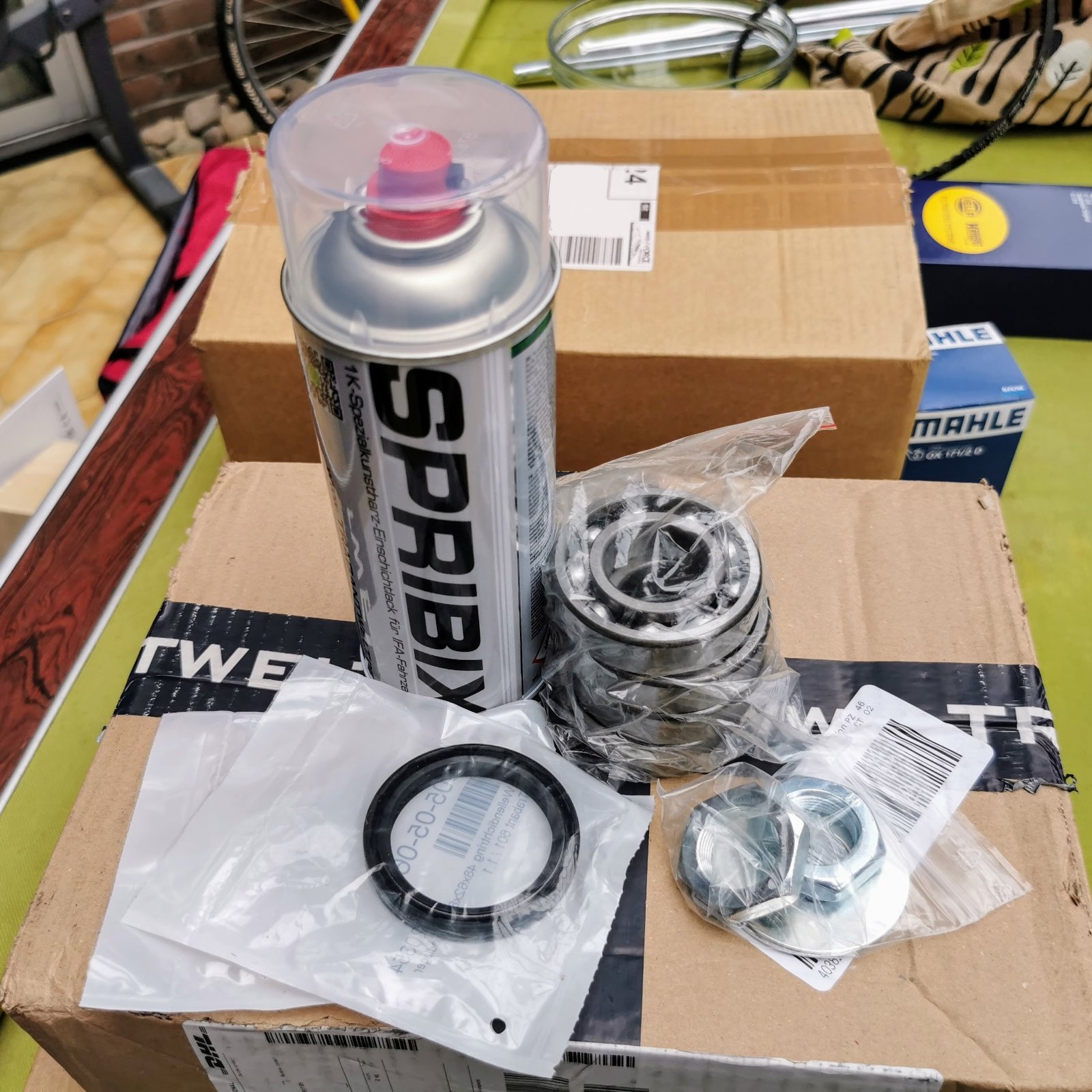

Box containing the wheel bearings for the Trabant and some properly matched paint have turned up.
Predictably this has turned up before the parcel from another supplier a couple of hours away for something totally unrelated that was ordered 48 hours earlier!
I'll have a bash at getting that lot fitted next week. I'm busy this weekend so won't have the opportunity until then.
