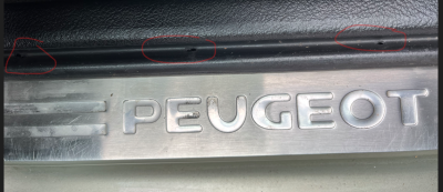

Re the 407 door seal issue and airbag warnings, after a few days of rain and testing with the hose, I gave up as water was still pooling on top of the bottom door seal and then running inside the car.
My solution was to put a few holes thru the seal with a leather hole punch tool which seems to allow the water to exit (the door seal gets squashed when the door closes)
Not ideal but the only solution I could see bar a new door seal which probably would not help anyway
Time will tell if the carpet still gets wet

ps - the carpet is now dry so holes in rubber seal worked
