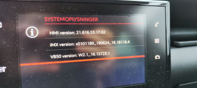

Followed the instructions on the screen, it took around 22 min.
Engine running and i left the car alone for the duration, when the update was done, i pulled the usb stick as instructed on the screen.
The instructions said that when usb stick is pulled the system will reset.
After reset i shuffled true the menus and when tried to enter the climate menu it just said something like: please wait initializing
I lef it there for 6-7 minutes and the choose to restart the car, cycle the power.
And now it won't even register that I press the climate soft button next to the screen.
Please see attached picture of software Installed.
I'm unable to restart the update, I says no update required.
UPDATE: I DISCONNECTED THE BATTERY TERMINAL AND LEFT THE CAR FOR 1 HOUR, now it works.

Great, sometimes a reinitialisation of the BSI can resolve this issue. But in future make sure you follow the BSI Reset / Battery Disconnect / Reconnect Procedure for the correct procedure if disconnecting the battery.

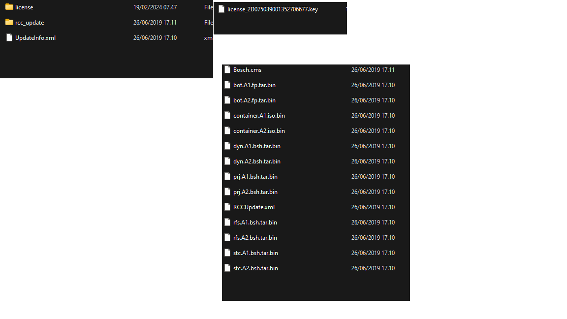

Firmware 6_0422_23.3I37.1
Ziya Licence File
Extract contents ONLY to USB. Do not copy the TAR file to the USB or it will not work.
Next create a folder on the USB called licence or license (spellings vary - it will work with one of the other spelling) and then copy the licence file into this folder.
Keep the engine running - essential!
