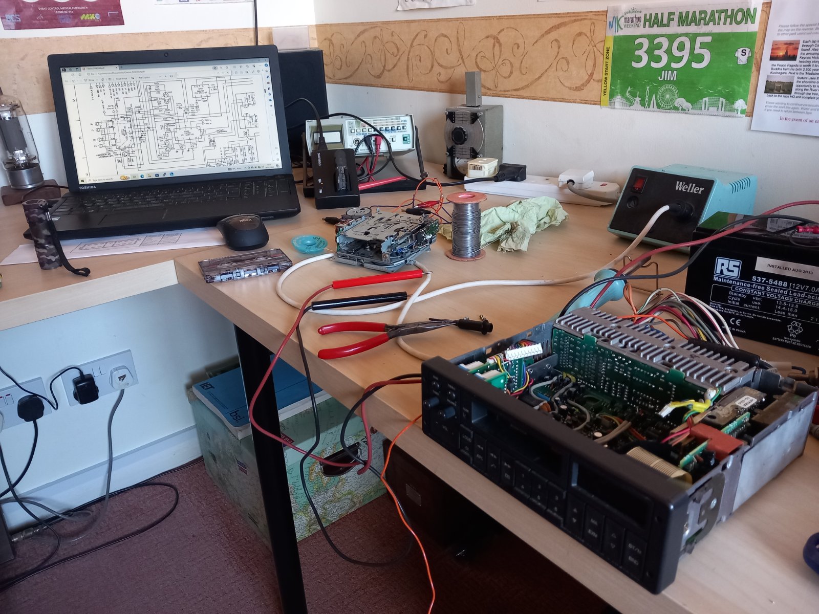

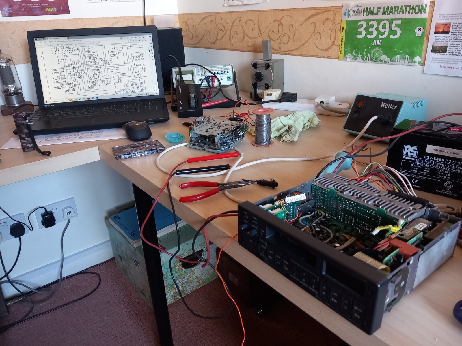

A little teaser of what's currently on my bench, undergoing a bit of surgery
Kudos to who can correctly name the car it was originally found in...

Re: Citrojim's AX, Pixo, C3, Running and Cycling Tales
I'm going to say BX it's only a guess because (I can't read the laptop screenCitroJim wrote: 16 Feb 2024, 15:13
I'll go a couple up from the BX and try an XM, there's a feeling of vague familiarity about it?
They may well have appeared in the BX Skull as it's a Citroen branded Clarion. This one is from the Series 1 XM so you are quite correct on this occasion Mick
The problem is the usual, radio OK but very low volume on tape. A common problem it seems. Conventional wisdom usually points to a problem with the Dolby module that does both the tape head preamp and noise reduction functions. I'm now doing all I can to confirm/eliminate that module as the cause. There are absolutely no details available for this module and no spares available. I have three of these radios, all with the same fundamental problem.
It is imperative this unit is made to work again so I may have to get creative
