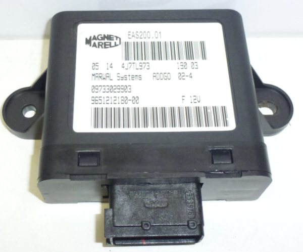

There are no instructions on this except for the following cryptic clue regarding location:
So I would check under the front passenger seat to see if they've bundled it up there. It looks like this:Location: On the chassis member near to the base of the right hand B post (according to vehicle).

Thank you to each of you. I looked for it, but couldn't find it. Didn't realise I'd need to remove some trim. A job for tomorrow, I think!
