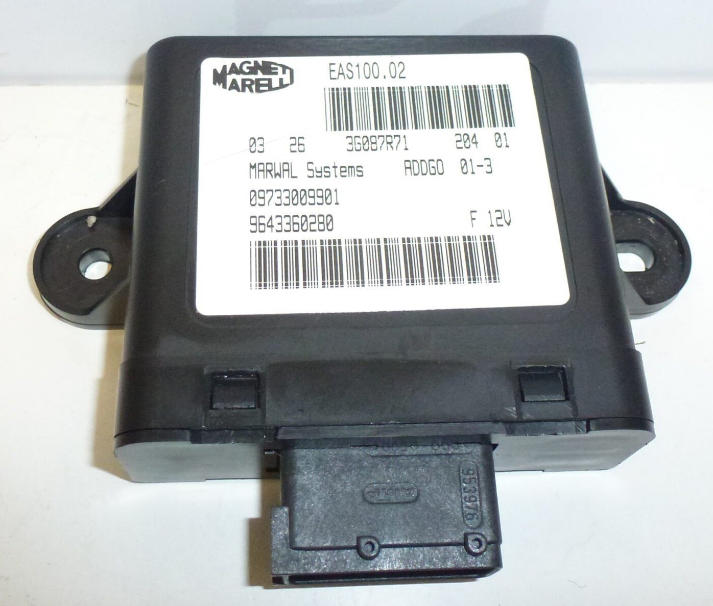

Can someone help me locate the "Particle Filter Electronic Control box" on the car . Mine is Citroen part number 1525AS for DPX42. See example photo.
My research shows that there are 3 variants under the same part ref 9643360280, namely EAS100, EAS100.01 and EAS100.02. Do these refer to software standards perhaps? And are they inter-changeable? I have read that early ECUs were problematic.
Many thanks

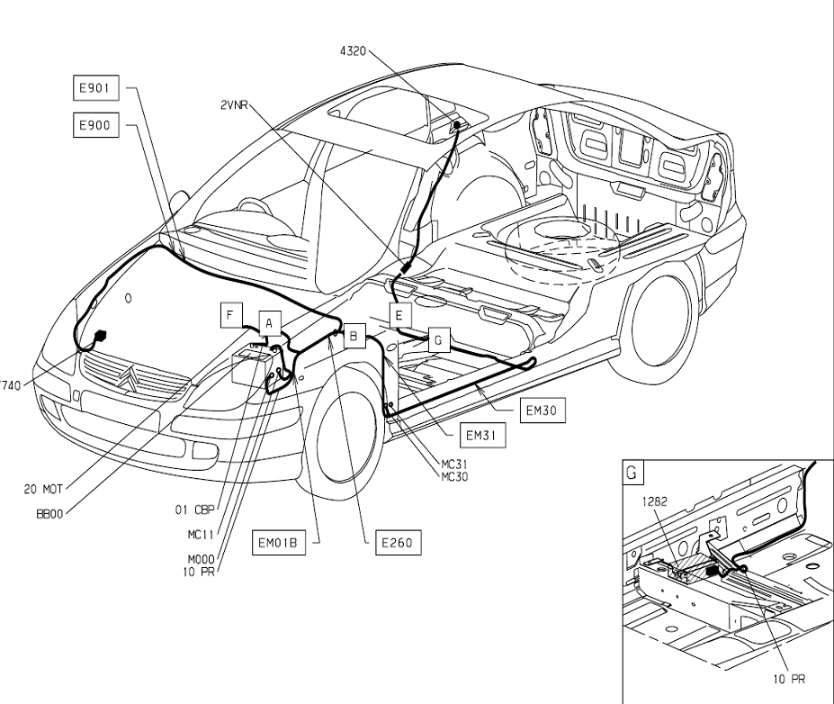

Re: C5 Mk1 2.2HDI 2001 Diesel Additive ECU
Not a lot of detail. It is component 1282, and seems to be under the front passenger seat somewhere.... Shown in diagram 'G', then look for 'G' on the main vehicle diagram.

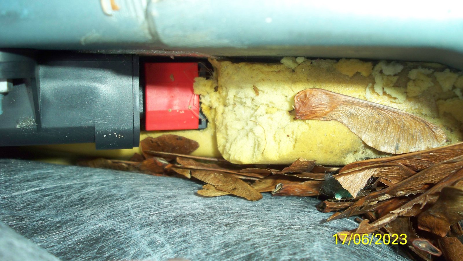

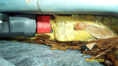

It would appear a mouse had been busy under trim :-D , right next to the ECU, with significantly nibbled foam rubber insulation and a collection of dozens of sycamore seeds. How is this even possible???! The wiring appeared untouched. See photo - the red part is the ECU connector.
