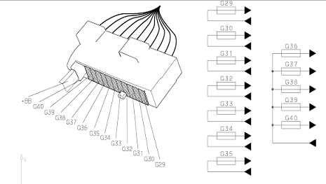

Those are the correct fuses, but make sure you have checked the correct set, as there are 2 sets of these fuses!
One set is in the BFH1 Cabin fusebox: G38 3A battery + ESP ECU
G39 10A battery + electrohydraulic suspension
The other 2 are the ones you want to check in the BH12 Cabin Fusebox: G38 25A battery + driver´s heated seat
G39 40A battery + passenger´s heated seat - HIFI amplifier - Cielo

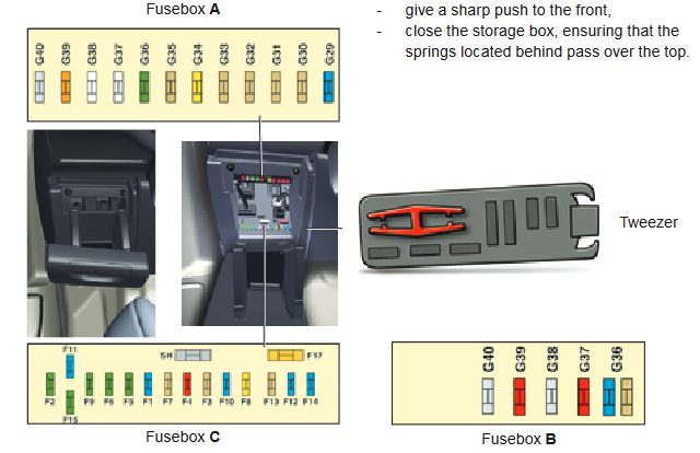

I replaced the ones that are above in this picture https://fuse-box.info/wp-content/upload ... 542252.jpg
But the amps dont match with your pictures. Mine was 30A for both

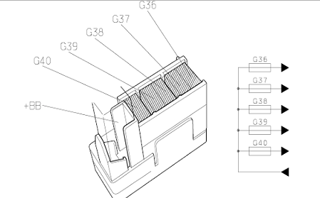

The handbook is all wrong - they show the same fuse diagram picture for 'C' & 'B' in your picture.
This is better: It's the top ones that have the fuses fromG29 to G40 that you need to check the G38 & G39

Yes I checked the fuses G38 and G39 in the top. Not the easiest to replace.
