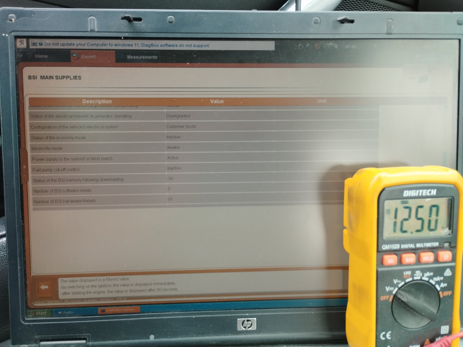

The charging is still not right. The alternator voltage settles down to 12.5V and stays there regardless of how flat the battery is, but even at 12.5V it will produce 80A to balance the electrical load. There are no fault codes present.
But... If I perform a BSI reset, the next time the engine is started the charging voltage jumps up to 14.1V or 14.4V (depending how flat the battery is) and over an hour or so driving slowly reduces back to 12.5V as the battery charges. If the engine is stopped during that time, it reverts to whatever the charging voltage was when the engine was stopped.

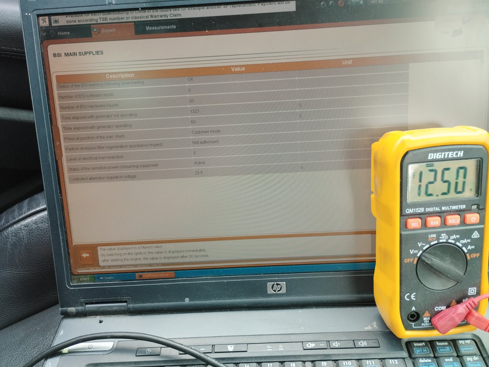

I connected Diagbox again this morning and here are a couple of BSI screen shots (when the charging voltage was low). Note the "Status of the electrical network at generator operating" is Downgraded. WTF does that mean?
Note the "Controlled alternator regulation voltage" is 23.5 V. This voltage varies with the actual alternator output voltage, but is always about 10V higher than the correct value.
The Engine ECU does not seem to show any unusual parameters, but does indicate that battery charging is not required.

Last one looks odd, regulated voltage 23.5V? Is the BSI seeing the measured voltage - wondering if there might be a high resistance somewhere?

The footnote in diagbox says that that is the voltage that the BSI thinks the Engine ECU is asking the alternator to produce, but the engine ECU values in diagbox don't reflect that.RichardW wrote: 31 Jan 2024, 21:23 Last one looks odd, regulated voltage 23.5V? Is the BSI seeing the measured voltage - wondering if there might be a high resistance somewhere?
There is a regulator in the alternator, but it is controlled by the engine ECU that decides what voltage it should be producing. The BSI and Battery Status ECUs also get involved, but I have no information on the actual algorithms involved. I did try another alternator, but it did not change the behaviour.Huskyxantia wrote: 31 Jan 2024, 21:31 Isnt there a regulator on the alternator ? Maybe that is breaking down ?

Actually thinking about it, some of the data above showed the BSI voltage to be 23V or something, so if the BSI is 'seeing' a high voltage it might be directing the ECU to cut output.

The control line from the engine ECU to the alternator is LIN bus, a digital signal. It produces an error if it is unplugged. I also tried connecting to to a spare alternator (not mechanically coupled to the engine) and no errors until I started the engine, and it then threw a "mechanical error" because the alternator was not reporting a sensible speed.
The battery voltage reported by diagbox (which I think is sensed in the BSI) always reports about 300mV above the real battery voltage, but I think that is just a calibration error, not a fault. The 23-25V reported value is what the BSI thinks the engine ECU is requesting of the alternator, but the engine ECU reports a sensible value that matches the actual battery voltage.
