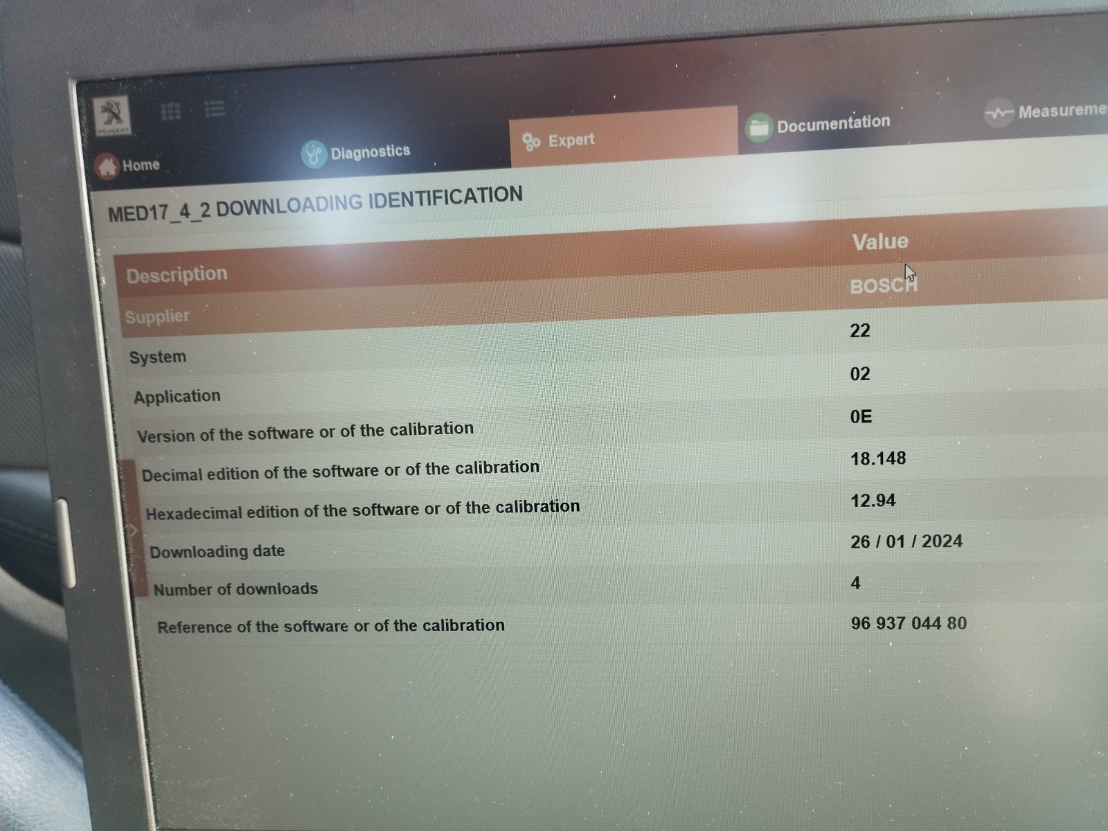

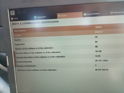

Meanwhile, I got itchy fingers and decided to test the theory that DIY ECU programming is impossible on this side of the world and decided to try.
My normal Diagbox PC (other than being very old and running Windows XP very slowly) runs diagbox v7.6.2 and I did not want to upgrade it or risk breaking the installation. So I configured a VPN to a country where tokens are supported, and created a new servicebox account with details of an address in that country of the VPN. UK and EU residents would not need a VPN.
I found a spare SSD drive, fitted it to a relatively modern PC and made a clean install of Windows 10 (64 bit), followed by an install of the latest version of Diagbox. The Diagbox software is available to download from Servicebox after you have logged in and bought a diagnostic token (44€). Don't attempt to use Windows 10 32 bit, it can create a world of pain with device driver compatibility.
The next test was to see if connected Diagbox would complain about my clone VCI. It did not.
So I connected it up to the car, linked the diagnostic token (which last 7 days for 1 vehicle) to the diagnostic session and interrogated various ECUs while becoming familiar with the "improvements" in the V9 Diagbox interface. Then I found the software downloading page for the engine ECU, clicked the mouse a few times and... it started downloading software. At the end of the process it offers to erase fault codes for all ECUs, which it did.
The Engine ECU software version has incremented. It remains to be seen whether the original fault has been fixed. Everything else seems OK.
