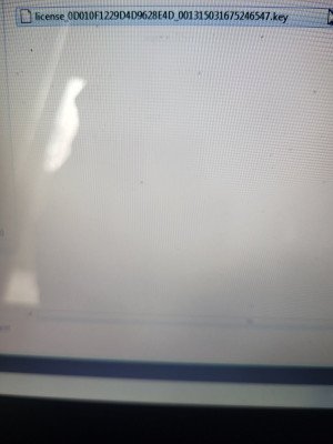

Pablo1568 wrote: 06 Feb 2024, 20:40 What is the file name in the licence folder ? I have: licenses_001315031675246547_20240206210411
That's not what is in the file I provided. It should be a file called:
license_0D010F1229D4D9628E4D_001315031675246547.key

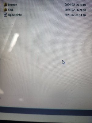

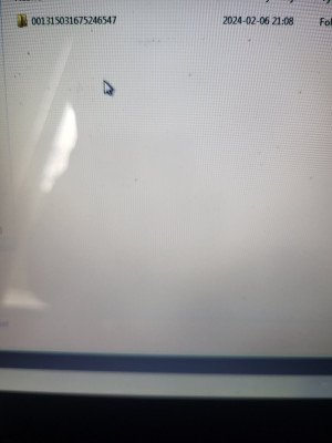

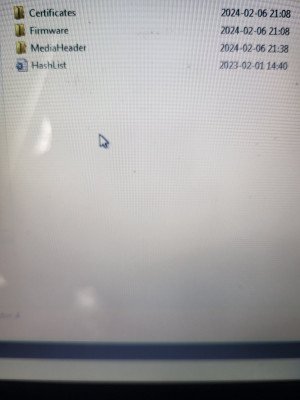

GiveMeABreak wrote: 07 Feb 2024, 11:45 I need a screenshot of the USB showing me the files on the route please, and another one of the contents of the folders on the USB too.
Ok. So thats pictures of the usb stick.
1st picture is Root
2nd picture is inside fokder licence
3rd picture is inside folder SWL
4th picture is inside folder 001315031675246547

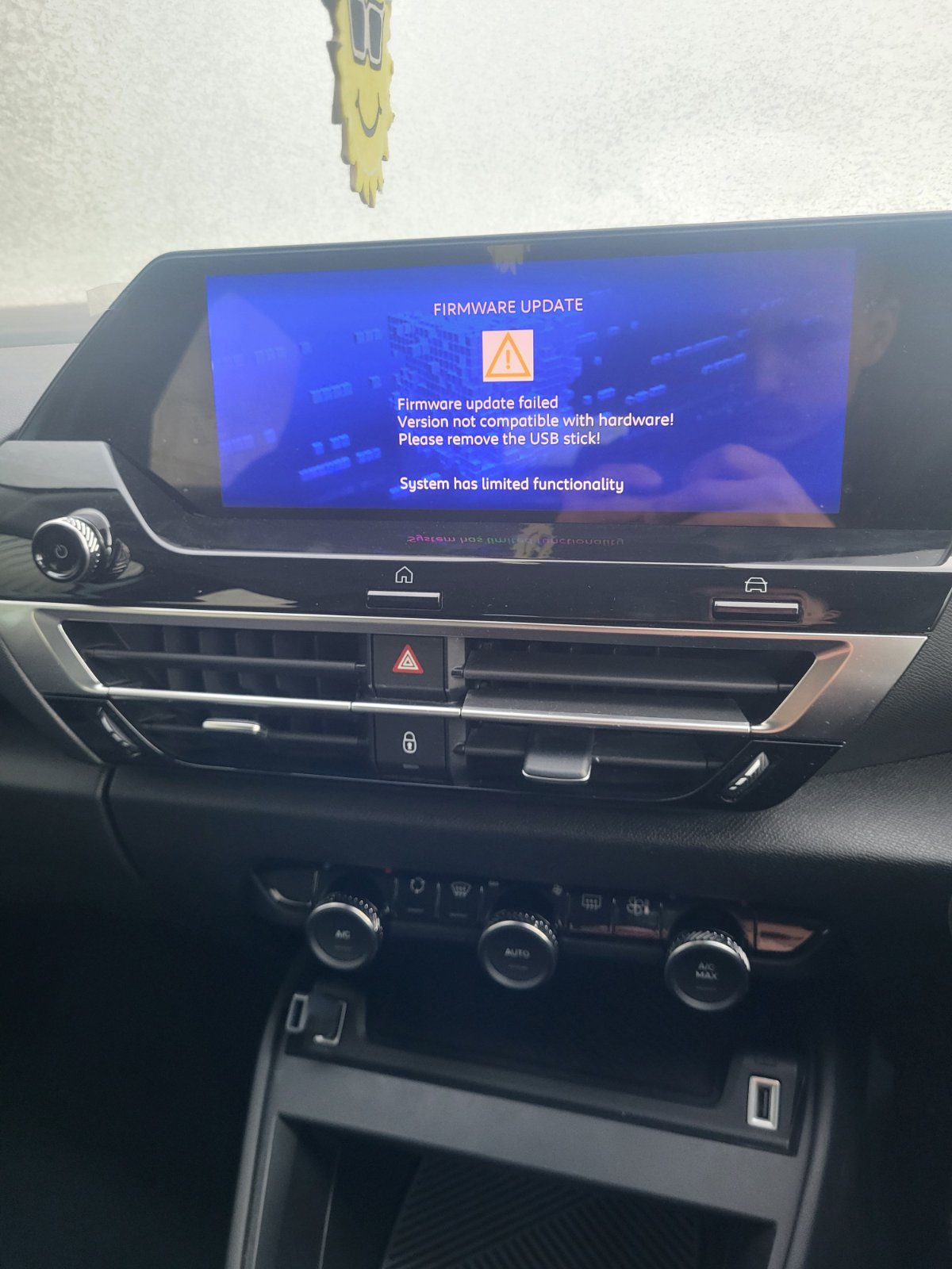

Dang it, now mine is saying the USB stick is not compatible with my device! It's a 32GB USB 3.0 stick formatted to fat32?
x 6945
Re: PSA NAC RCC Updates
Try 'license', but even the official instructions can vary. Let us know if this works in your situation.
ATOJAR
Posts: 18
Joined: 04 Feb 2024, 20:52
x 1
Unread post by ATOJAR »
Yep, I can confirm re-naming the licence folder to license did the trick, update 0422D installed successfully.
Thank you very much for your help. :-D

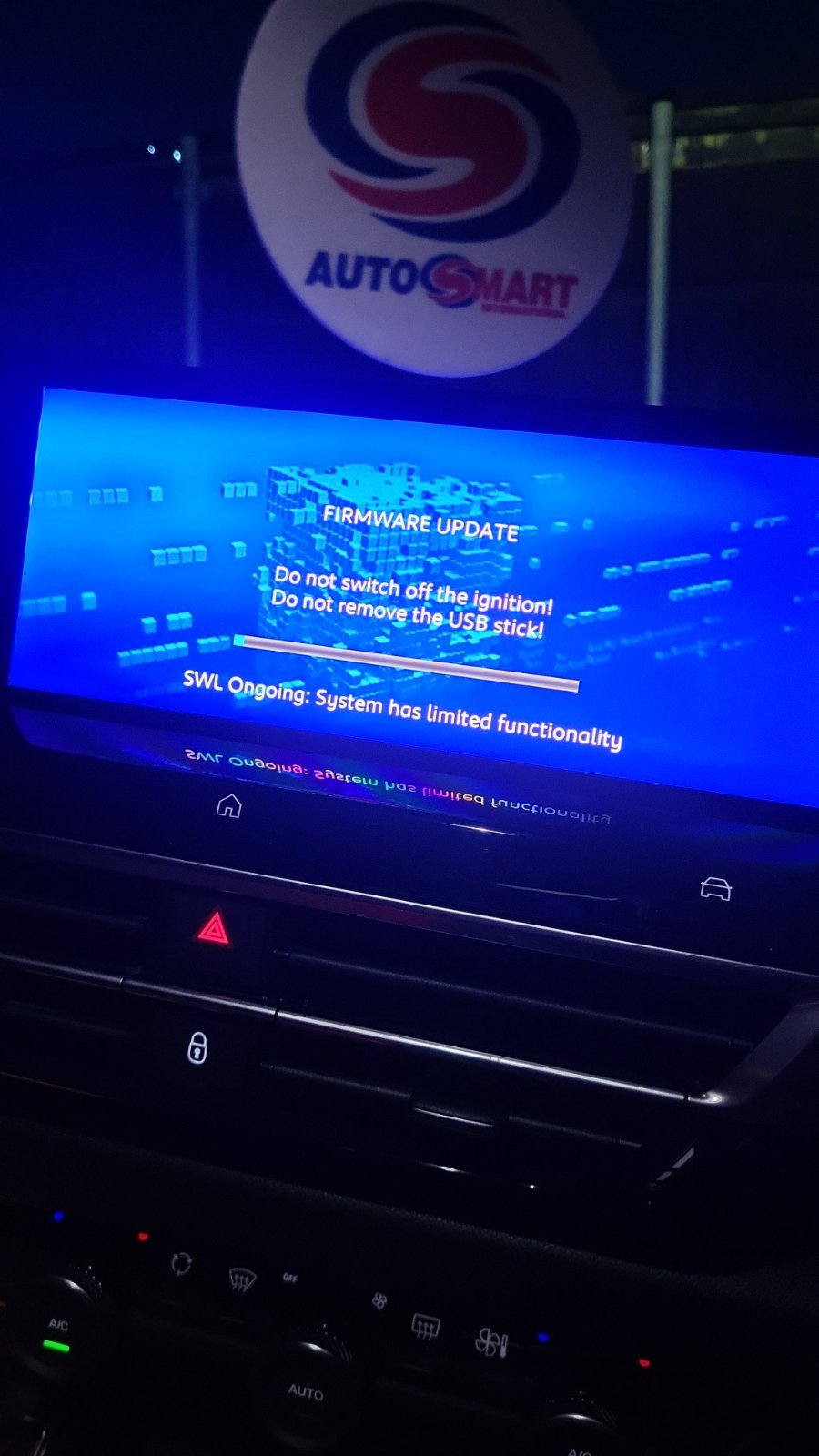

ATOJAR wrote: 07 Feb 2024, 16:45 Yep, I can confirm re-naming the licence folder to license did the trick, update 0422D installed successfully.
Did the trick for me is well. Still loading, But
hopefully will finish with no issues.
Thanks!
