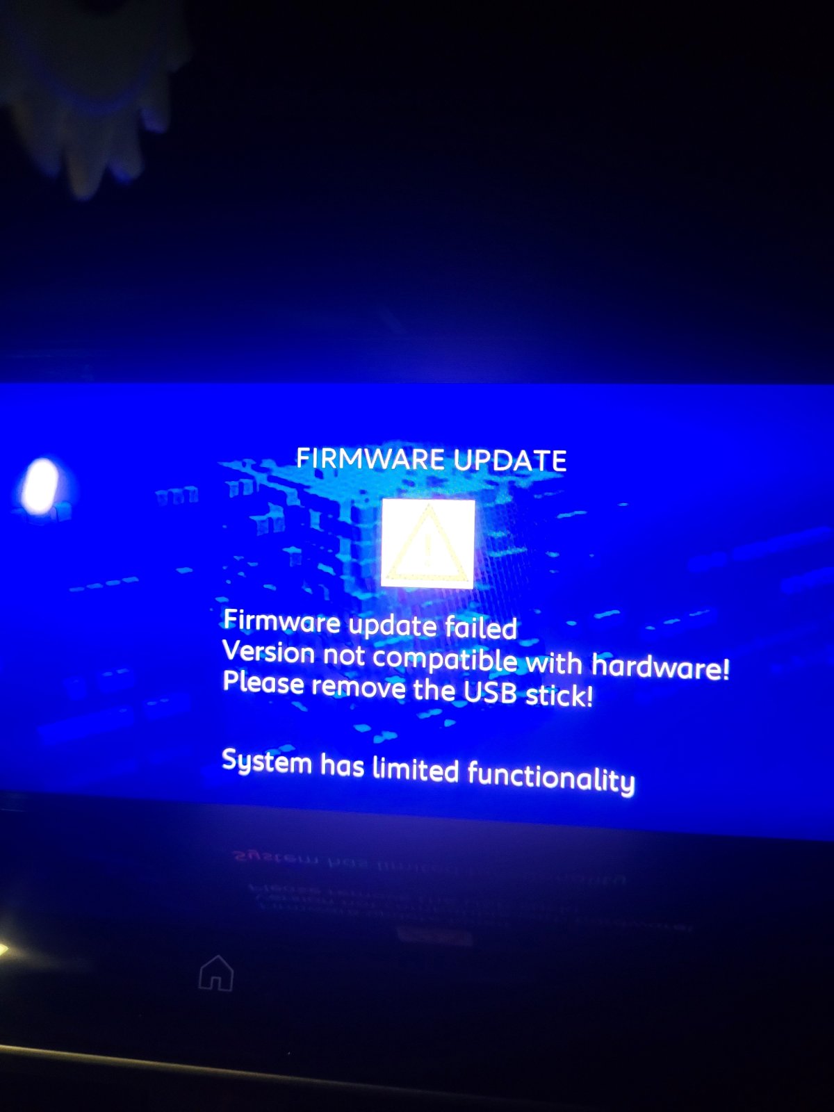

Hi, I have a Citroen C4 Sense + Puretech S/S
Blue Screen on, Can someone help me with update files please ? VIN: VR7**************[VIN obfuscated, can be read by forum staff]

Re: PSA NAC RCC Updates
It says Software loading on demand... WARNING System has limited functionality.GiveMeABreak wrote: 05 Feb 2024, 16:55 You mean you have a blue screen? Where? On the instrument panel or the large touchscreen display?

There is no pendrive in the usb socket. Its stuck like this from 3weeks lol.GiveMeABreak wrote: 05 Feb 2024, 17:00 That means it is in the middle of an update already - so I would not interfere with it or switch the vehicle off during the update!

Can you provide me an software for it ? and licence file ? thanks
Firmware V 44.07.05.22_NAC-r0
Pablo1568 Licence File
Map V15
Keep the engine running and don't interrupt or play with the controls during the update.
Make a licence folder on the USB and copy the extracted licence file into it.
Map V15
I went to the car, and put the usb stick and it says:
FIRMWARE UPDATE
Firmware update failed
Version not compatibile with hardware
Please remove the USB stick!
And ideas ? Thanks.
FIRMWARE UPDATE
And ideas ? Thanks.
