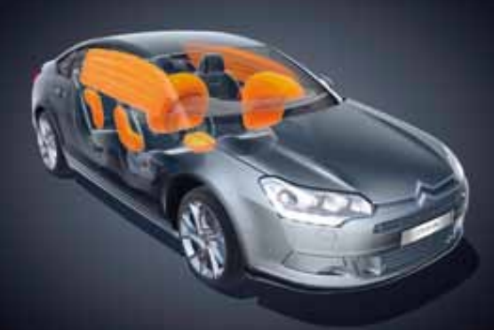

Re: C5 X7 heated seats
I'm assuming this is your C5 X7 (I don't have this VIN) but yes, if you look at the sides of the front seats, you may see a plastic housing with the airbag logo or a cloth tag depending on your trim, but the VTR+ in common with all the X7s have at least 7 airbags, with an additional 2 outer rear seat airbags as optional extras, so up to 9 in total:
2 x Driver (Steering Wheel plus Knee)
1 x Front Passenger (Dash)
2 x Front seat side airbags
2 x Roof Curtain Airbags
Optional Extras 2 x Rear outer seat side Airbags
Thanks Marc,
this is really interesting. I've never noticed these locations.
Mine is a Tourer.
Will have a closer inspection at some point.
