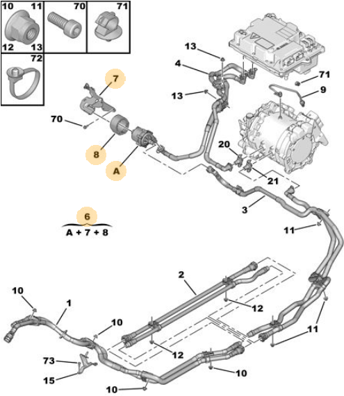

Sorry If this has been discussed somewhere but I have tried search with no luck. I have the message P1B23 and P1B26 water pump of the drive train cooling circuit. Does anyone know where this secondary water pump is located. Many thanks in advance

As you have a Hybrid Traction Control model and these faults concerns the water cooling circuit for the hybrid traction system. So there are 2 different water pumps, one for the main combustion engine as with normal cars and a separate one for the traction system and it is this one that has the issues.
The system is shown at (6) Electric Water Pump, part: 9807176780, £249.41

I've updated my post, with the diagram above, but be aware there are special procedures for draining and refilling this circuit and specifically for tools for degassing it correctly.

That will be great and thanks 🙏. I have also checked the part number and this looks like the one for DS5 1.6 petrol. I have looked the one on my car and it looks like part number 9673079080 unless there was an upgrade. I will check later for the link.
x 6963
Re: P1B23 Waterpump of the drive train
No, that's not the correct part - I've already provided the correct part number in my previous post (under the diagram) from your VIN.
Note that the part number I provided is for the complete module ('A', '7' & '8'). 'A' is not provided separately by Citroen / DS
