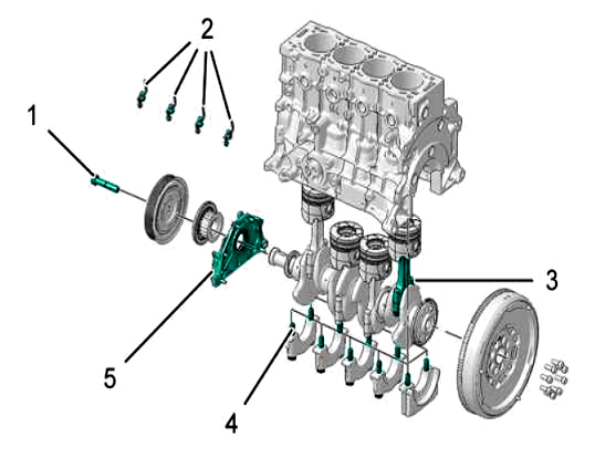

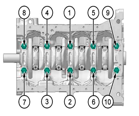

Re: Bearing Cap Bolts

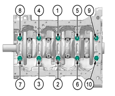

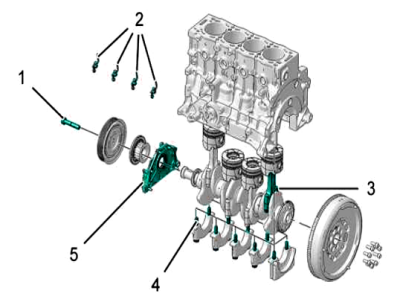

Reciprocating Gear - Tightening Torques
Order of tightening of the crankshaft bearing cap fixing bolts
(4): Crankshaft bearing caps fixing bolt.
| Reference | Designation | Tightening Procedure |
| (1) | Ancillary drive pulley fixing bolt | Pre-tightening to 7 ± 0,7 daN.m |
| (1) | Ancillary drive pulley fixing bolt | Angular tighten to 62 ± 3 ° |
| (2) | Underside of piston jet (Overhaul) | Tightening to 1 ± 0,1 daN.m |
| (3) | Big end nuts | Pre-tightening to 2 ± 0,2 daN.m |
| (3) | Big end nuts | Angular tighten to 70 ± 5 ° |
| (4) | Crankshaft bearing caps fixing bolt (*) | Pre-tightening to 2,5 ± 0,2 daN.m |
| (4) | Crankshaft bearing caps fixing bolt (*) | Angular tighten to 60 ± 5 ° |
| (5) | Crankshaft sealing flange | Tightening to 1,4 ± 0,1 daN.m |

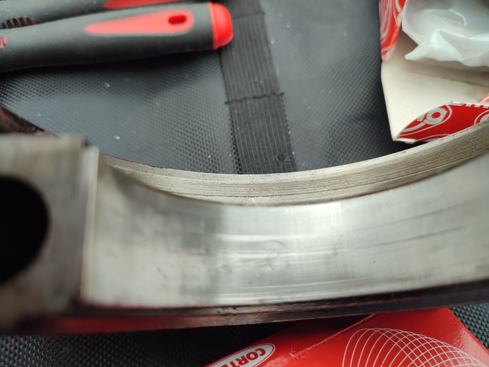

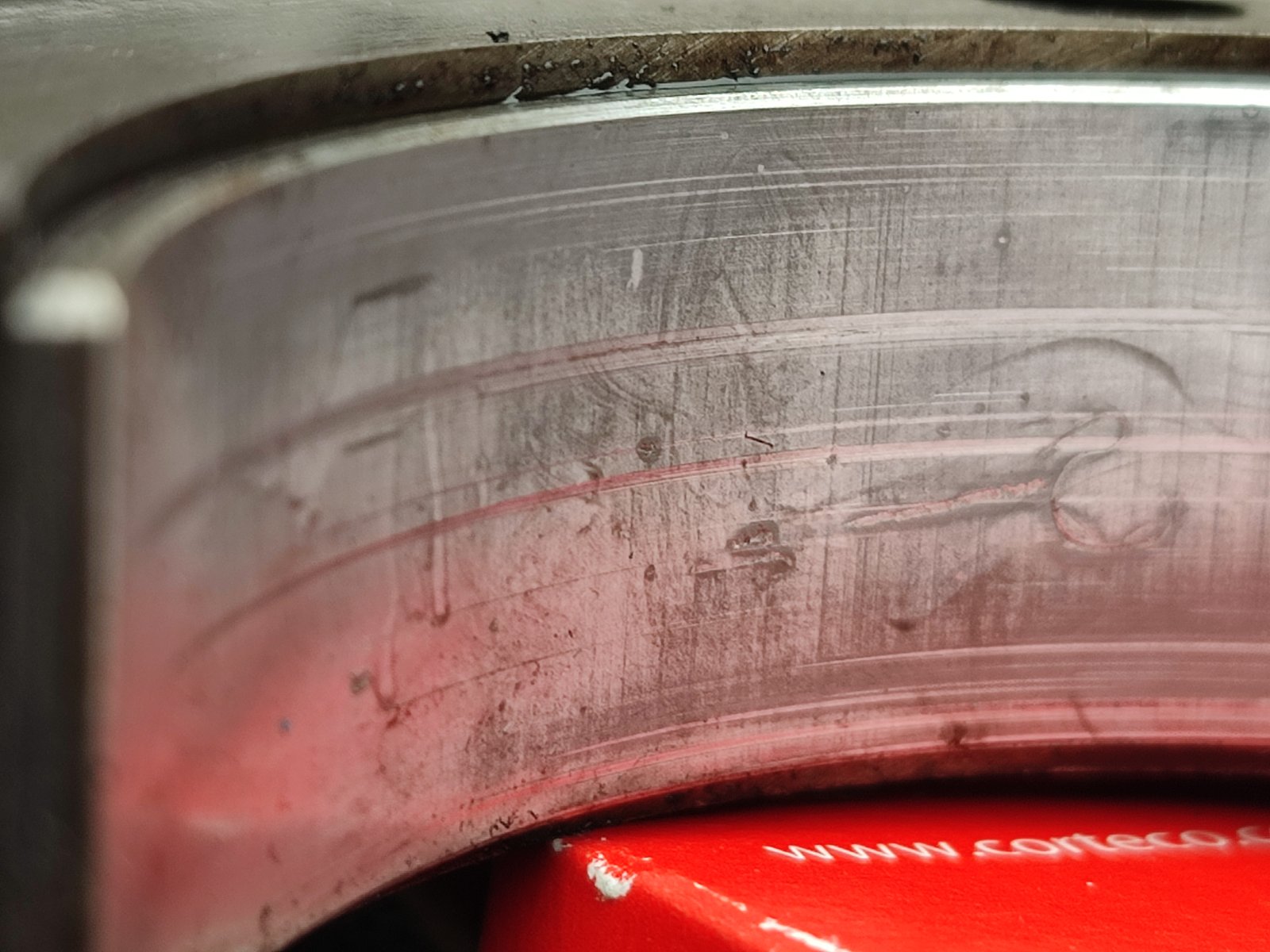

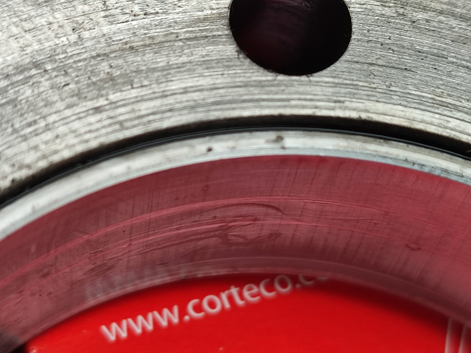

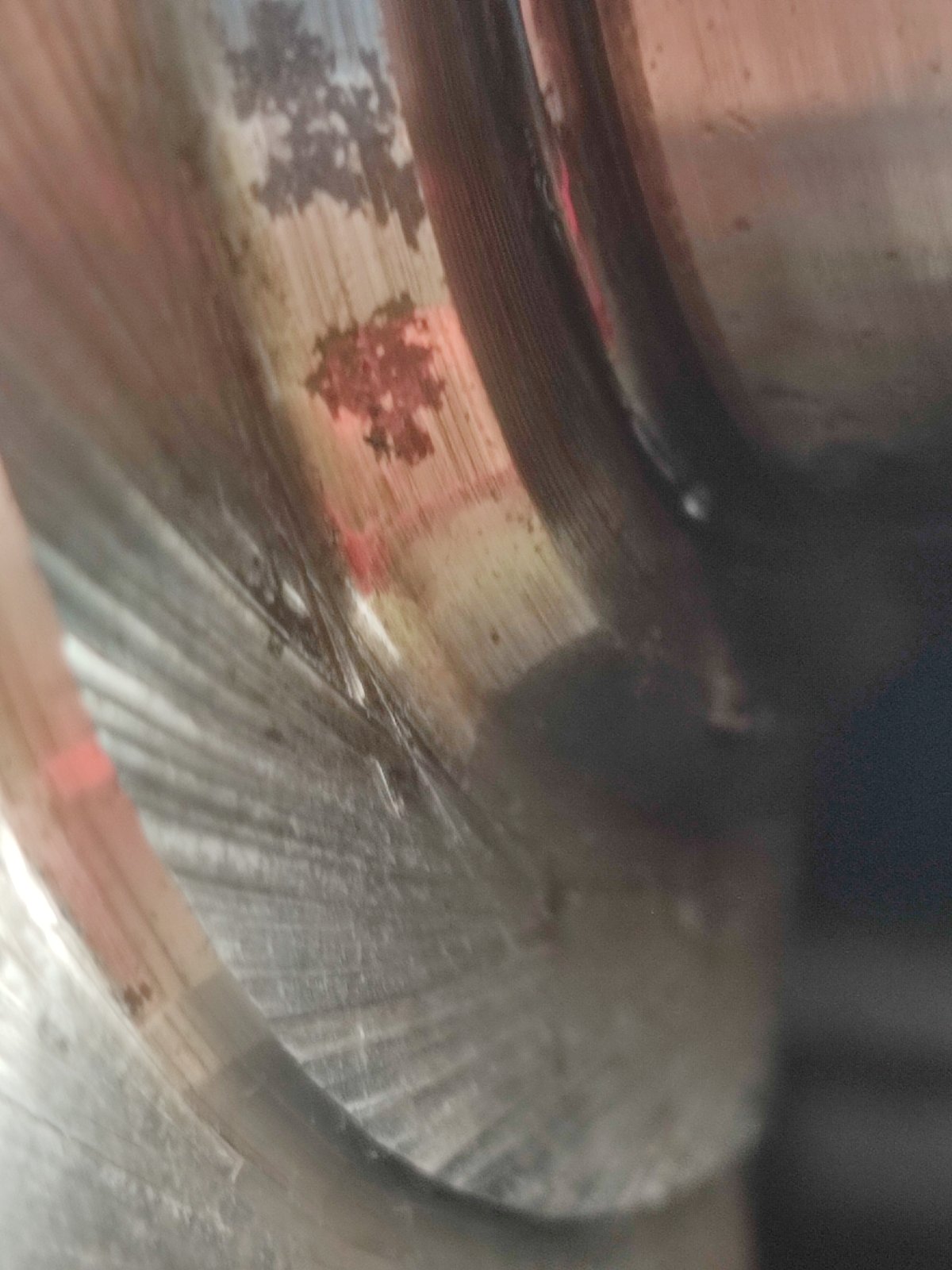

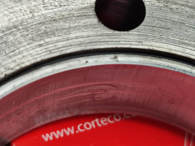

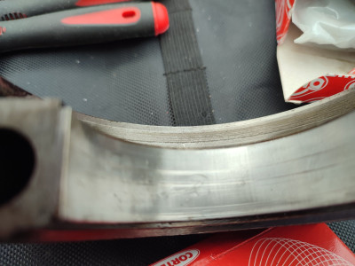

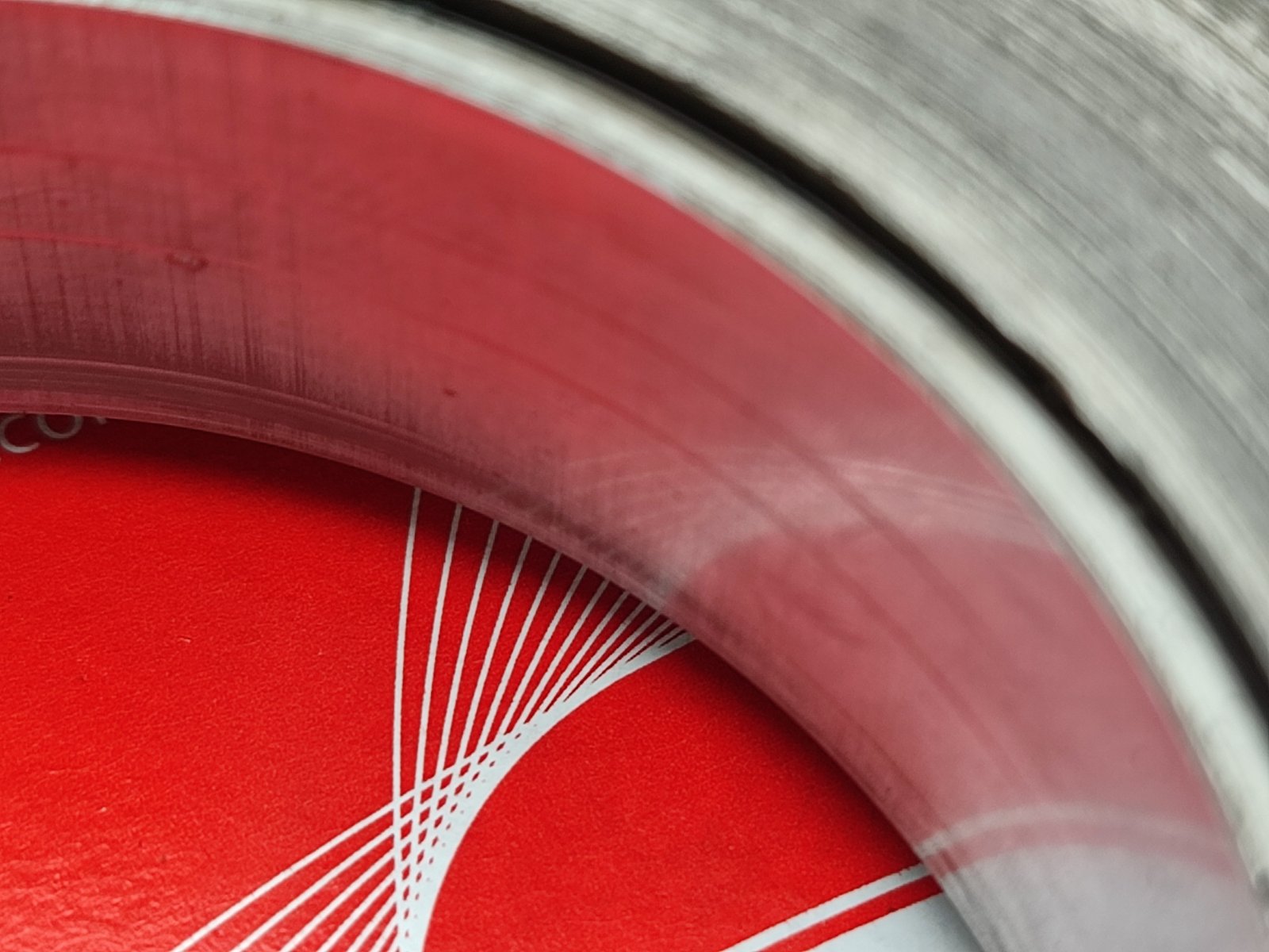

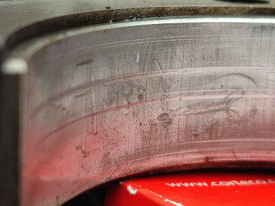

Hi All,
before I put this back together, Can anyone tell me if they think the bearings need replacing there is some very light scoring/scratches and discoloration? I also would like some advice on on the finish on the lobe of the crank. It's the really rough looking surface in the 4th and 5th pics it looks deliberate to me I imagine it is factory and is to aid distribution of oil in the Sump.
Plastigage and factory specs would be you friend here. Can you feel any roughness with a fingernail?
Had an engine builder have a look at these he said they are fine so a win I think.
