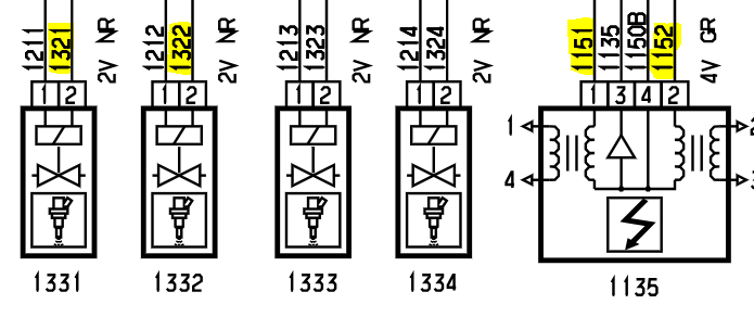

I have a query based on the diagram and associated indexed components if you don't mind:
Hopefully the image works. I've highlighted a number of items;
1321 & 1322 both relate to Diesel components, the car is a petrol
1151 & 1152 are not present in the Index list.
Any ideas?
TIA
Morgan

Re: C3 (2004) - Wiring diagram - Car won't start, multiple fault codes
1321: cylinder 1 (-) injector control
1322: cylinder 2 (-) injector control
1151: Lighting 1 command
1152: Lighting 2 command
No, we can't include wiring code descriptors are there will be thousands! I've only put up the main hardware components.
