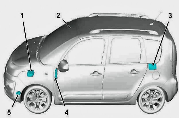

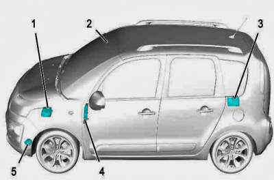

There shouldn't be any need to remove the bumper. You should be able to get access to is via the near side wheel arch after you have removed the wheel arch trim.
Horn is (5)
