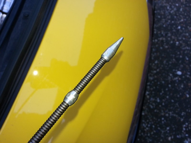

I always use a paper towel when checking the oil level, but the dipstick on my ds3 is kind of hard to read from. Anyway, I’m pretty sure the level is where it suppose to be now.
The dipstick looks like this one:
