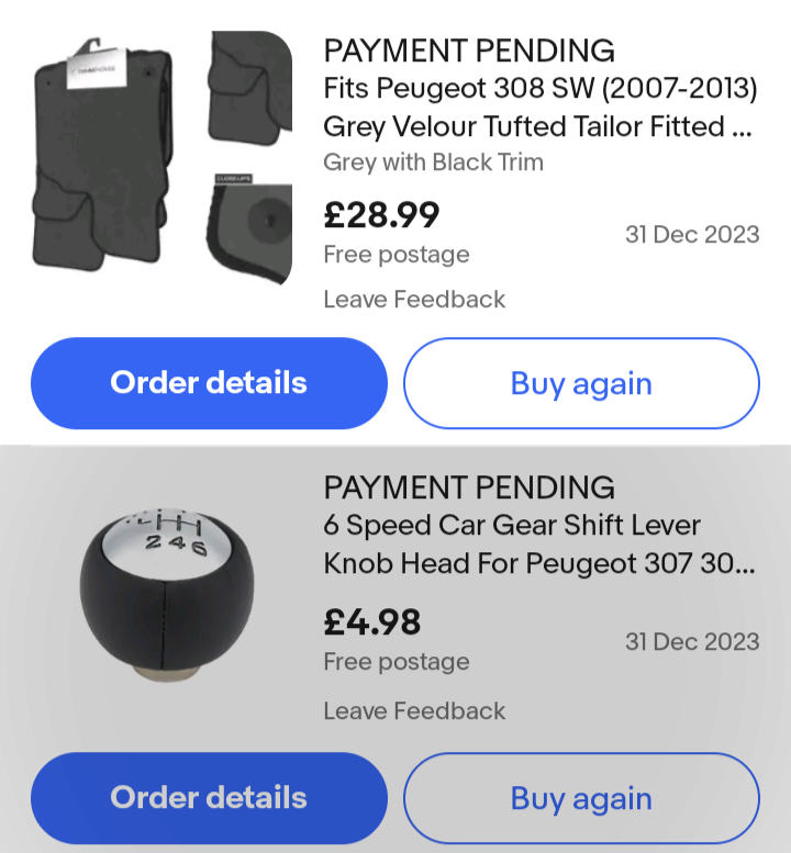

308's gearknob is quite worn, so less than £5 should sort this.
Has car mats in the back but none in front door well, have gone for grey to brighten it up a touch. Slightly posher than the "cheapest possible" choices (about £18 is as cheap as they go) so hoping are good.

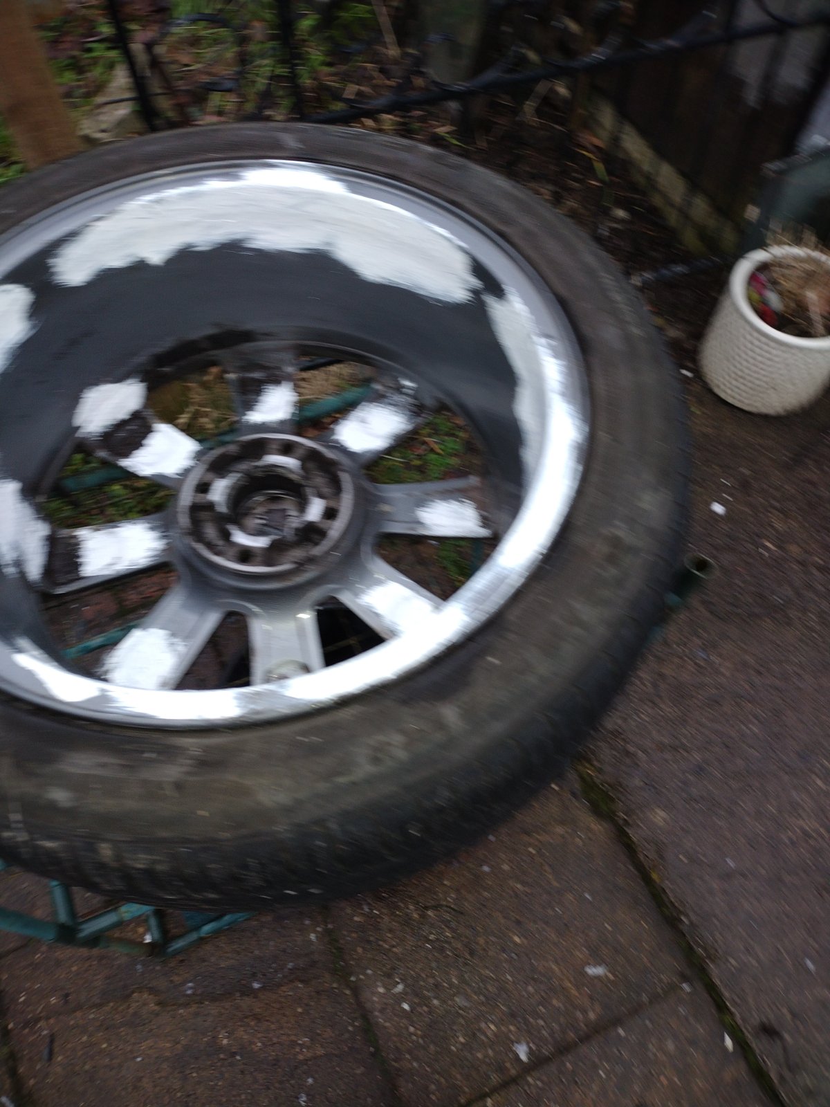

Had a quick look at front left wheel - as it clearly has a puncture (down to about 1 bar on the gauge) no obvious nails or damage to the tyre. The tyre itself is about two thirds worn and a presumably cheap "Winrun"
Lacquer is still present or was, but sat over a variable thickness of white aluminium oxide for a large area of the diamond cut faces.
The anthracite coloured paint is also lifting in many areas, strangely lots on the back too. This chipper off and some white paint brushed on for the moment. (Wow that's blurred!)

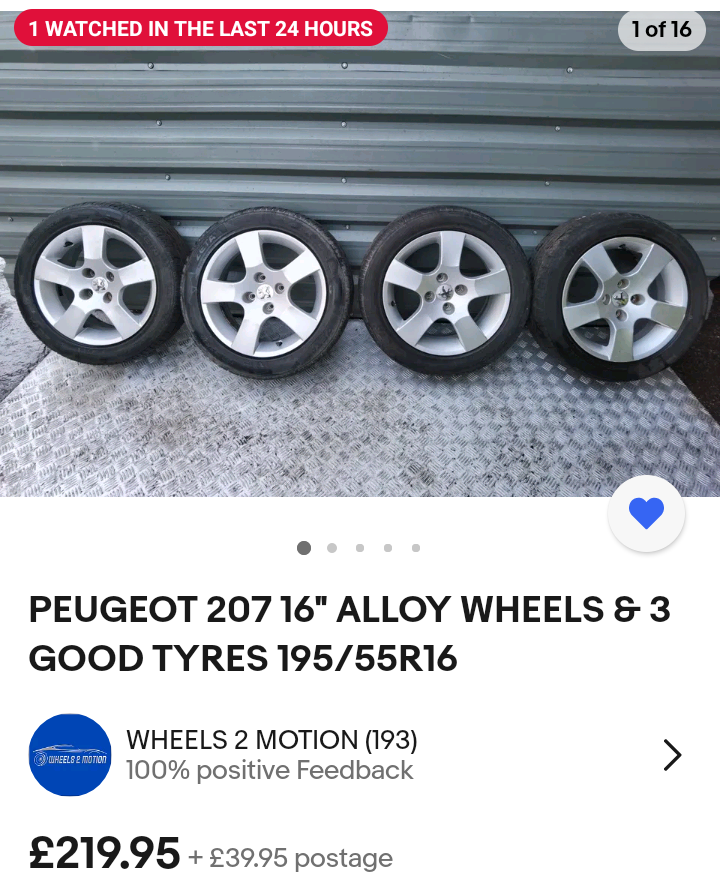

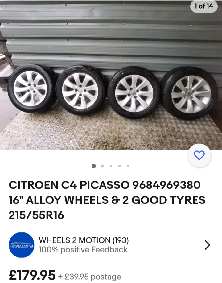

Currently exploring a set of wheels, down a size to 16" most likely, then can take the others off and sand down and repaint them at my leisure.
These: Or Seem good options.
Wheel bolts were very tight and bone dry. Thin smear of copper grease and done to 95 Nm. No locking nonsense thankfully!
(Online research now suggests this maybe should be 100 Nm)
