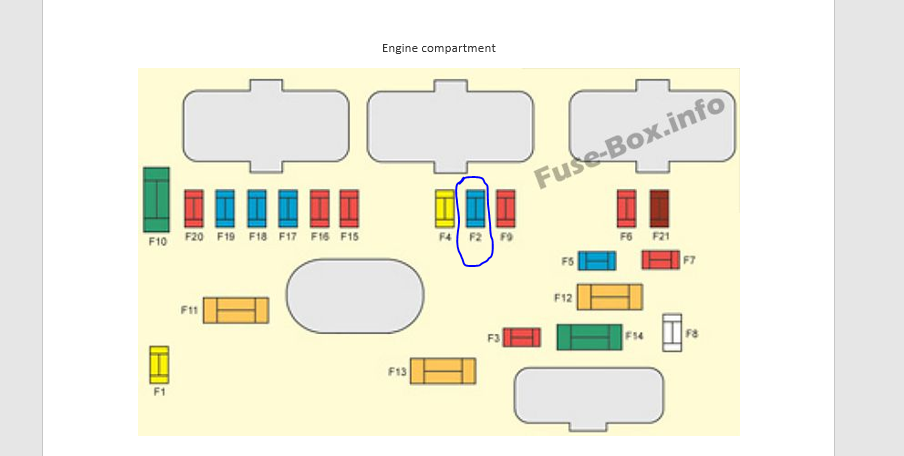

If your fuse box is definitely the same layout as in the image in your post then the horn fuse should be F2 which I've circled on the diagram. Note there is more than one layout of fuse box on the B9 Berlingo but as I stated if your fuse box is as you have indicated then F2 is correct in the position I have indicated. The fuse is 15A

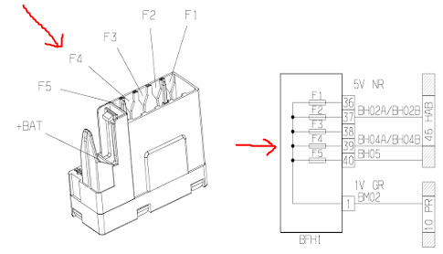

I would need your VIN to be 100% sure, but likely to be the 10A Fuse (F4) in the the cabin Fuse Box.

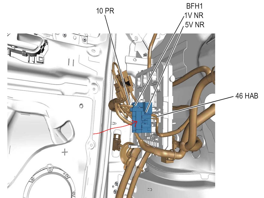

Yes, that's correct, here, where i have arrowed in red:
